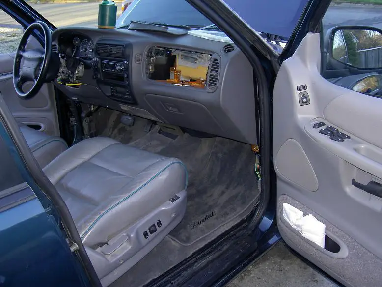

Yes, I have the 99 in my signature as a primary vehicle, trans out now, and my 98 Limited like GLOCKer's I use temporarily. I only removed the back seats in it, the rest is stock. My 99 I installed switches for things like turn signals, strobe lights, and right side window control. I'm one of two carriers here to still use a left hand drive vehicle, the other is a very large/tall man who is a substitute. Everyone else has paid $1000-$1200 for RHD conversions for theirs.

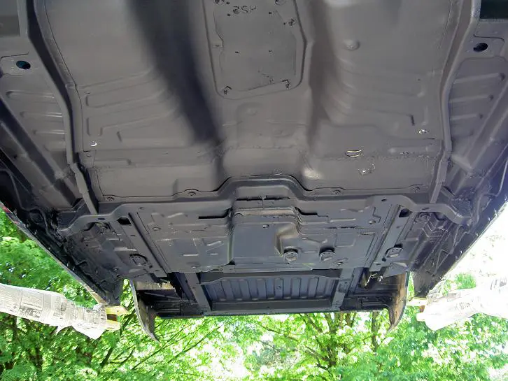

I have the thread linked in my signature, but these are the main pictures showing the biggest steps I made. The switches on my right door panel and in the airbag pocket, clipped the 93 body to use the 99 front clip and firewall, the OEM ARC air shock system wired in, and the underside painted and undercoated. I got almost everything the way I wanted it, hadn't planned to make it 302/AWD then, and the idea of a cooled driver's seat cover might not happen.
