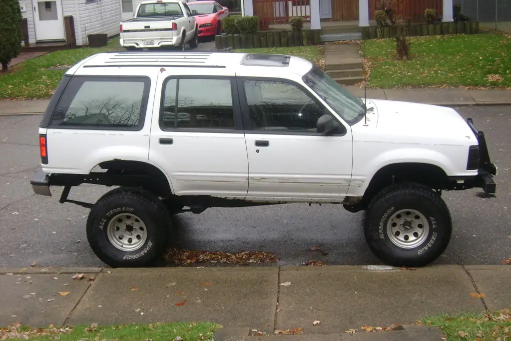

Lifted!
Ok, might as well throw a pic of her how she sits right now....
May not be quote-unquote driveable at this point, but lifted is lifted, right? :D

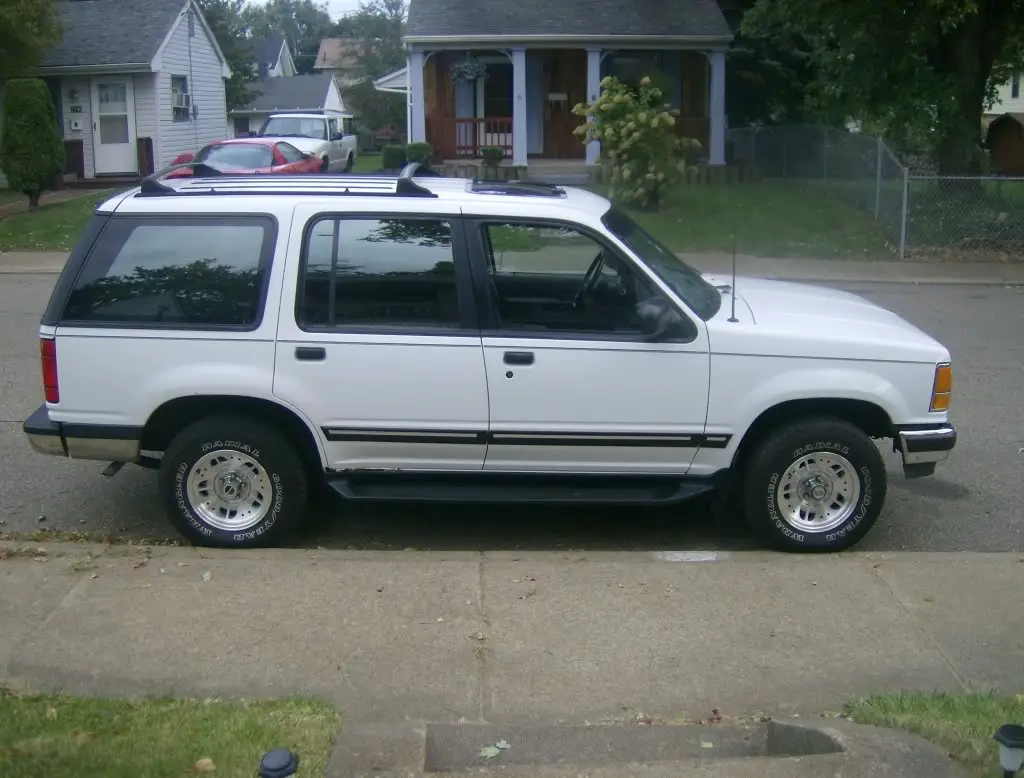

Hello....
Hello Baddecision93 I see your from Orrville. Im from Canton, I got bit by the X bug a few years ago too....lol This is a pic of how I got it
And a pic of how it looks today before paint
I just took this pic tonight, not a very good one but its after it was painted
Your X is looking good keep it going....

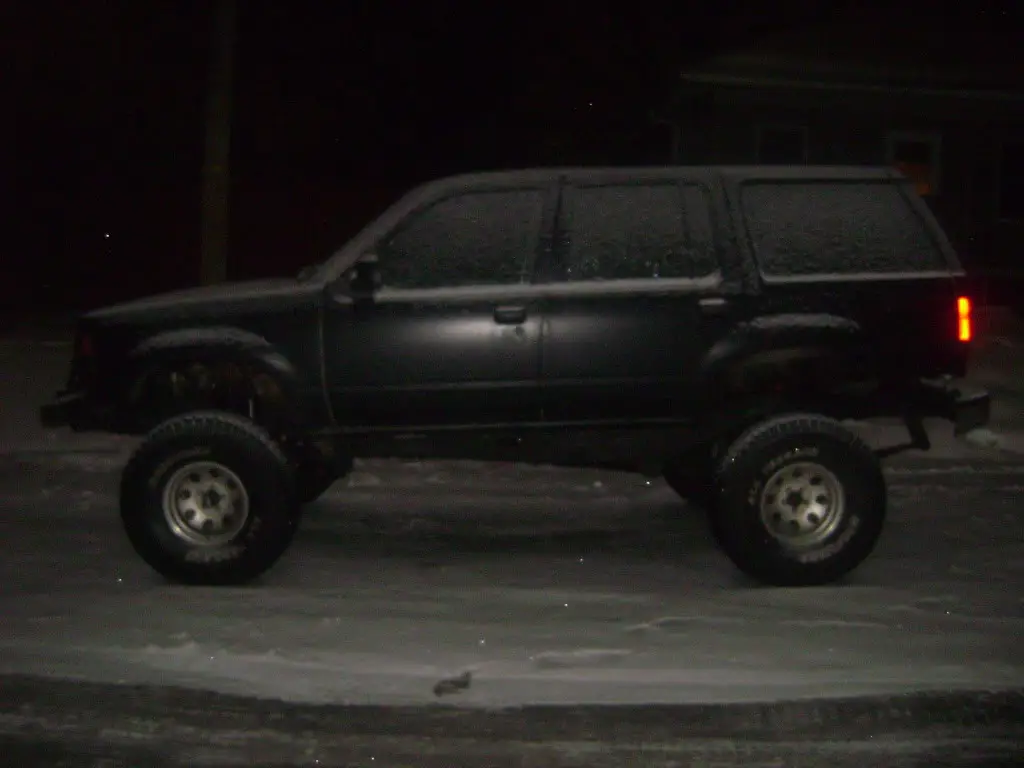

94whitex
is that flat black paint or bed liner material?? looks good!
Sorry posted the same pic 2 times....first time I got pics to post...I'll try this again.
Looks good! Now you'll have to change your screenname since you don't have a white ex anymore!
