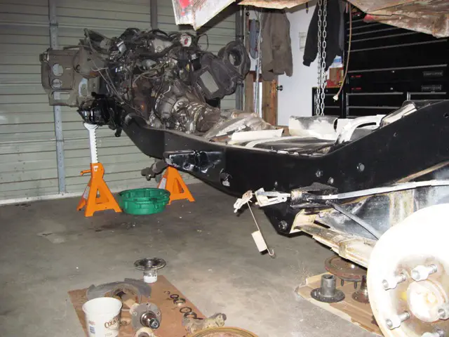

I have the front end off the X and I have, on hand, all the parts for rebuilding everything outside of the carrier housing and installing 5.5" of lift. This chassis is going under my 1950 F-1 truck body. I do not know what size tires I will end up going with untill I mock up the body. Once I know my tire size I will pick my gerar ratio and maybe a locker...
I really hate rework!
What I am hoping for is feedback on whether or not I should go ahead and replace the seals and bearings on the carrier housing or wait till I am going to do the re-gearing???
Will the entire axle arm have to come back off to do any of those seals/bearings or the re-gearing if I wait to do it later?
The lift package and other parts have all but busted my budget for this quarter. If the carrier seals and bearings don't have to be done with the axle arm removed, I would rather use the money I have left to buy new spindles and brakes so I can roll the chassis in and out of the garage for other work like the SOA conversion...
Thanks, in advance, for your inputs/wisdom!

The axle has to be pretty much completely disassembled to regear it, so I would probably wait on doing seals and stuff (you'd be chancing damage to them as well when you go to take it apart the next time).
Once you have it apart again, all the seals will be right there, just pop 'em out and replace them.
