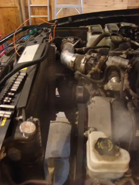

First you will need to remove the belt driven fan and shroud. It takes a very large wrench and a spanner to hold the pulley from turning. I made the tools that I used but you can rent them from local parts stores.
Look at all that space!

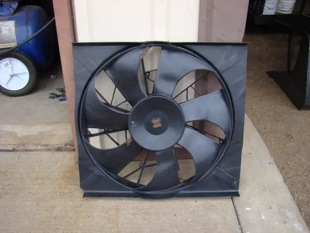

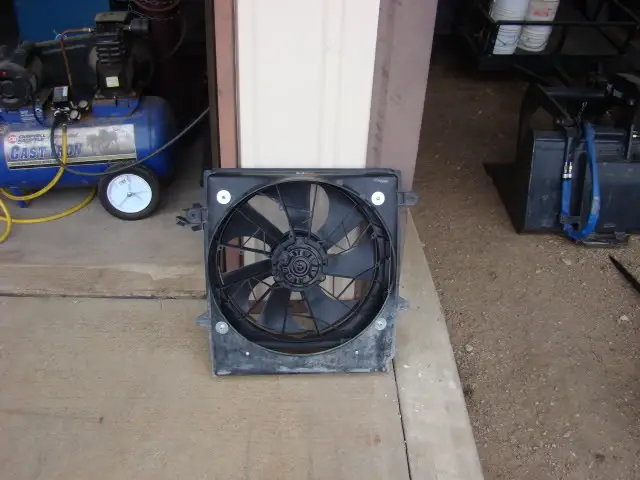

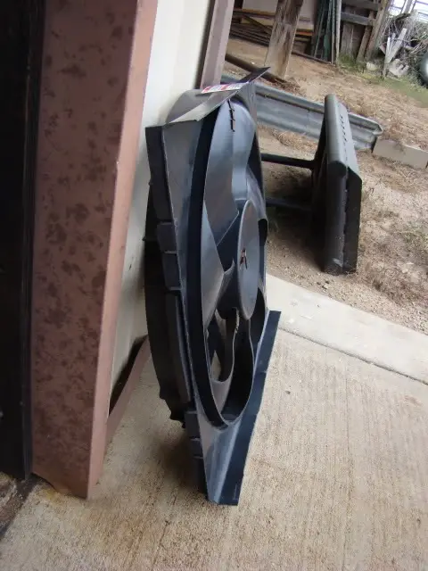

Next you will need to trim the shroud to fit it inside the stock shroud. I ended up taking about 1/2" off the depth of the shroud and about 3/4" off the end to be able to set the fan in the stock shroud.
The trimmed fan:

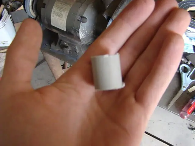

I made the spacers out of 1/2" PVC pipe to space the fan foward to clear the water pump. The spacer ended up being about 1 1/4" but could be different depending on the amount of clearance you want.

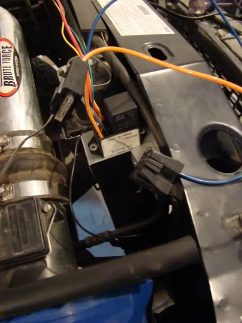

I mounted the fan controller next to the radiator on a piece of aluminum sheeting cut and bent to fit three bolts close by. The fan controller I used was cheap but I have heard decent things about it. It is a Hayden PN 3647 available at places like O'reillys and such. It is adjustable from 90 degrees to 210. The best part is it was like $35.

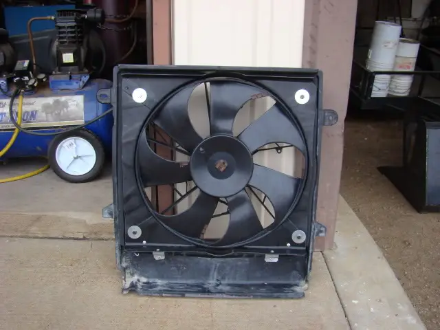

After I mounted the fan in the back of the shroud I got to work on all the wiring. The space around the fan has been sealed as well as I can with foam tape to make the fan move as much air as possible. The pieces of tin riveted at the bottom help to stiffen and hold the fan to the stock shroud.
The fan mounting (note the offset mounting this helps with water pump clearance):

For those using the Hayden controller. It does not have enough capacity to run the fan out right. You will need to put in a relay operated by the controller to allow enough juice to get to the fan. This is the website that I used to design my own wiring harness. At this site, he does a very good job of explaining the need for a diode when using an electric fan.

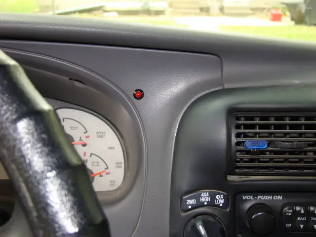

LED to let me know if the fan is running

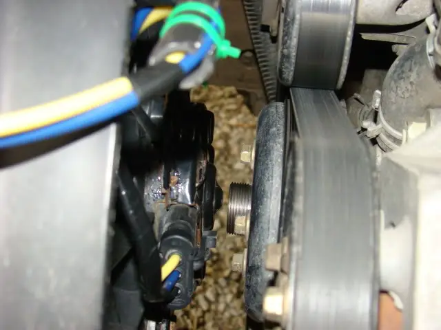

The fan clearance (it is a little farther than it looks there is 1/4" to 3/8" between the two in a straight line; however the nub on the back of the fan is completely about the threaded snout of the water pump.):

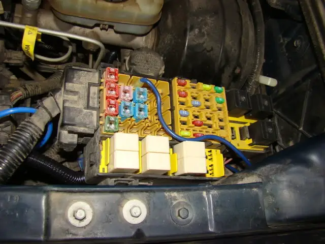

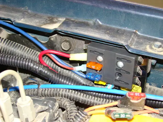

My Fuse block providing power to the fan:
How I tapped power for the fuse block:
The trimmed fan:
