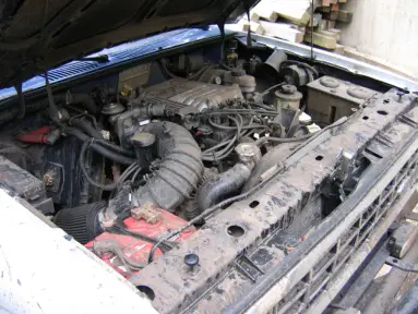

Your truck is so pristine under the hood. Compare it to mine in post #24...
Before:
After 2 cans of Gunk Foamy Engine Brite and careful spraying with medium/low pressure:

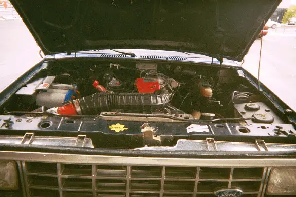

o ya ! it fit good ! i love it ! good and snappy on take off now to ! and this is a pic i took of the lift of the pvc off the intake...
Na it should, it did on my BII which is the same hood clearance as a gen I.
You guys see that intake tube pctured? that sucker is from a 90's something Aerostar 4.0L. this is the intake tube you want :) it works great, you can have the filter behind the headlight OR by the power dist box like the early 4.0L OHV was (up to 95) I ditched my PVC setup for this tube, much better fit and it has no restrictions in it.
