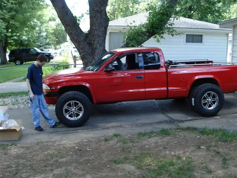

And then it got a 3" body lift a little torsion twist and some lift blocks, here it is right after the brown truck dropped his 33's off.

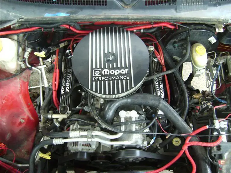

And a new air cleaner and valve covers

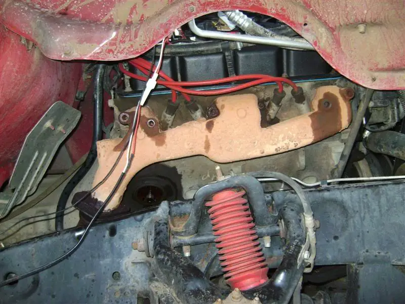

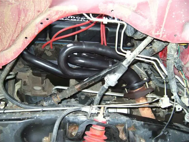

Some headers to help it breath from the other end
before
after

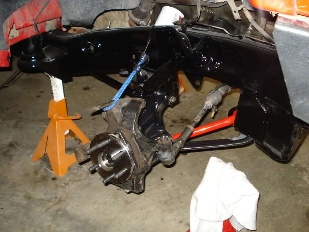

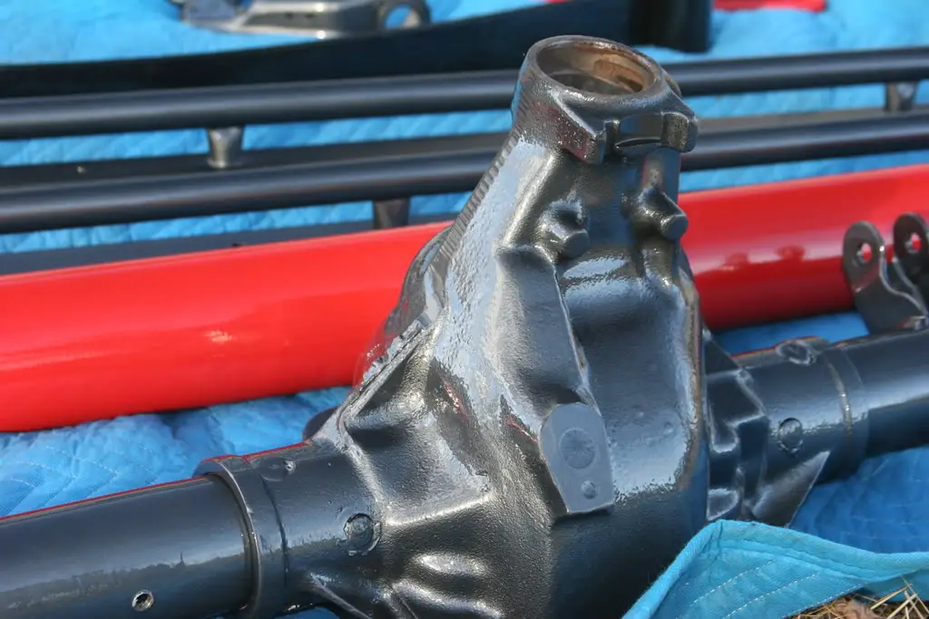

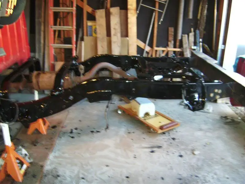

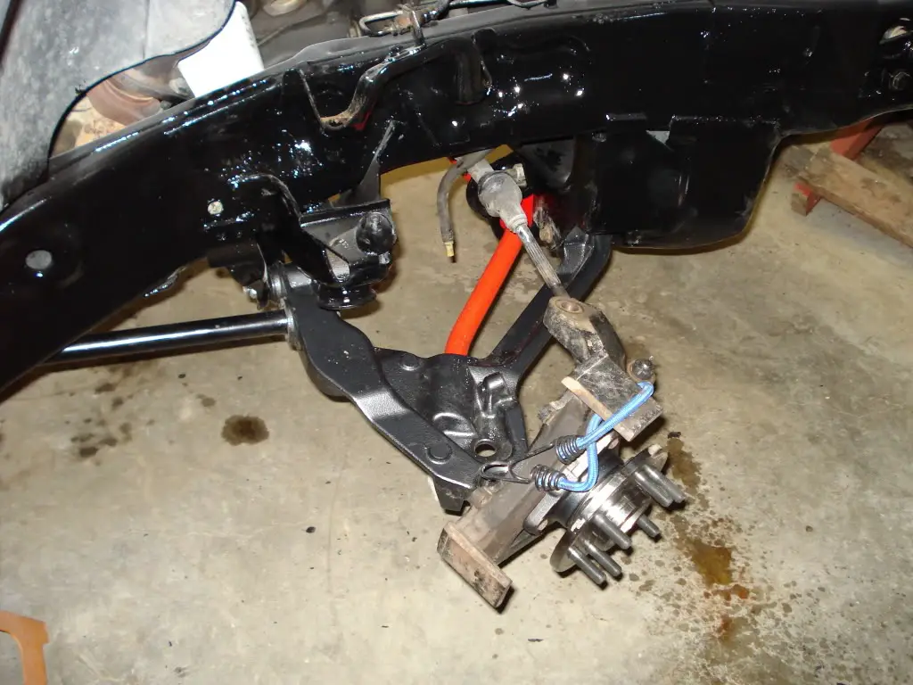

Not long after that it was time for some serious clean up. With our grandparents out of town for the winter he took over their garage (and most of the living room:D.) It was time to por15 the frame, install a 3" rancho suspension lift kit, and some 4.10 gears with a rear locker.

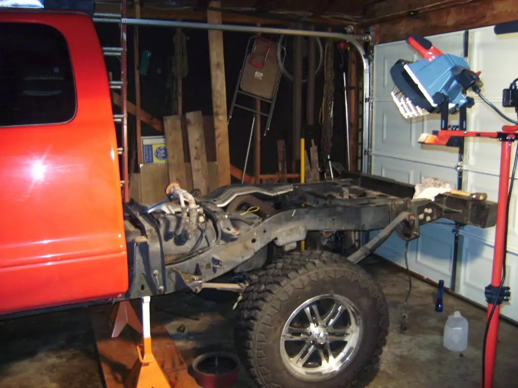

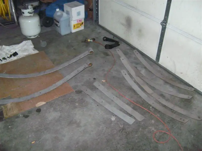

Lets get that bed out of the way

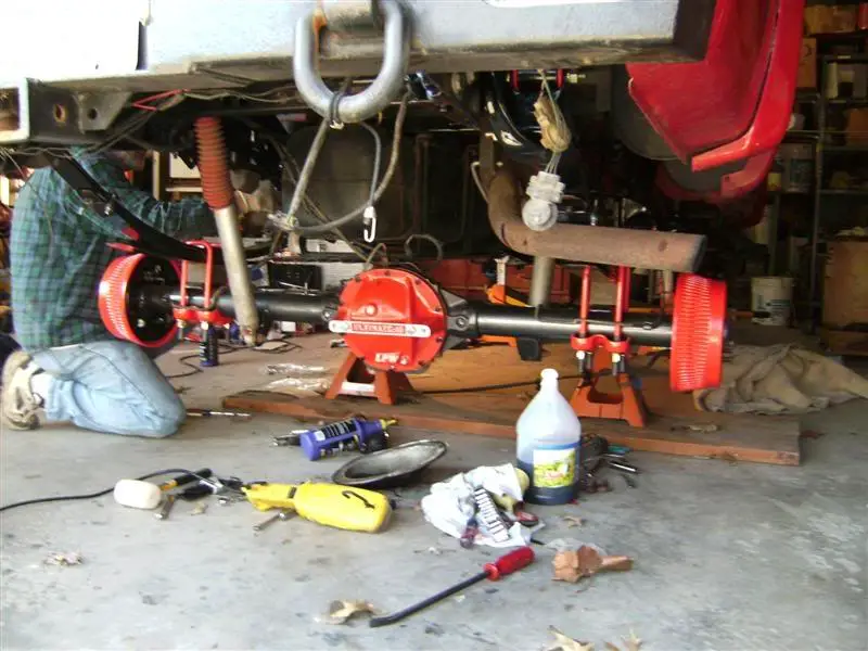

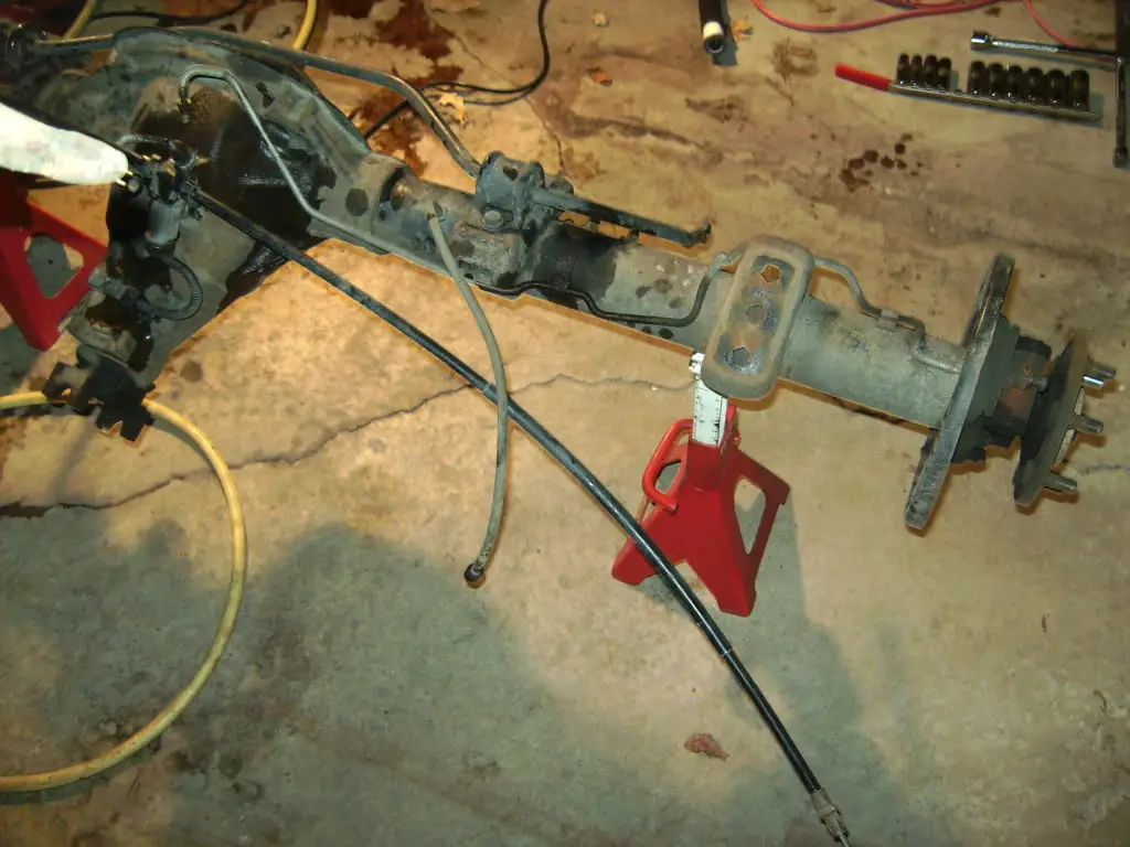

and the rear axle while we're at it

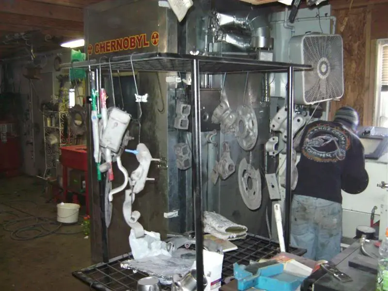

Hey you know while this thing is stripped down to nothing we should go visit Turdle for a couple of days and really make this thing look good.:D
getting some parts prepped
The amazing results

After we got back from a long couple of days at Jons and with my mountaineer stuffed full of parts it was time to start putting it back together. Unfortunately the lift kit wasn't going to work without a lot of major modification since it was built for a newer dakota with a slightly different suspension setup:( Oh well at least it's going to look a lot better and the gears and locker will help out a lot.
The por15 was on the frame
parts going back on

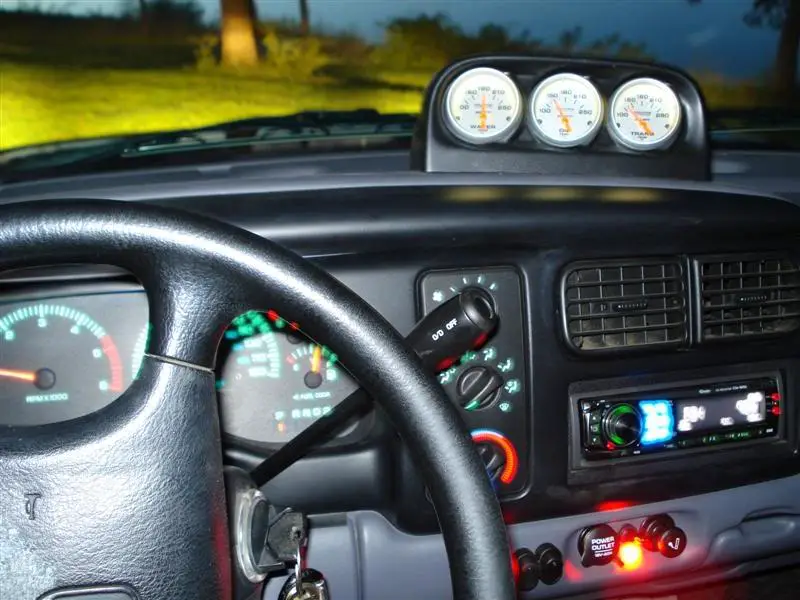

Needed some gauge pods to keep an eye on all of those temps, especially the transmission, even with a couple of extra coolers and fans.

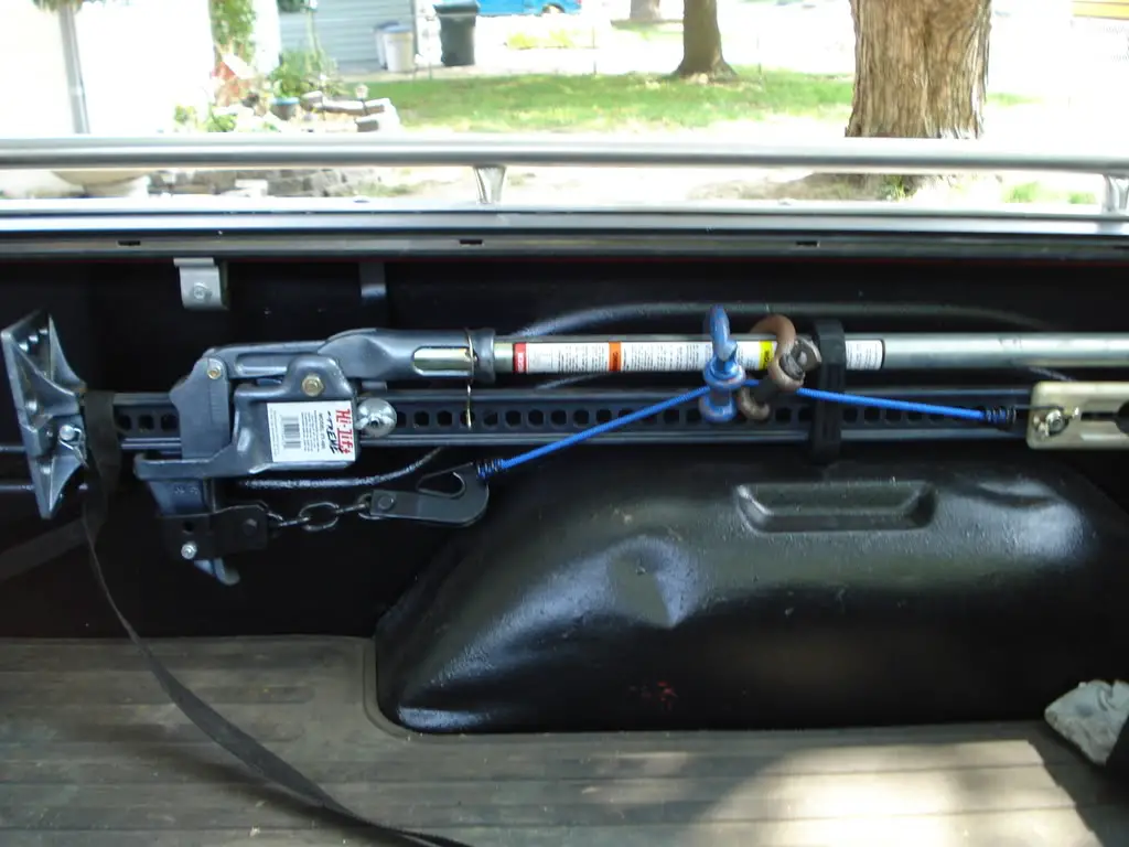

can't forget the hi-lift either

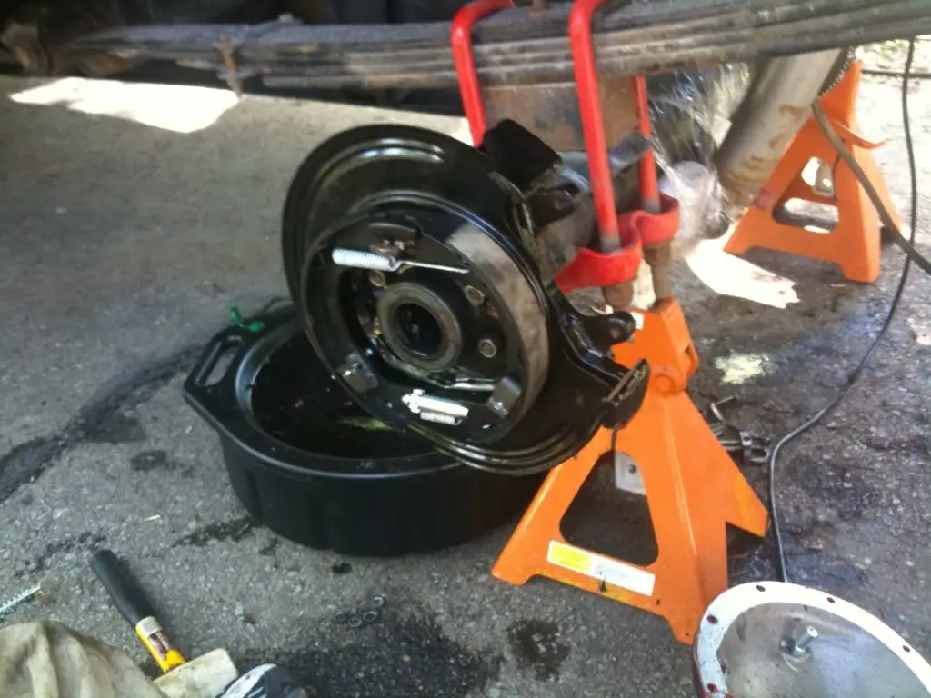

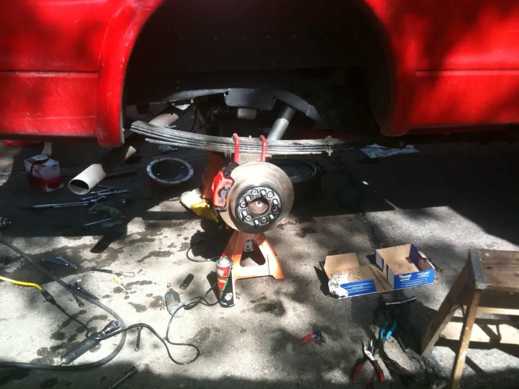

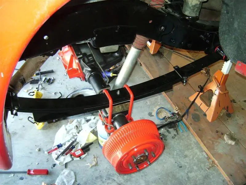

Then it was finally time to put a little explorer on this thing, with some rear disc brakes from a 2nd gen. The backing plate, calipers and rotors all pretty much bolted right up to his chrysler 8.25, with the exception of drilling out the rotors to a 6x4.5 pattern.
Good bye drums
and hello discs

Yeah every thing else was powder coated so why not, it was also about a year or so before he finally got around to swapping over to the discs.
I wasn't totally positive at the time the disc brake swap would work. Two of the holes overlapped, so I had Turdle do the drums while we were there.
