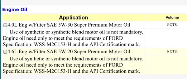

Are there certain brands or types of fluids you prefer? The owners manual does not say so how many quarts of oil does the engine take? I have a rear end leak so what type of fluid do you suggest for it?

The 4.6l takes 6 qts of oil.
