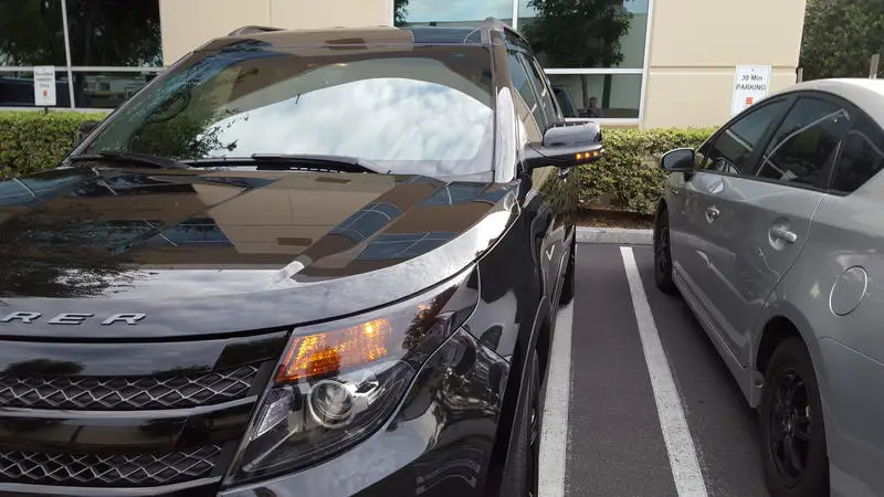

Have you read post 51? There are also many posts in the 'DRL' thread that talk about it.I'm still trying to find a way to make my blinker yellow/amber lights my DRL. I think the yellow lights will look very cool with my black plates with yellow letters. I have seen the raptor and also the Toyota tundra with the yellow/amber lights for DRL'S. anybody have any tips that can point me in the right direction?

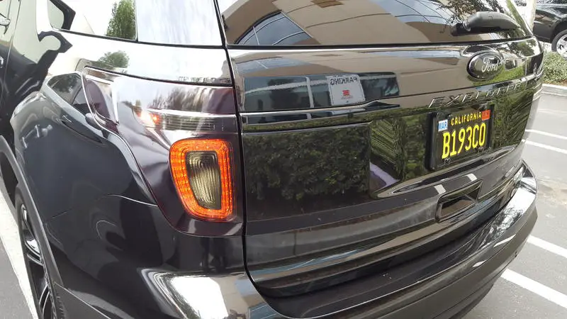

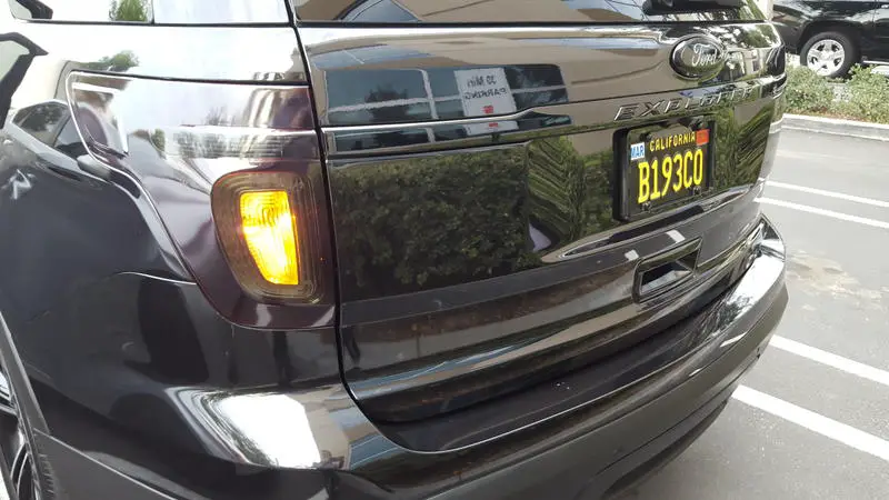

Dealer never does parking lights. DRL's on all Canada's and US fleet Explorers are blinkers standard!
I don't have my Explorer any more in order to confirm this, but aren't the parking and turn signals one in the same? The Owner's Manual shows; Front park/turn lamp, qty 2.
Peter
For the front lights yes parking and turn are on the same bulb but the blinker in the side mirrors (amber) are only blinkers and the tail lights parking are red and blinker is amber not the same bulb.

Yes I'm trying to set just turn signals as DRL
A good example is when I push the lock button on my remote only the blinkers flash on and off. Same with Hazard lights.

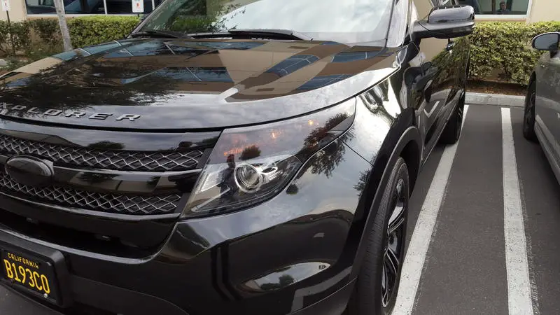

Hey Surreal, did you black out your front Ford badge? If so, I like the look.
How'd you do it?
