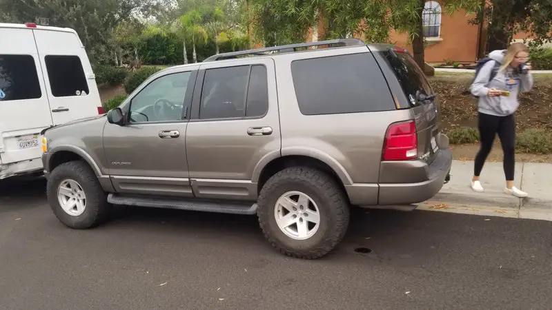

I just finished quicklift all the way around and front upper control arms. I got the lifetime alignment and apparently it was needed.

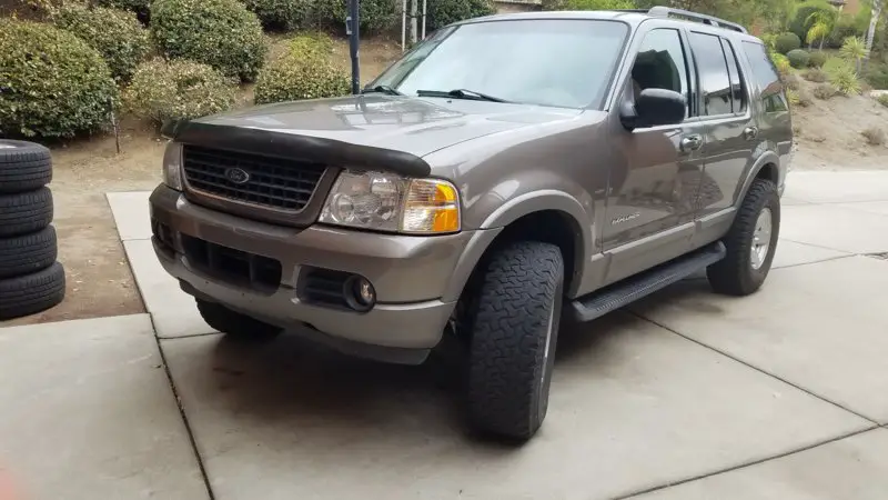

Regarding tires I fit 285x75 R 16 with out spacers. With spacers the 285x75R16 hits the step. It is too far outside and I also trimmed the front bumper.
Three pictures are with Quicklift and 285x75R16 plus 1.5“ spacers.

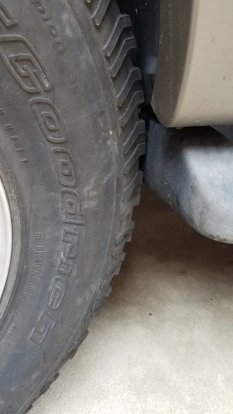

Final picture is Quicklift with 285x75R16 and no spacer, wheel turned and clearing step.

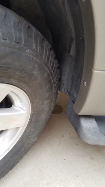

285x75R16 with 1.5“ spacer wheel turned and hitting with Quicklift

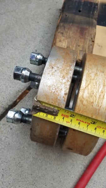

1.5“ wheel spacer
285x75R16 with 1.5“ spacers and Quicklift, Tire hits Running Board and inner fender
285x75R16 no wheel spacers Quicklifts clears and barely rubs at lock.
Side view 285x75R16 Quicklifts
