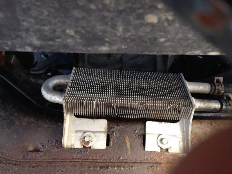

First we have this little beauty, mounted to the frame right behind the bumper, easily visible by getting down and looking, this is the Power Steering Cooler, about 12 inches long...

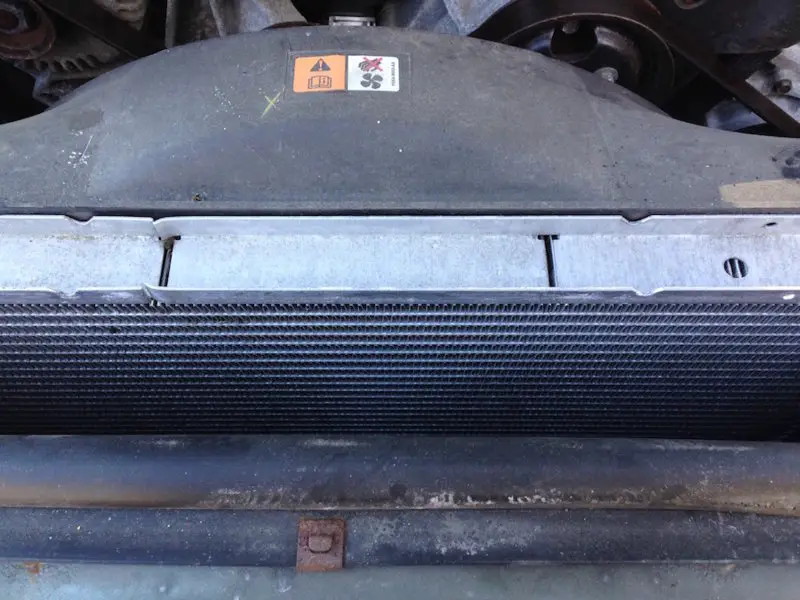

Next, if we open the hood and remove the 2 black plastic shrouds that run about 30 inches from side to side (they just pull off) we see the radiator (front of vehicle is bottom of photo).

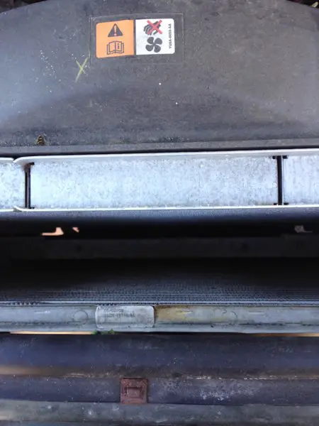

Looking down in we see the AC condensor with the paper tag in the front (Googling the number on the tag brought up the info for the condensor) and...

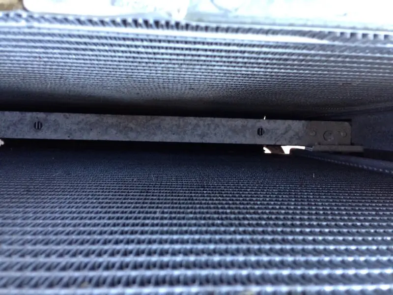

...between the two, down in the bottom is the Tranny cooler.

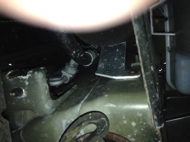

Here's the hoses from the tranny entering the cooler, this is from under the truck, starboard side, looking up.
