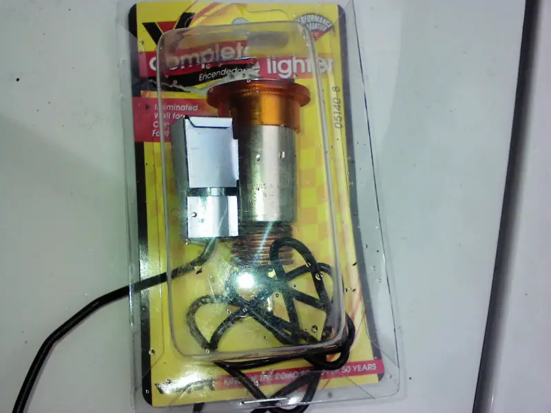

Well the PO used the lighter so much he wore out the hole for it to the point it was oversized & lighter fell into Dash - Found Aftermarket Lighter with larger Flange - Bezel Assembly slides out after pulling 2 7MM head screws under Radio.

Thanks, that's great to hear it can be fixed. The plastic there is not very strong and I guess it's easy to wear it out.
Same problem here.... fixed by adding O-ring inserted into flange. A little concerned about heat from the lighter, but plastic bezel would not seem much more heat resistant than O-ring. My guess is that the heat deteriorates the bezel....
Others have redone with fiberglass.
No problems here since the O-ring, but I like your repair better.
Well done.
Yeah I tried O Ring first too & it failed - My thought was to use the "reflective ring" on new Liter as reinforcing washer but I wd hv had to thin the Bezel to get it to fit - Thankfully the Liter guts for reflective Ring has bigger flange so it fit well.
Well done,
I tried to find oversized lighter assembly first, but could not find one.
You got it.
Looks good! Easier than replacing the whole assembly.
