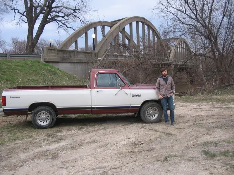

Anyway, here is where she sits now. We have to name the ol gal so she wants to drive around again.
Side dirty
interior dirty.
Ok, we will make sense of this, but it's just a truck remember. Some easy off oven cleaner and a good power washing will do a good deal toward shining it up again
The headers are going to have to rust thru
if they do we will deal with it then, as, sealing these up was a mother beeshusdz
ok flame on. It's an old truck, and a 4th generation of my family will be driving it for a while.
