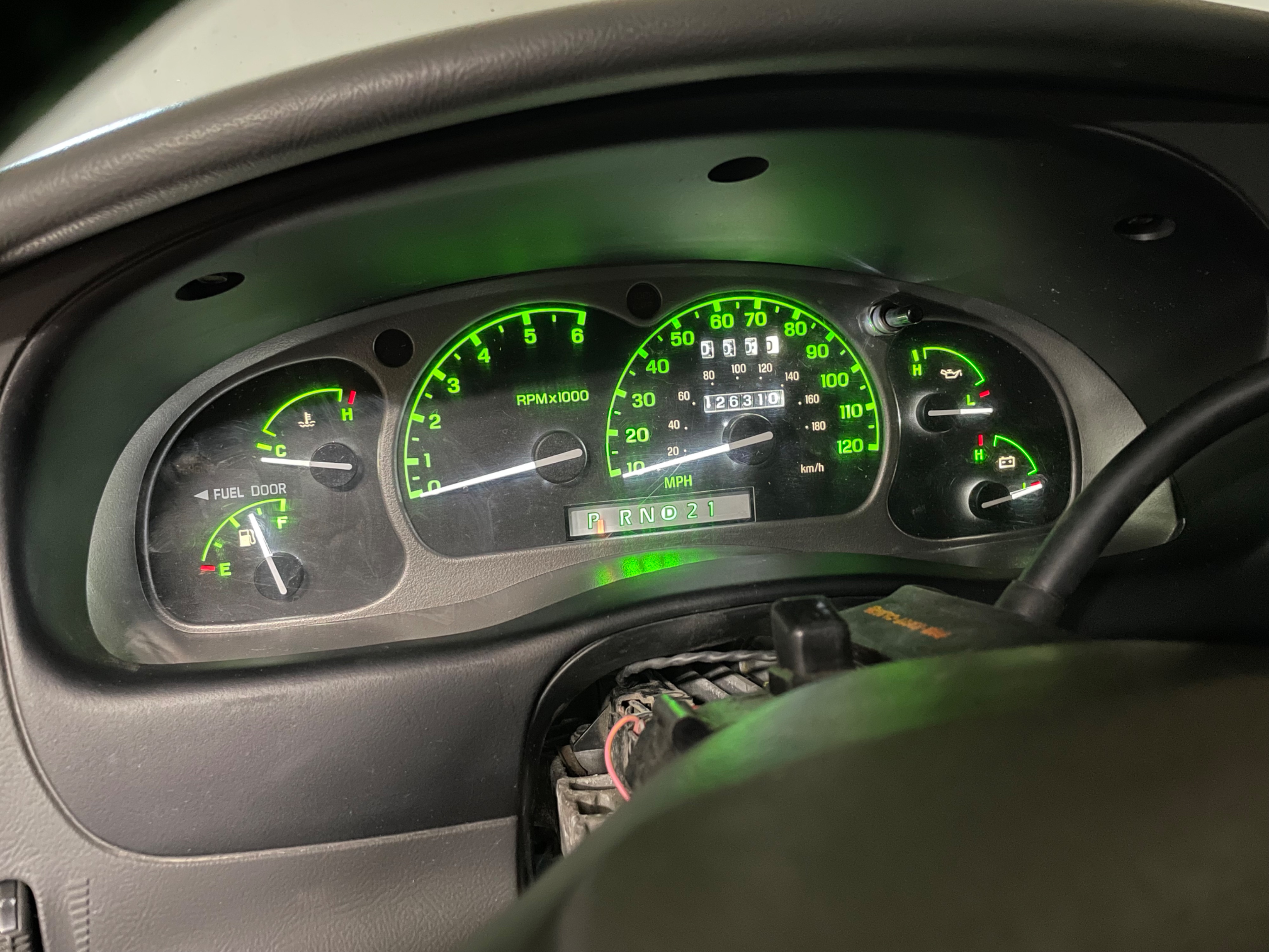

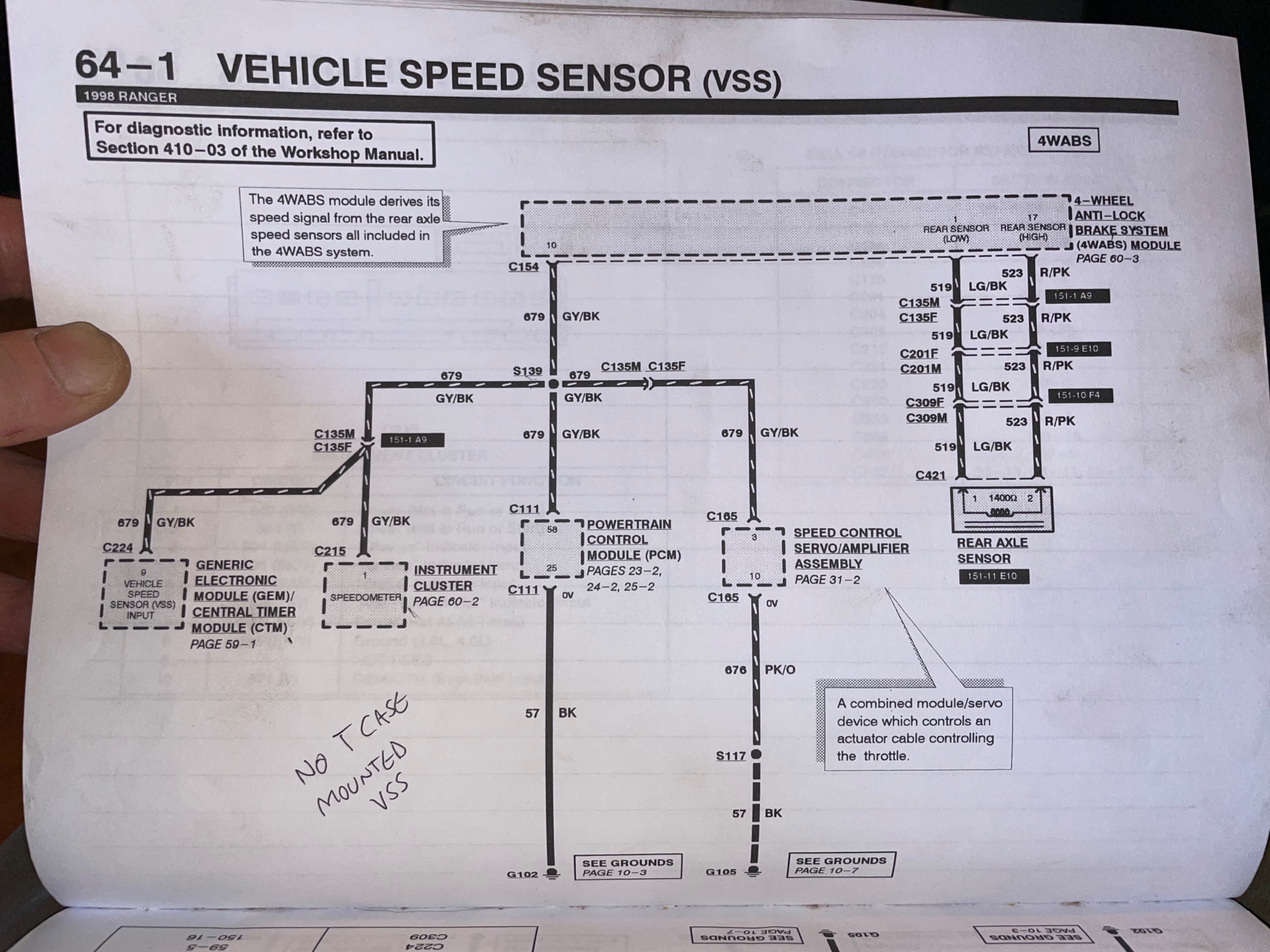

The speedometer is acting funky
Well I know why!
2003 the pcm takes the oss sensor and generates the speedo output for the dash and others
1998 ranger the abs module takes the vss signal from the rear axle and generates the speedo output for the dash and others
I had both the pcm and the abs module hooked up… confusing things
After I varified all connections I simply snipped the wire coming out of the abs pump and now my pcm is handling the circuit 679 grey w black speedo output signal to speedometer cruise control and 4wd shift
The abs module is on the chopping block
I will delete abs from this truck (personal preference) and probably end up installing a different master and a disc brake 31 spline rear axle
98 ranger speed sensor
2005 ranger speed sensor

Yes this ranger is 4wabs
Some rangers are rabs only… but this one has 4 wheel pump. The book also shows the speed sensor signal for the RABS trucks too

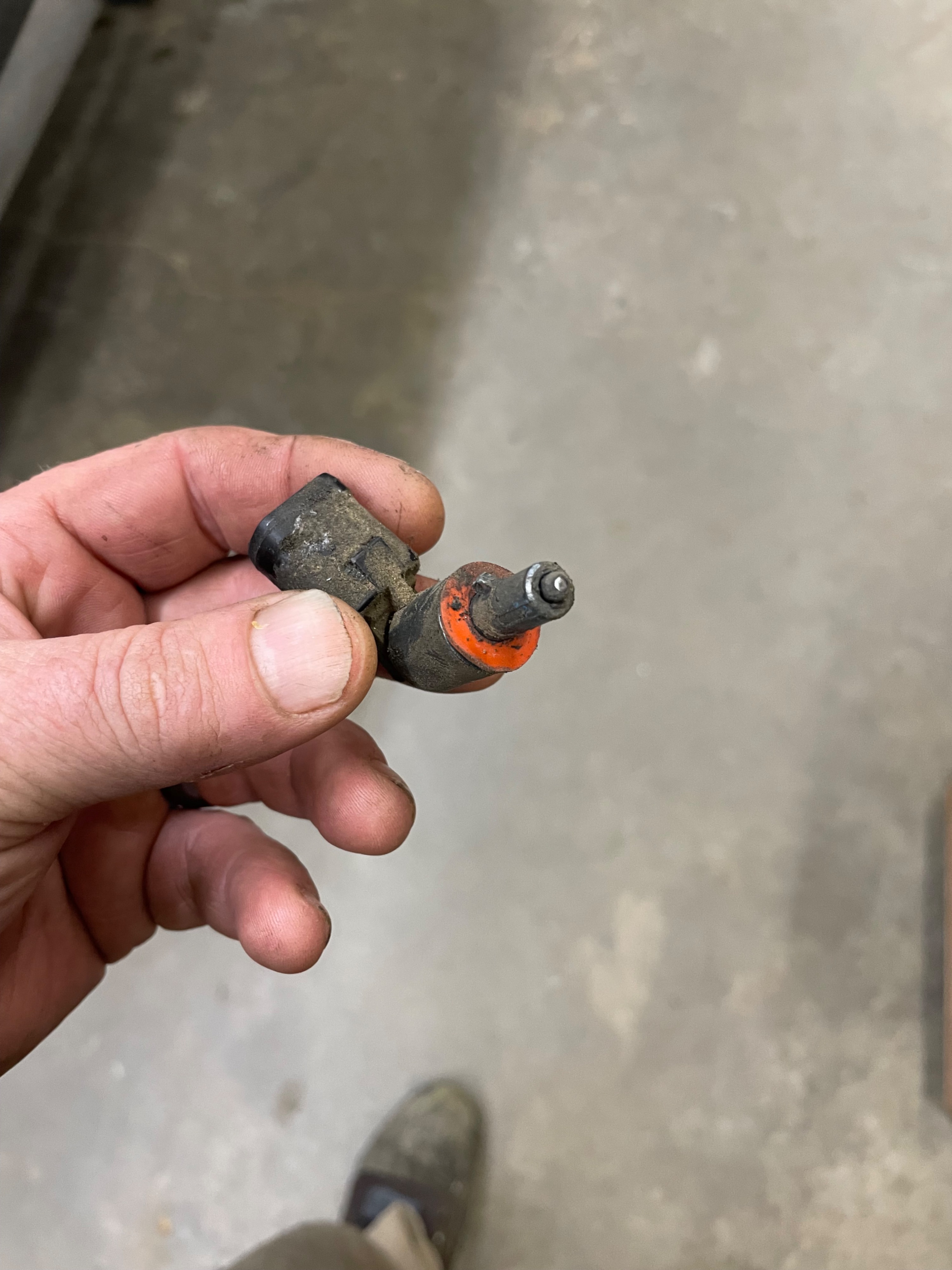

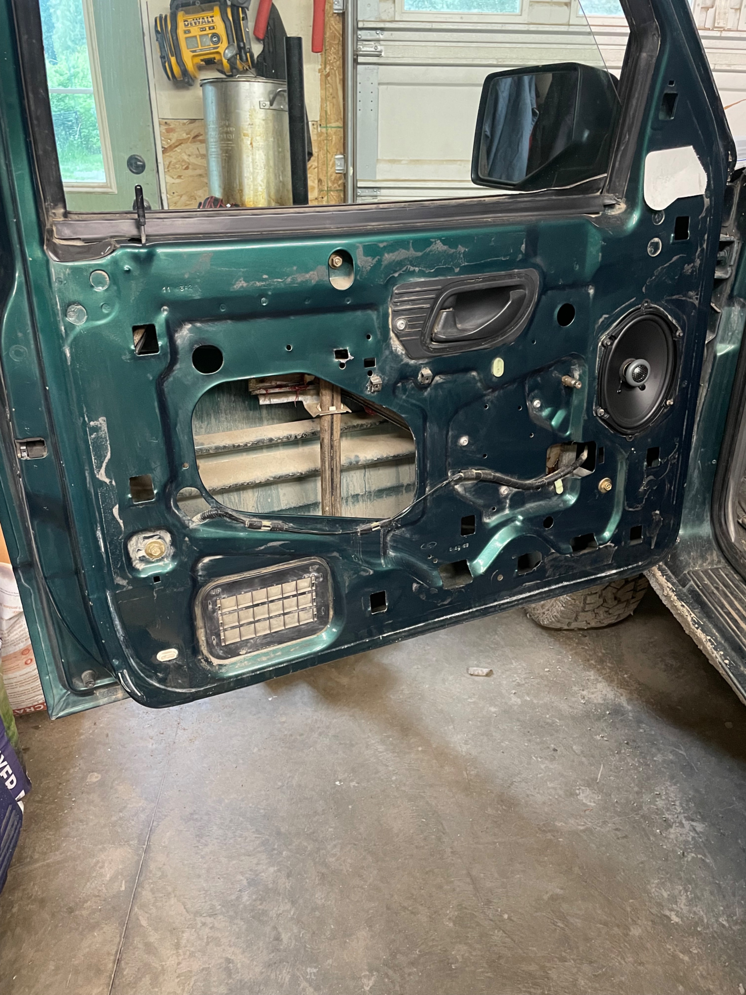

Here’s how you fix a door ajar light in a ranger or explorer
Door panel removed

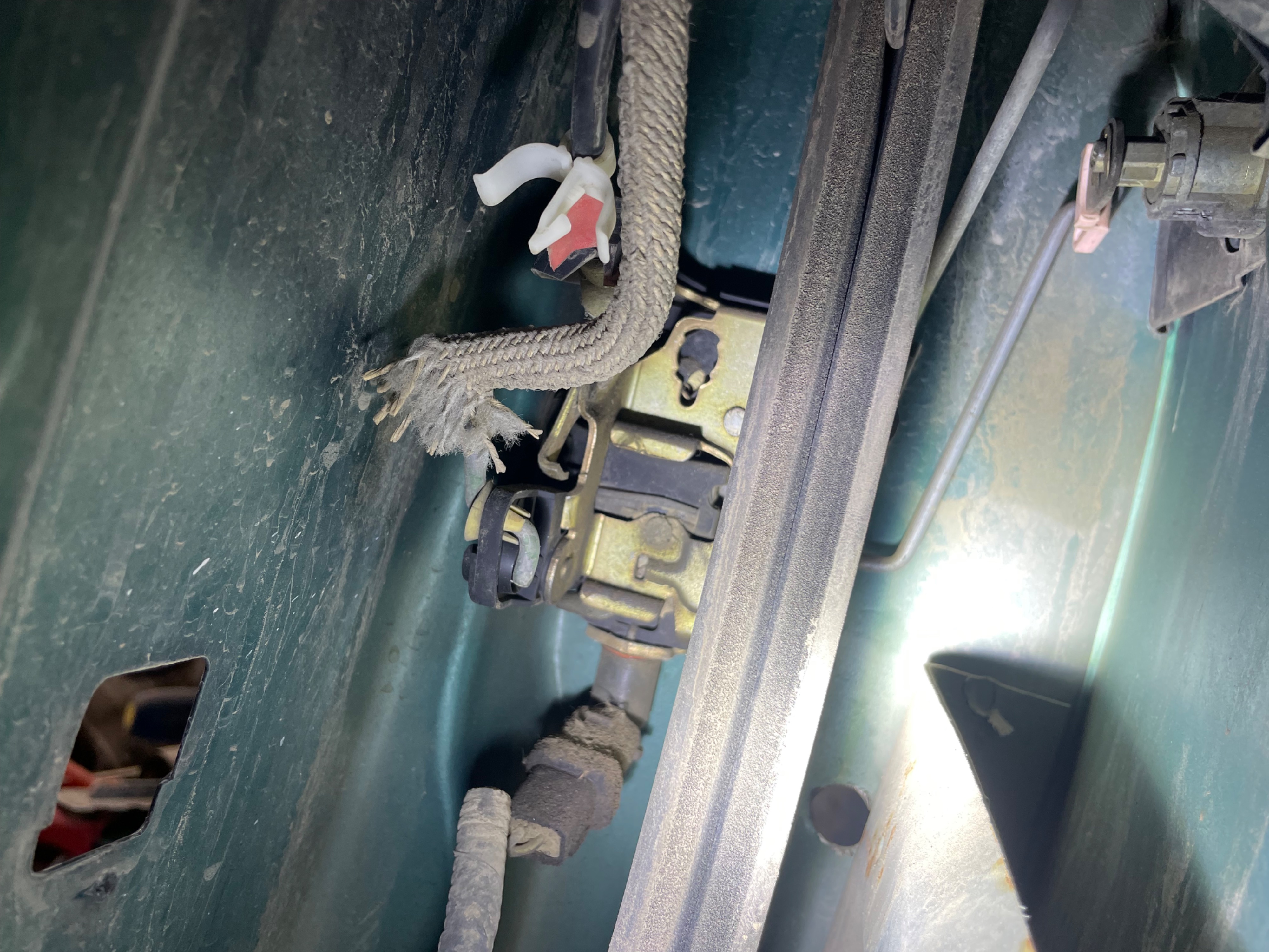

Took picture of drivers door lock assembly
See how dirty things are?
The little door ajar / drivers door master switch it located on the bottom of this assembly. It twists to come out of its mount: you can’t twist it far enough to release without first removing the 3 screws that hold assembly to door
Once it’s loose you can twist the switch 180 degrees as it comes out
The end of this switch is so dirty that it has lost its spring… it’s a spring loaded metal stud. So with a small pick some carb cleaner a rag and some pb
Blaster it’s all clean again. After initial
Cleaning I pb blaster it and with inside down I press the button about 50000 times
Clean now and has its “spring back”
Sure enough no more door ajar light

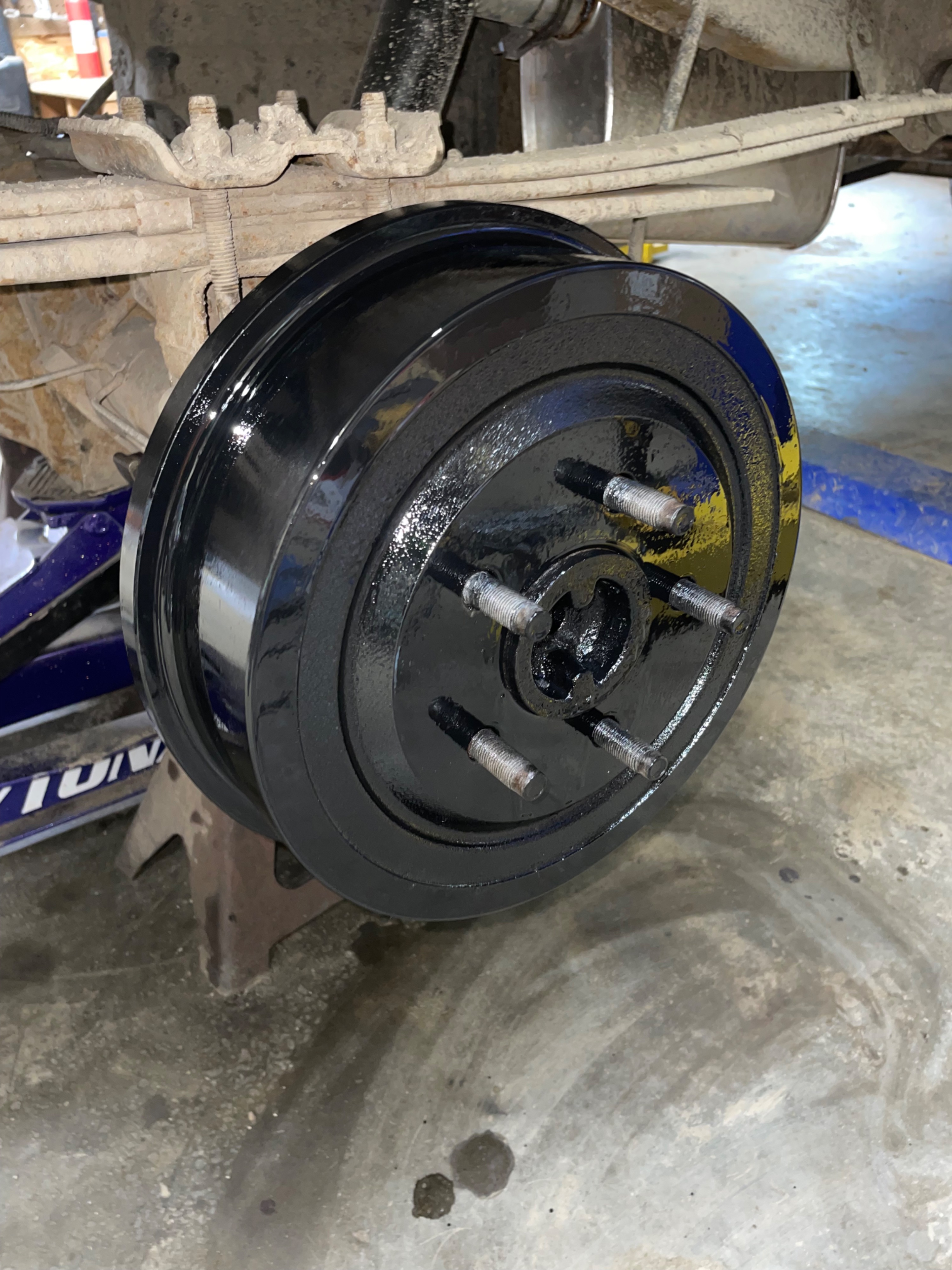

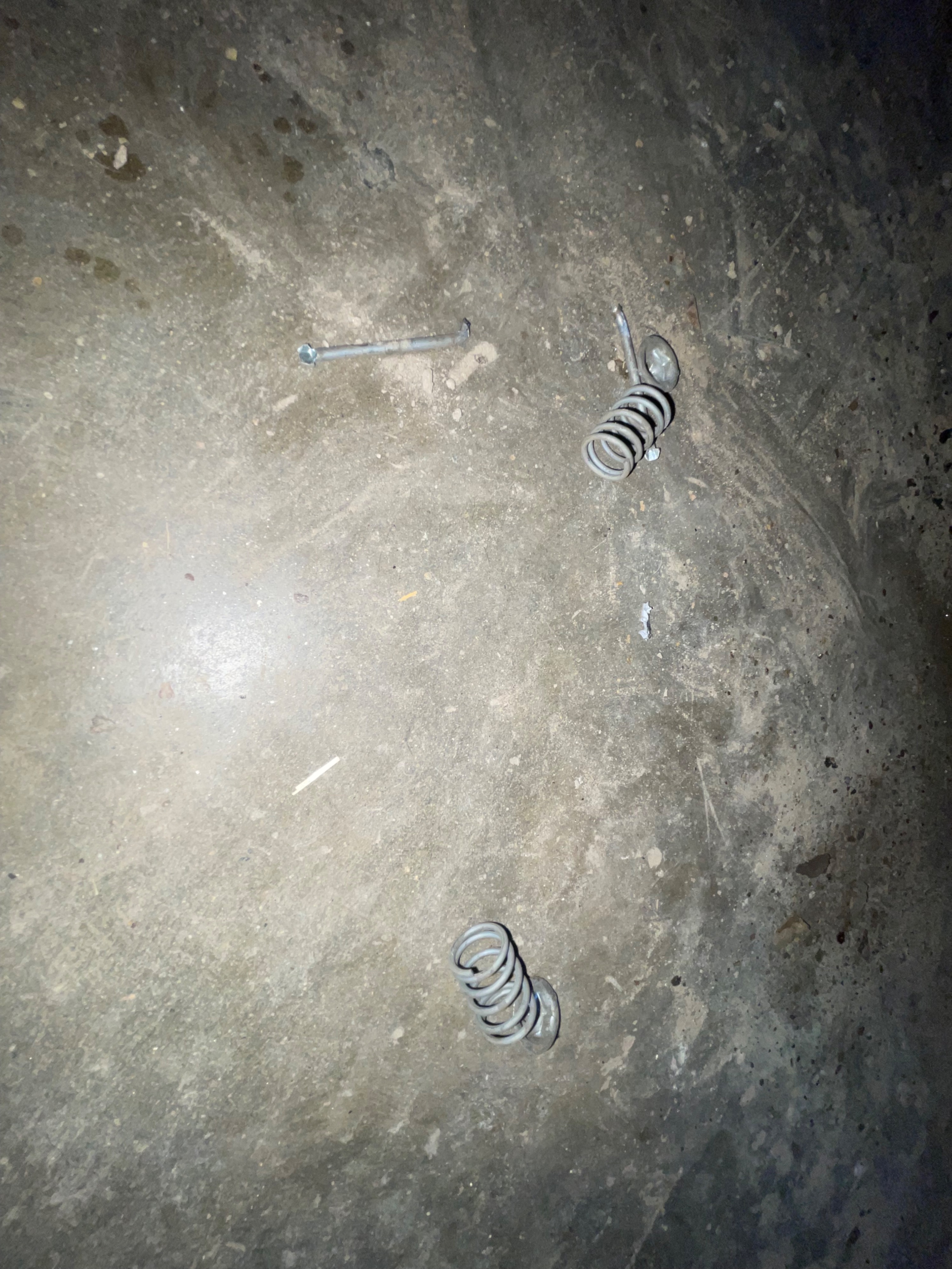

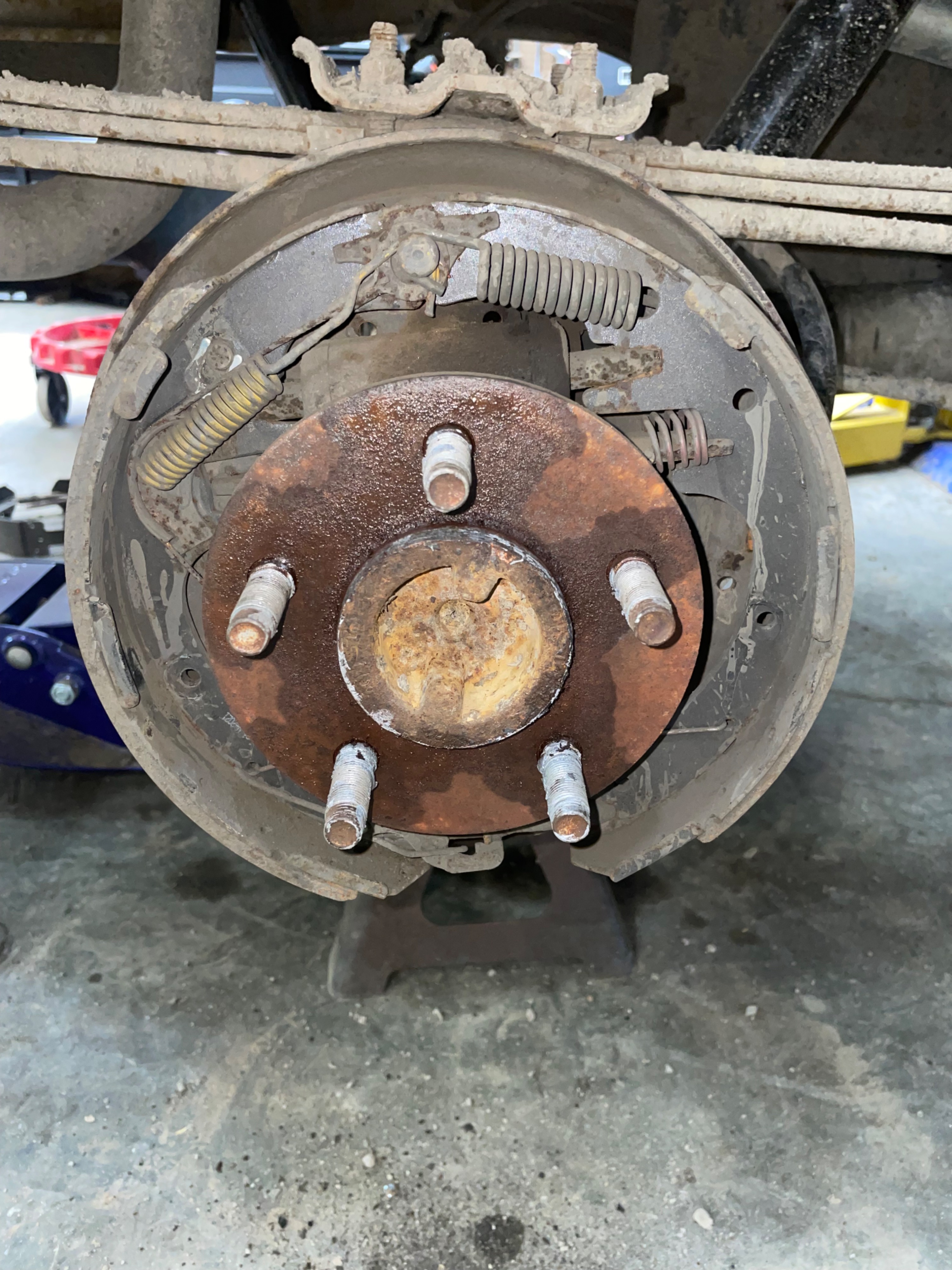

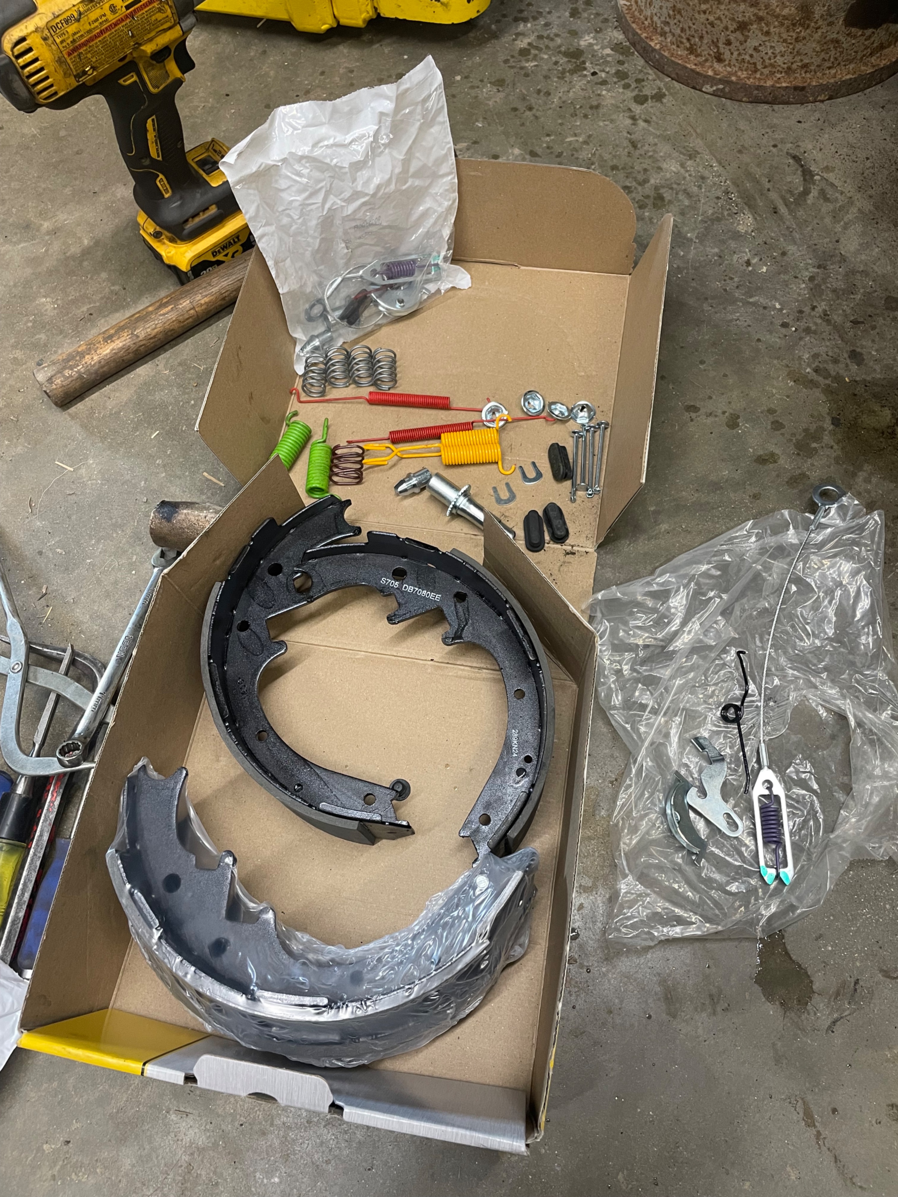

So the rear drum brakes were making some noise
Getting the drum covers off can be a challenge, lucky I know a few tricks
The adjuster was frozen and would not turn, so no way to release the shoes
Next I pry the shoe retainer rods from the backside of the backing plate with a screwdriver and then cut them with a grinder. This lets the shoes dangle a little bit inside the drum. Next I unbolt the wheel cylinder from the backing plate. This allows more movement from the shoes. Now smack the drum with a sledge on all sides and the face, with screwdriver from the back try to pry the shoes inward. Finally the drum comes off and parts / springs hit the floor. Victory! For anyone who has battled brake drums in the past you know you can spend a whole day on this… so one hour is not bad to be looking at the brakes
Big shock, the entire parking brake assembly was missing
The park brake lever was just hanging loose inside the brake, it was running on the drum
So I installed all new e brake hardware, new springs and shoes and even new drums

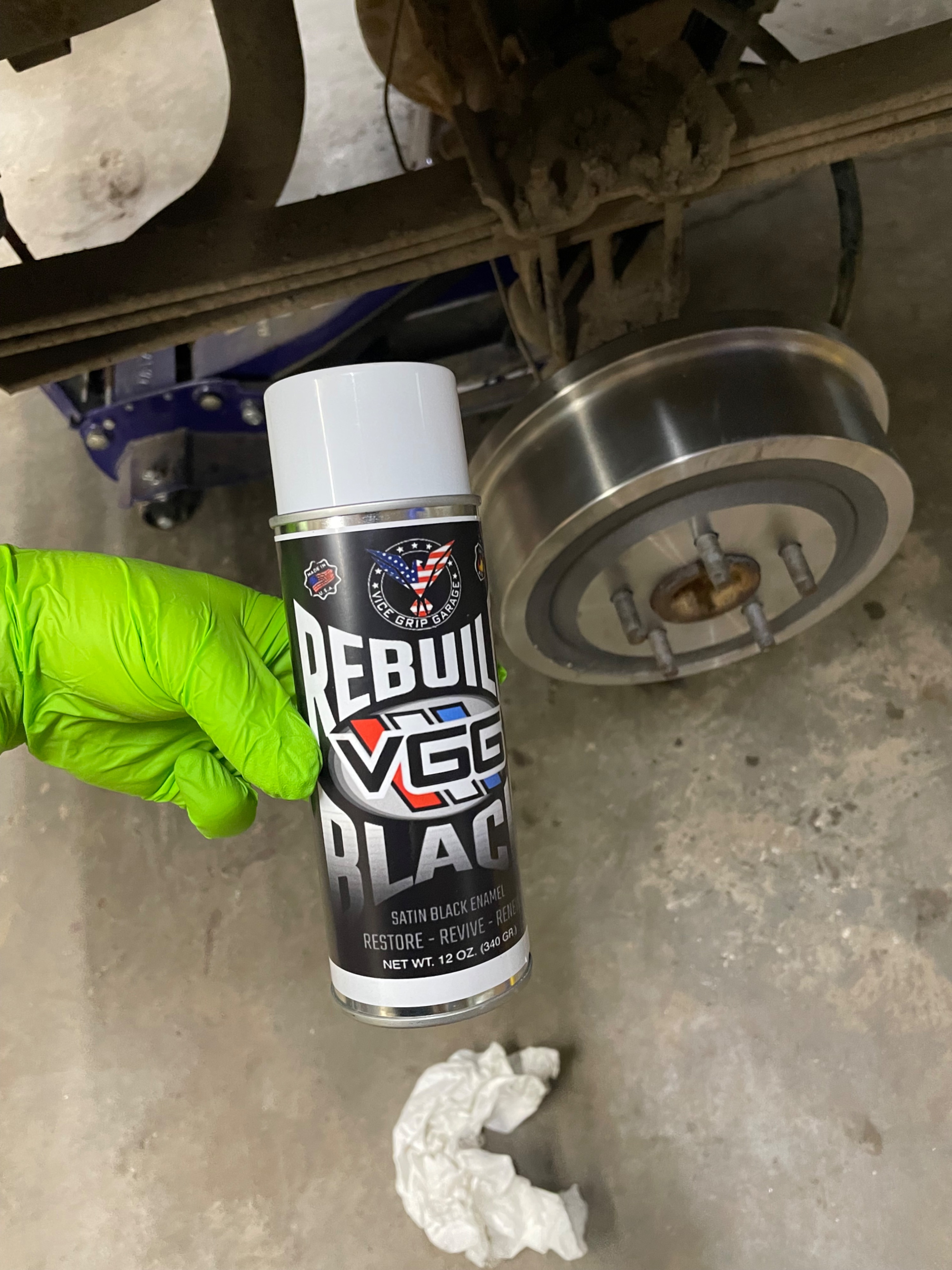

Good chance to use my Vice
Grip Garage rebuild spray… which is actually a very high quality spray paint imo
Brakes were gravity bled then power bled..
All the old 1998 brake fluid is gone and man oh man do we have some good braking now! (This ranger is running the larger front rotors from a 02 trac)

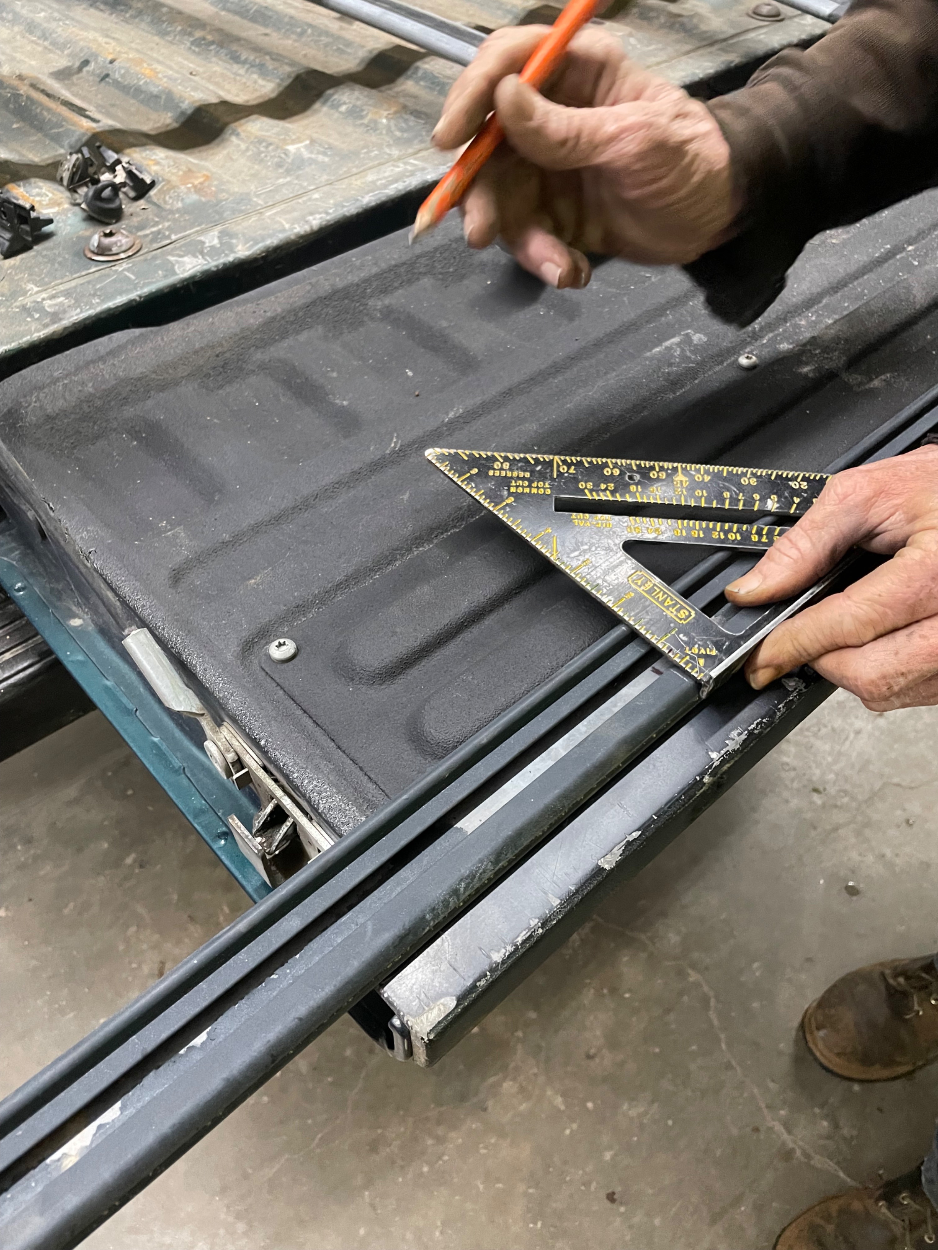

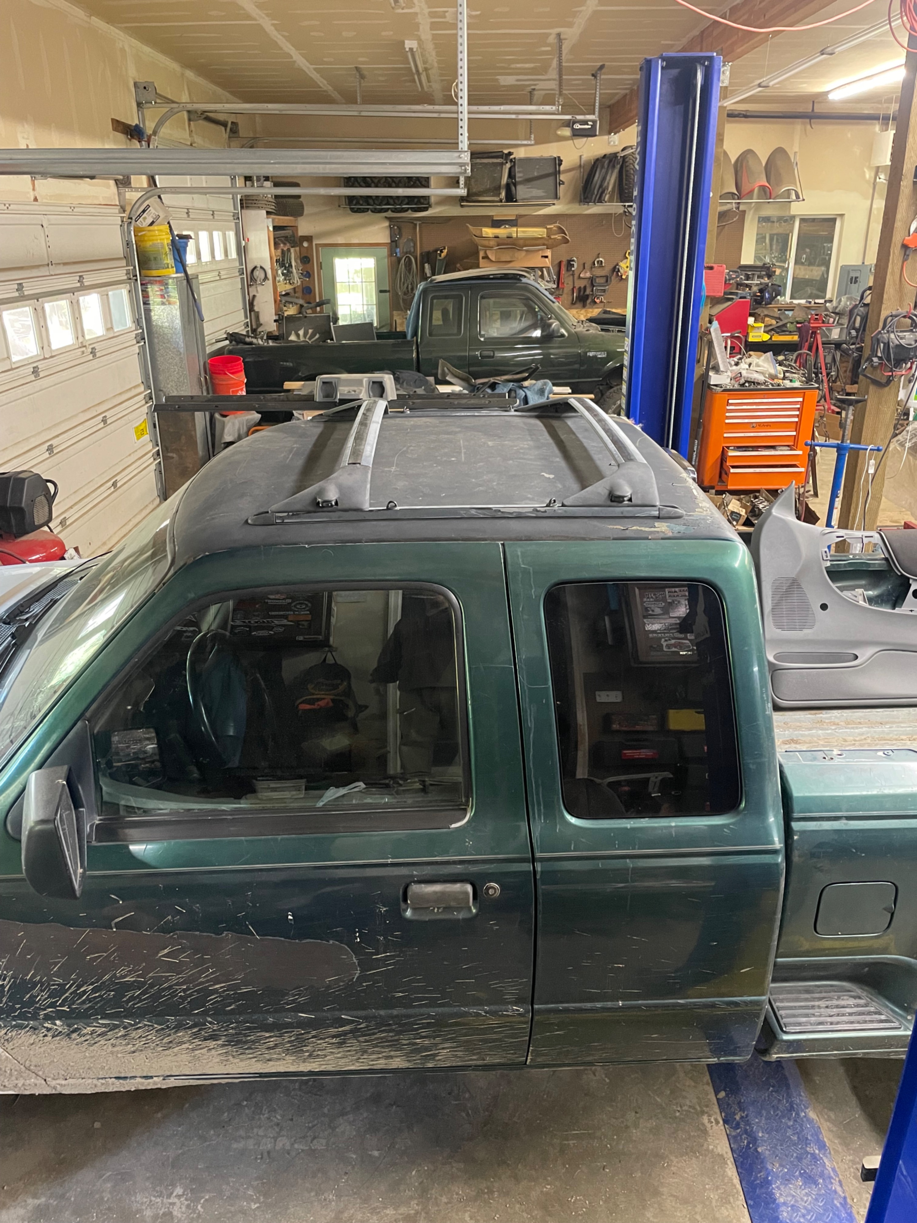

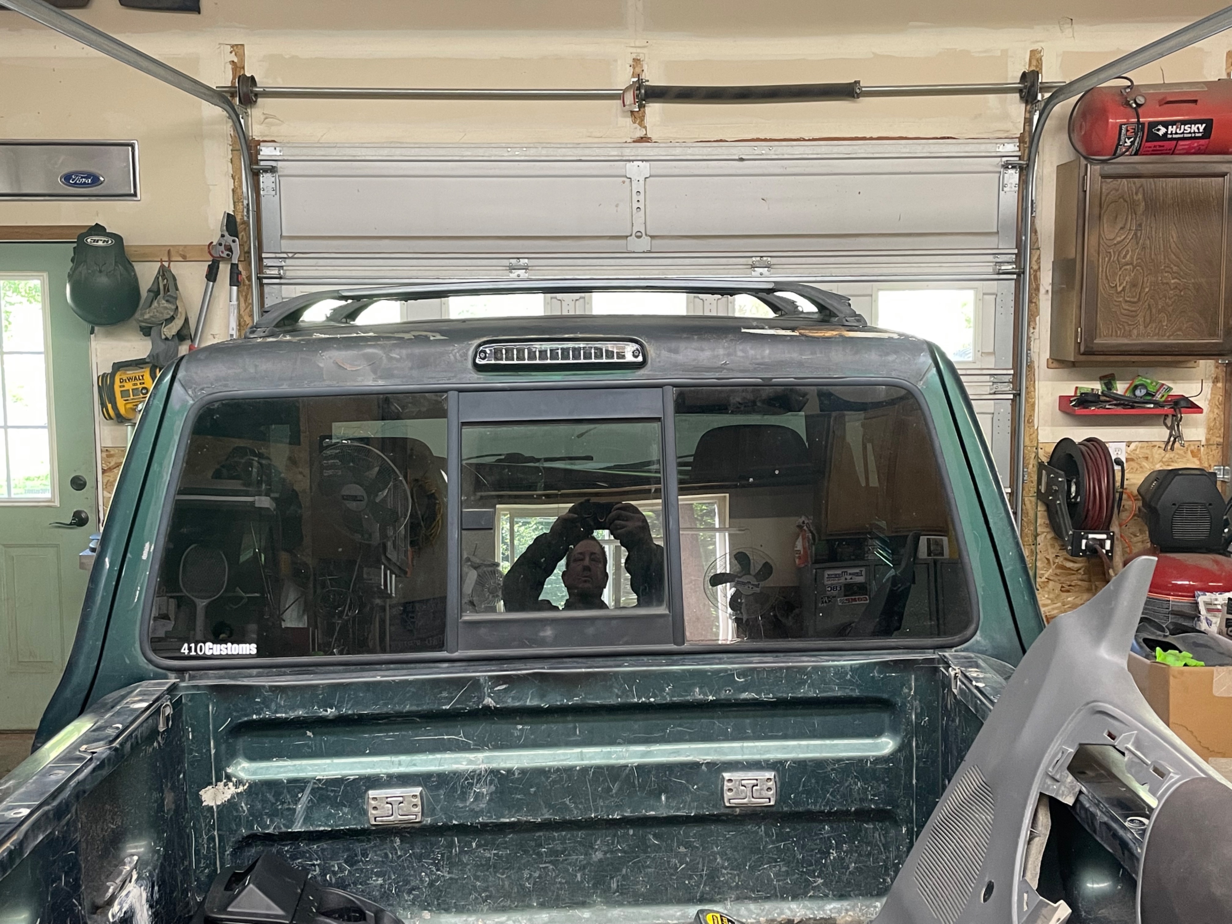

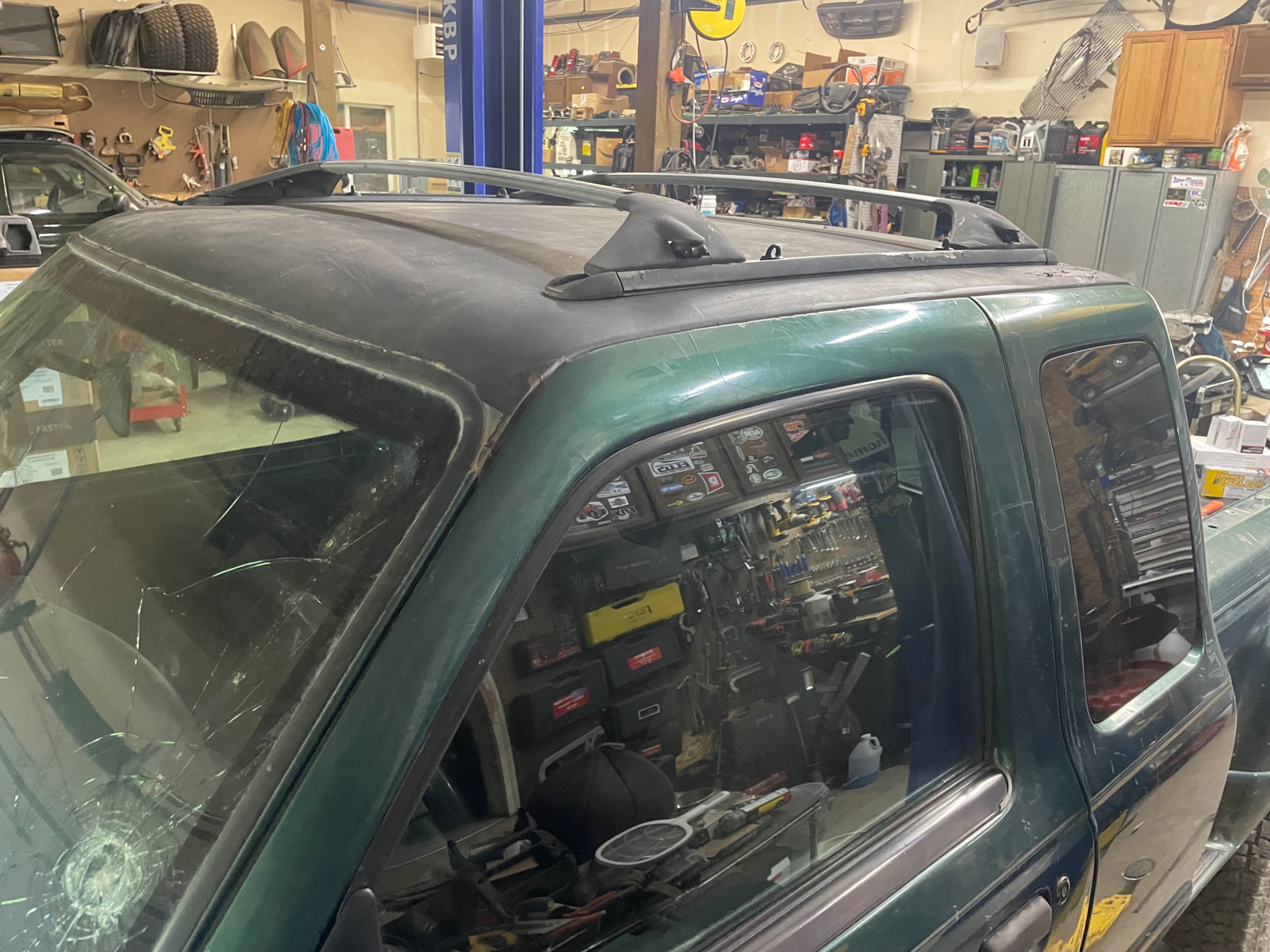

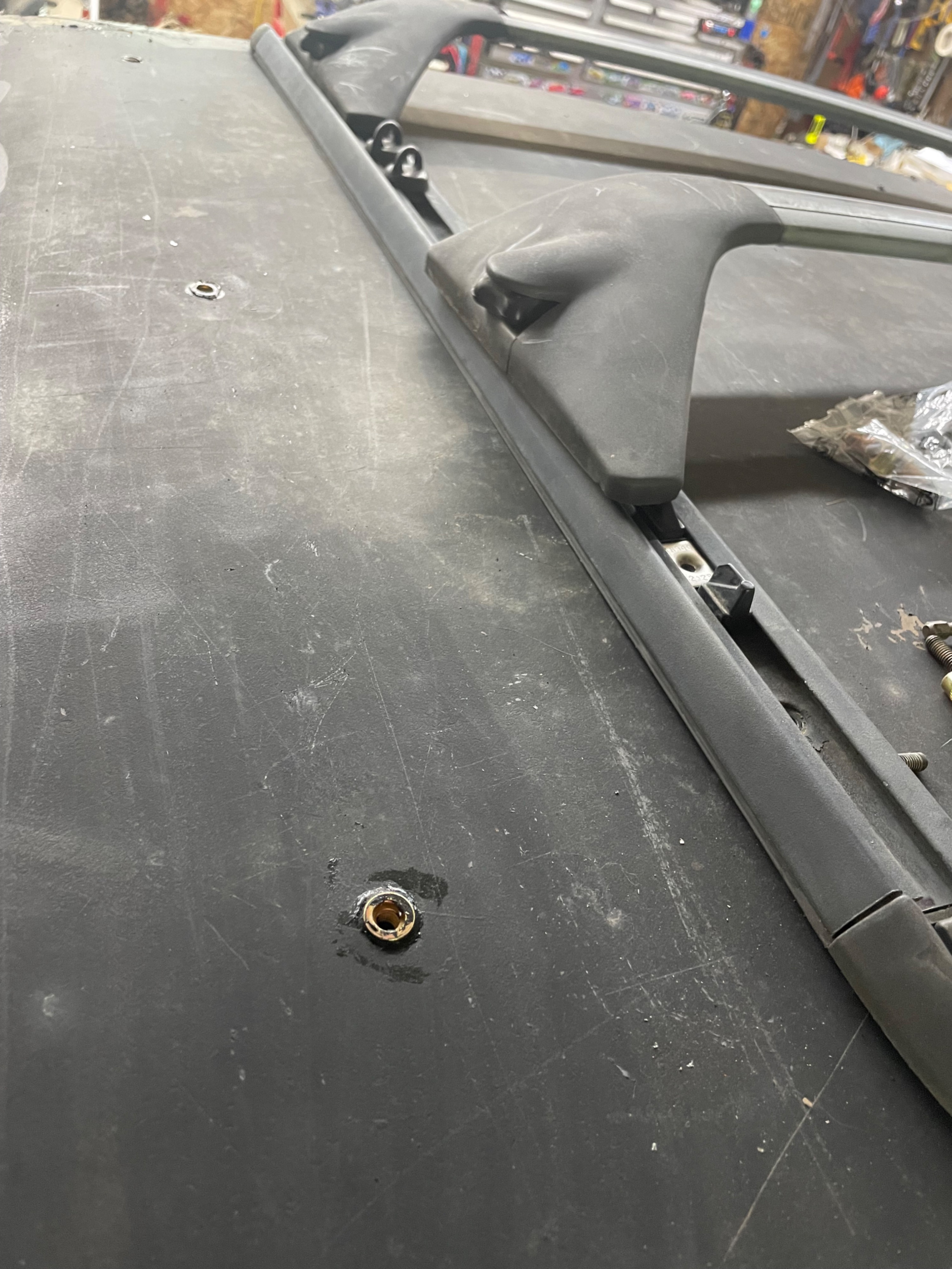

Next up my kid is a skier and I put a Yakima ski rack on his jeep. We are gonna need a way to mount it on this ranger. While there was no headliner I took the opportunity
(I get this mod from my stepson, he has this in his ranger for many years now)
Explorer factory

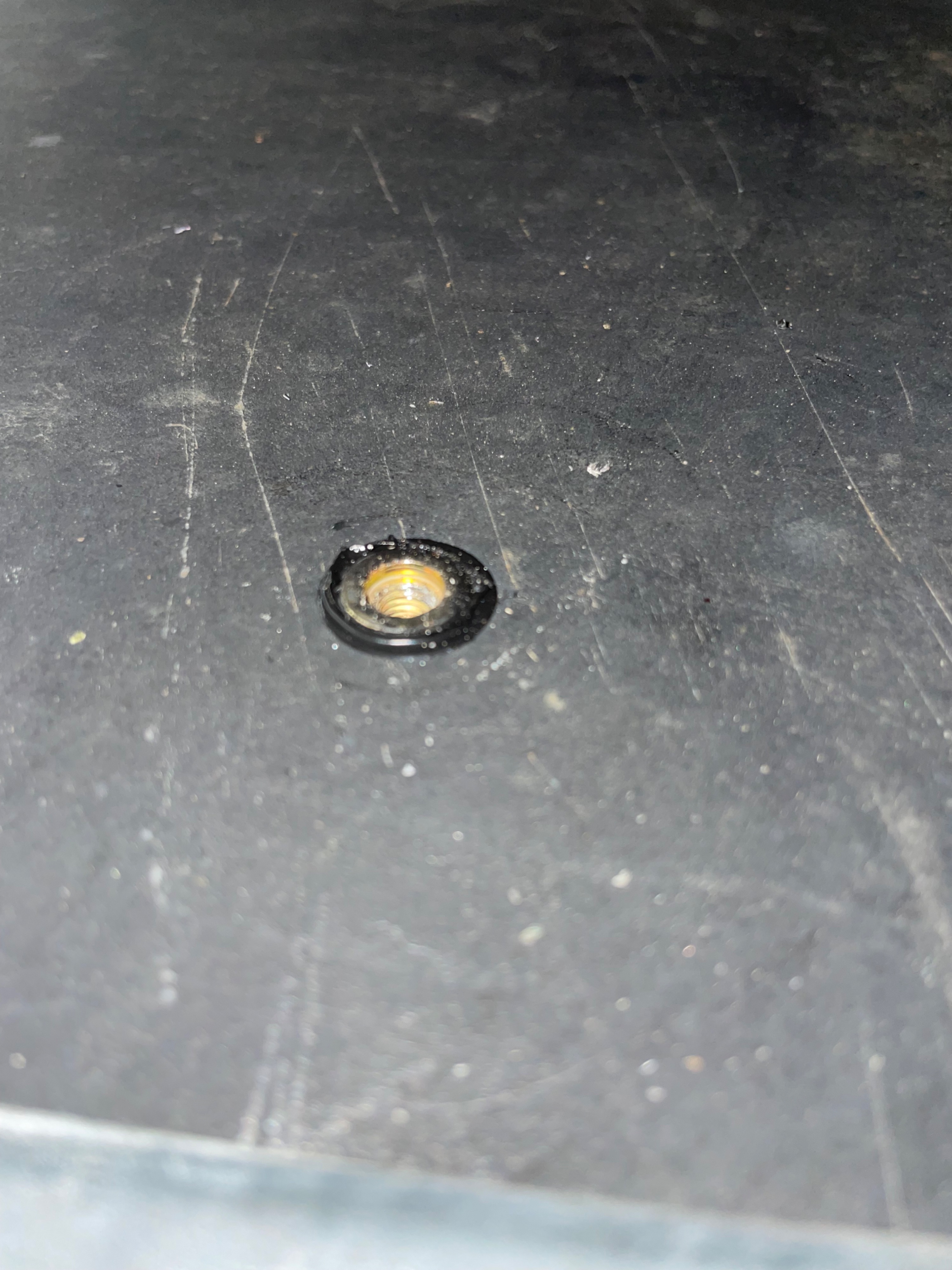

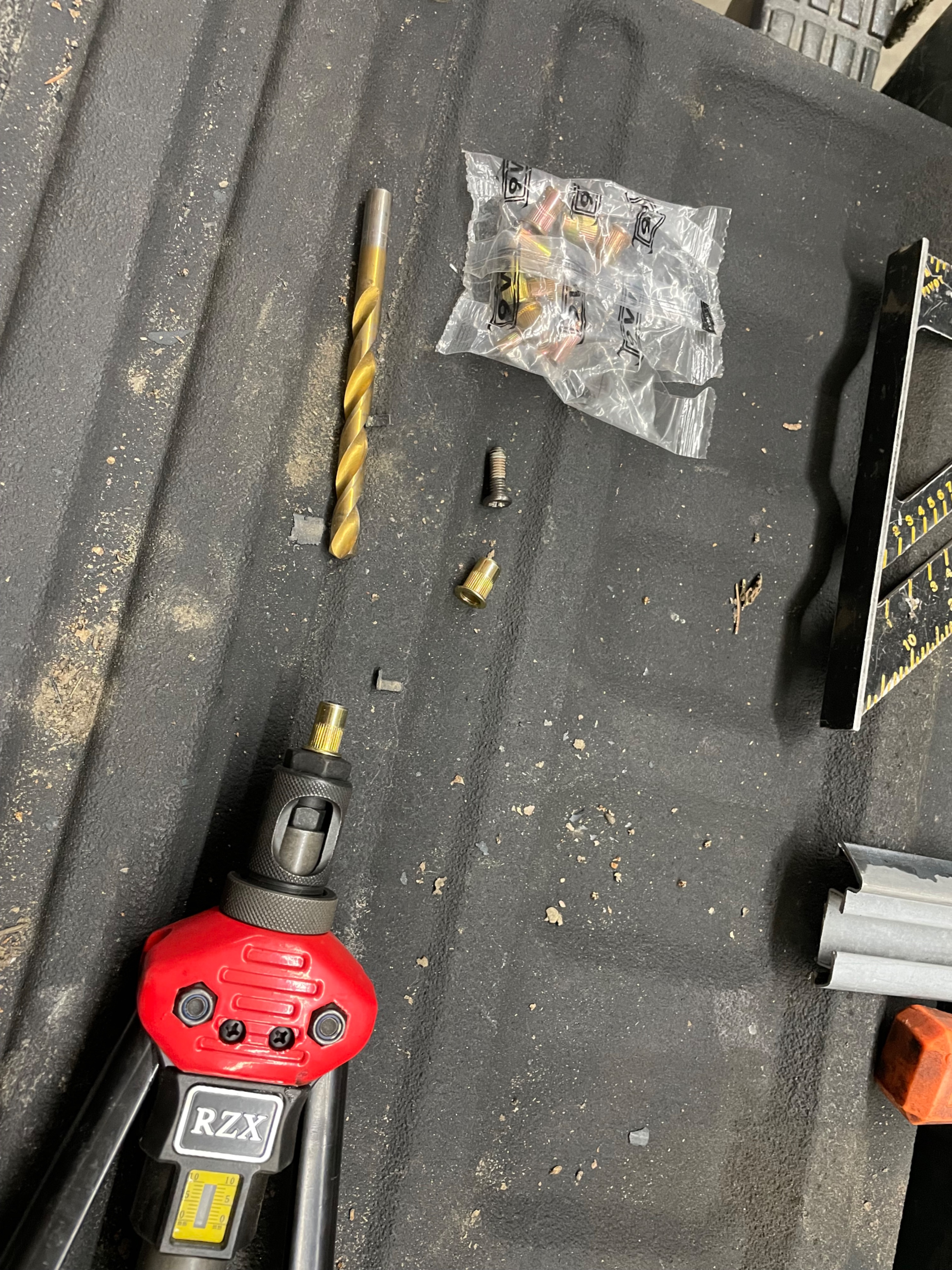

Luggage rack cut down to fit a ranger
96 explorer factory luggage rack, cutting the rails down for Ranger roof

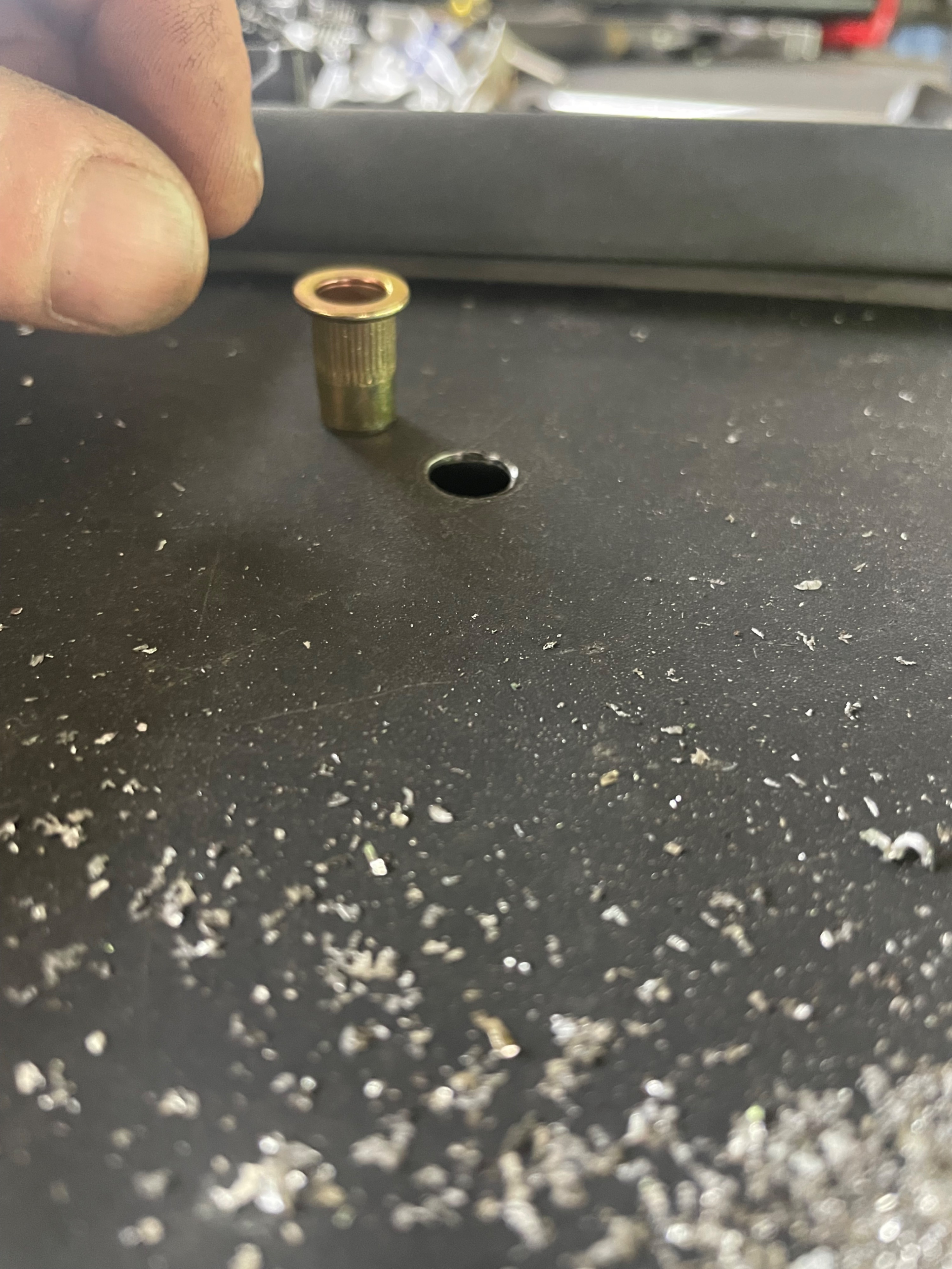

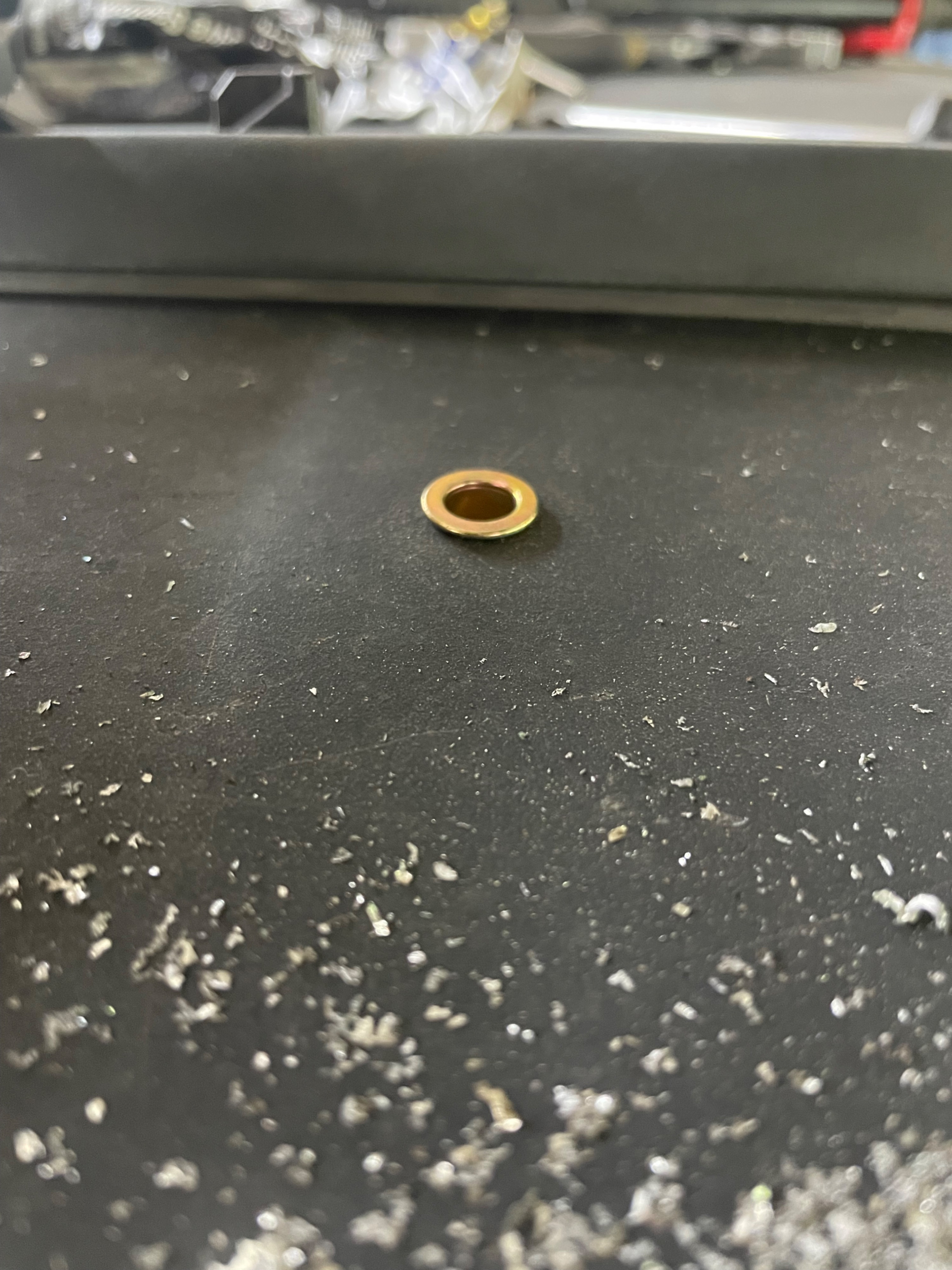

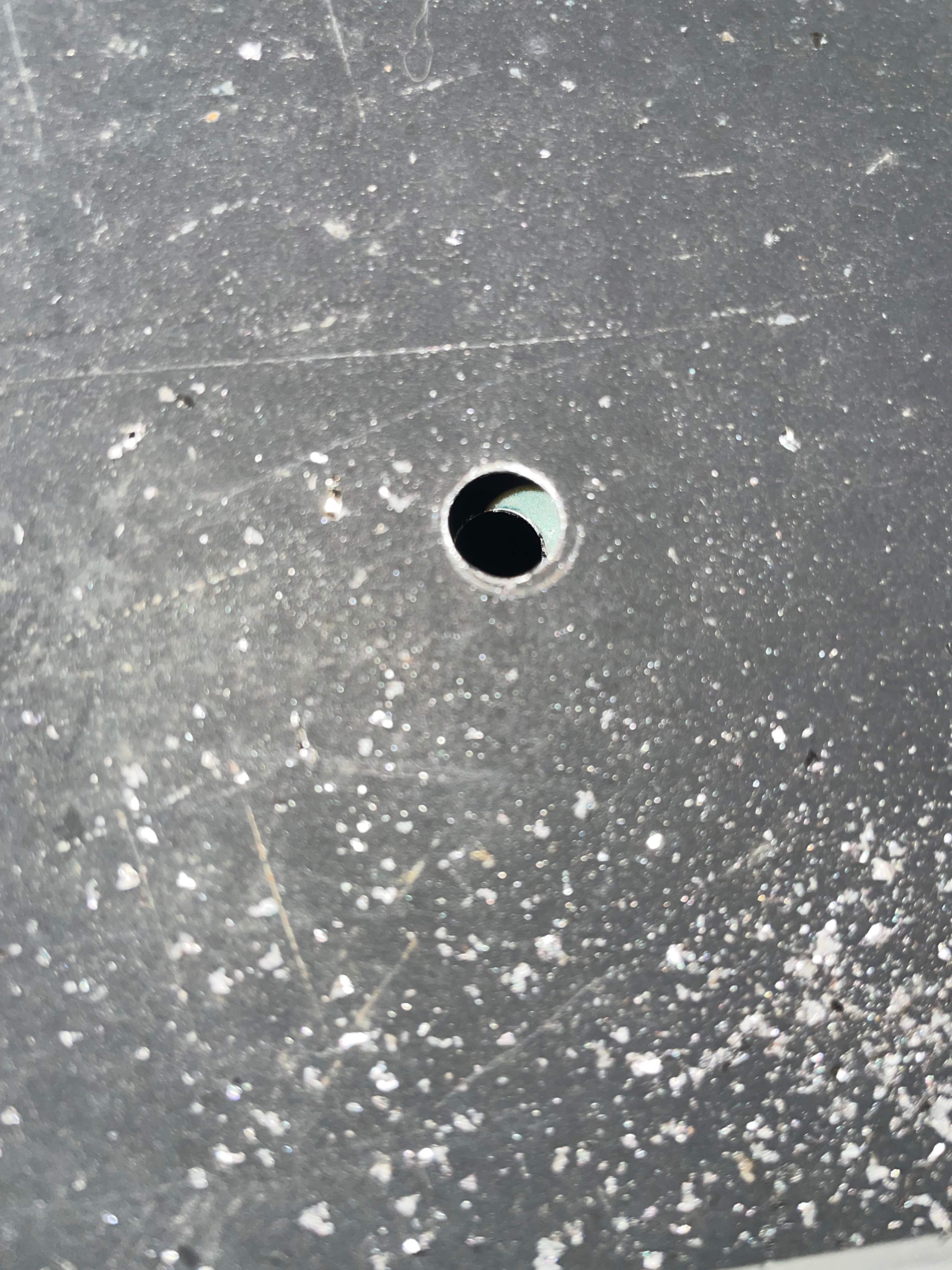

Nutsert rivets and perfect for this with a little silicoln to keep water out
Rack was centered and measured several
Times

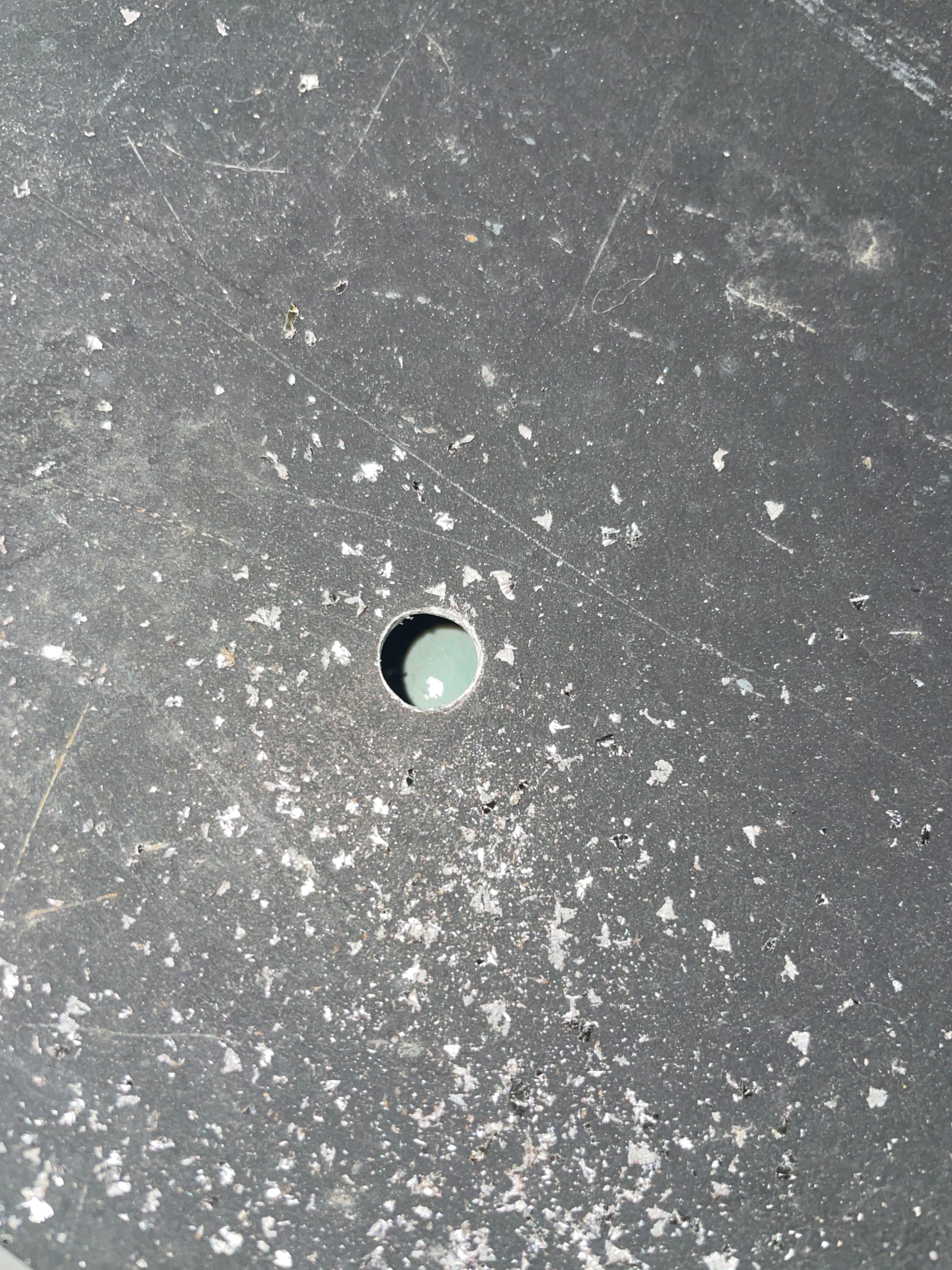

Hole locations marked and drilled
Holes filed smooth, nutserts installed with some permatex
Rack was bolted on with factory explorer screws and some thread sealant on the threads. The front most bolts I went with longer screws and added nylock nuts underneath just to make sure it cannot pull off the roof sheet metal
Love it! Really sets this ranger apart

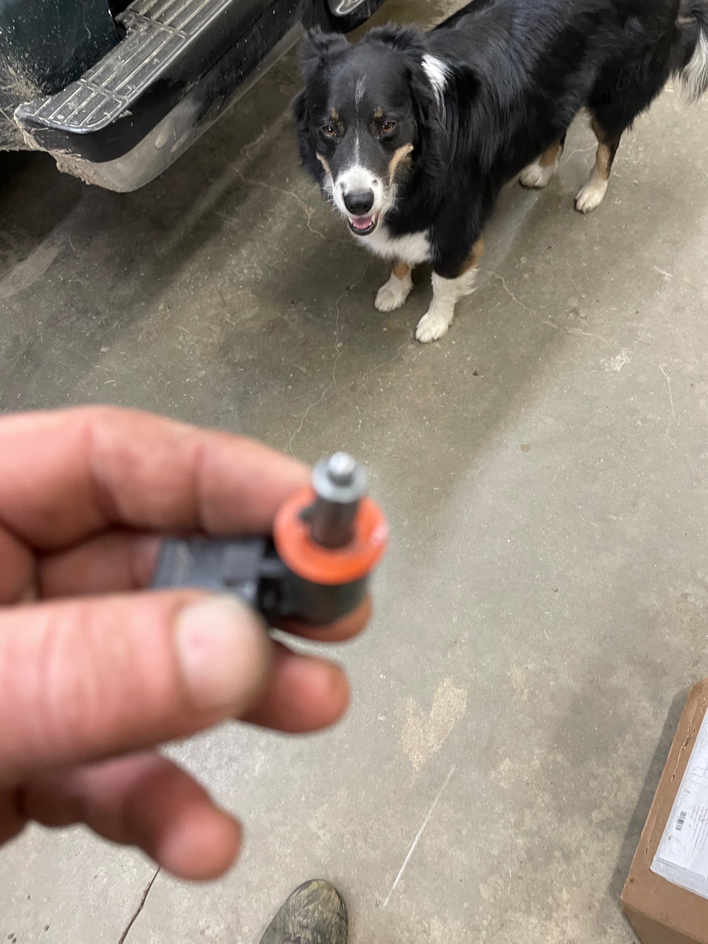

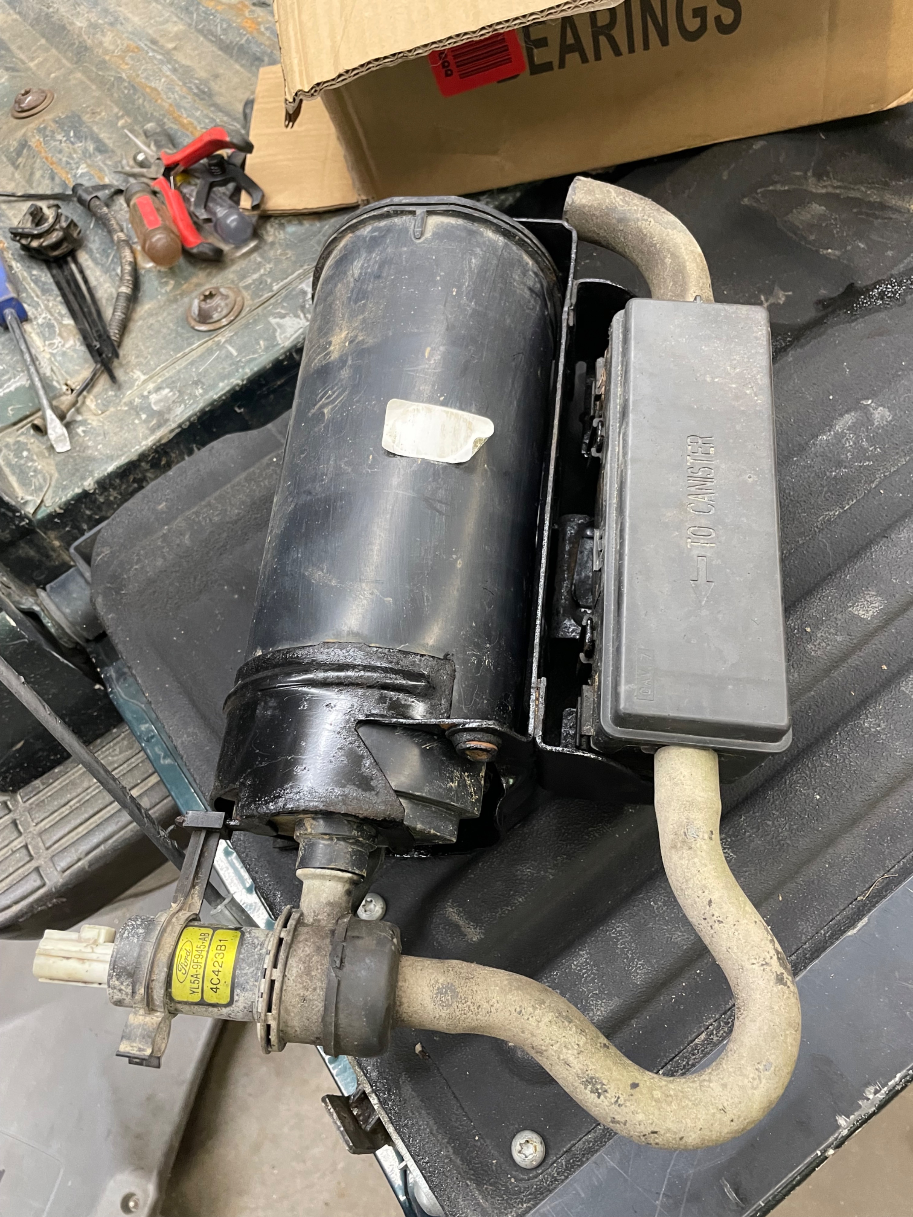

Now a reoccurring p0443 canister vent circuit failure is the last trouble code
So I checked my wiring
Canister vent gets power from same fuse as the 02 sensors… the other wire goes directly to the pcm for vent control.
With multimeter I checked wiring direct from vent valve to fuse.. it’s goood. Checked other wire all the way to pcm and was surprised to find out it’s also good. So must be faulty vent valve. Out comes the 1998 original part and I replaced it with one from a 2005 parts ranger

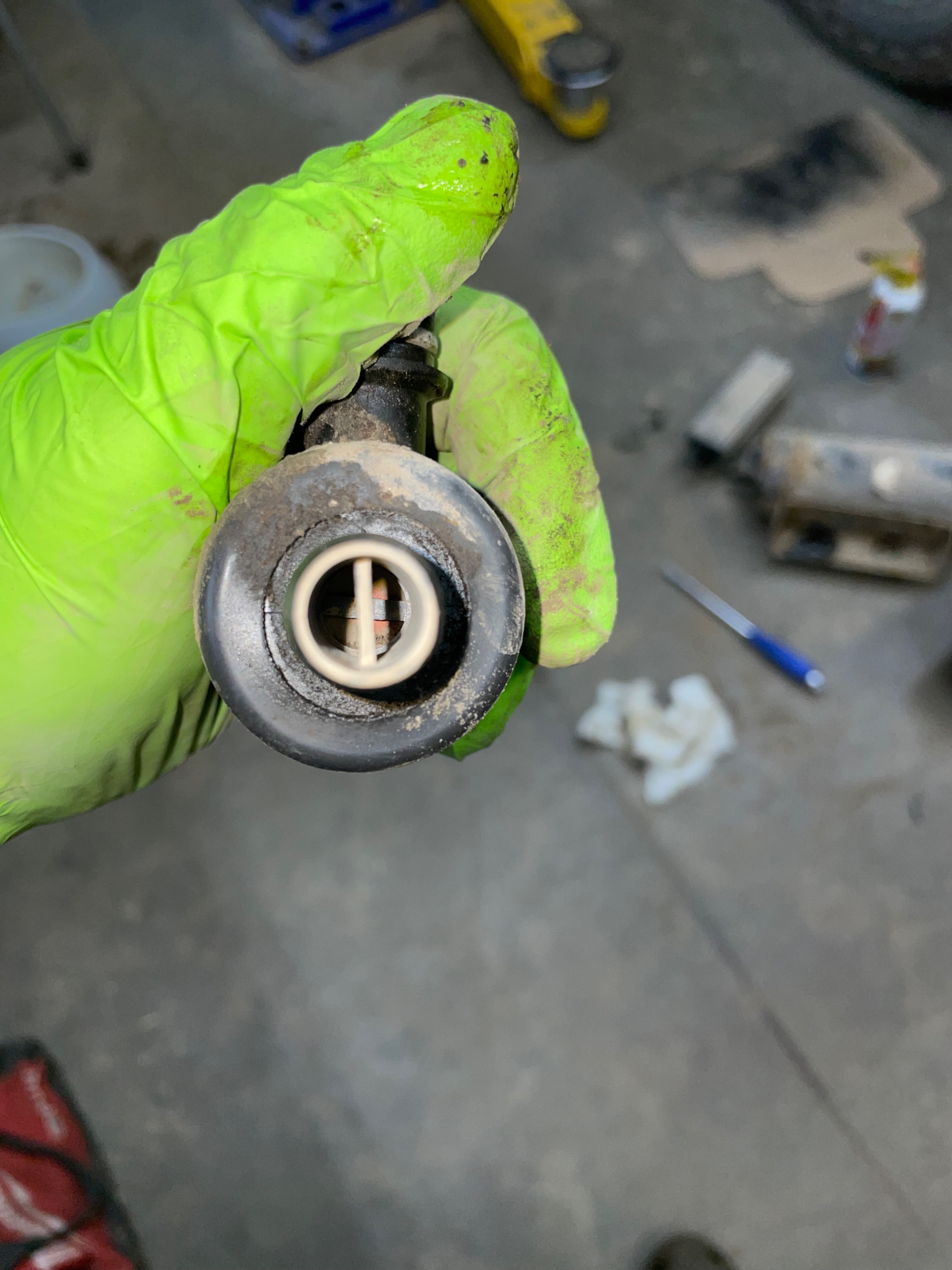

Another opportunity for the rebuild spray
Old vent valve full of dirt,
Could be the cause?
Dropped the whole charcoal canister assembly out for cleaning and refresh
Replaced Vent valve
So far code has not returned
FYI people the canister purge valve is in the engine bay
The canister vent valve is by the charcoal canister above spare tire.. they work together to burn fuel vapors through the engine, they are both controlled by the computer. Often people get confused and are never able to solve a vent valve code because they confuse it with the purge valve

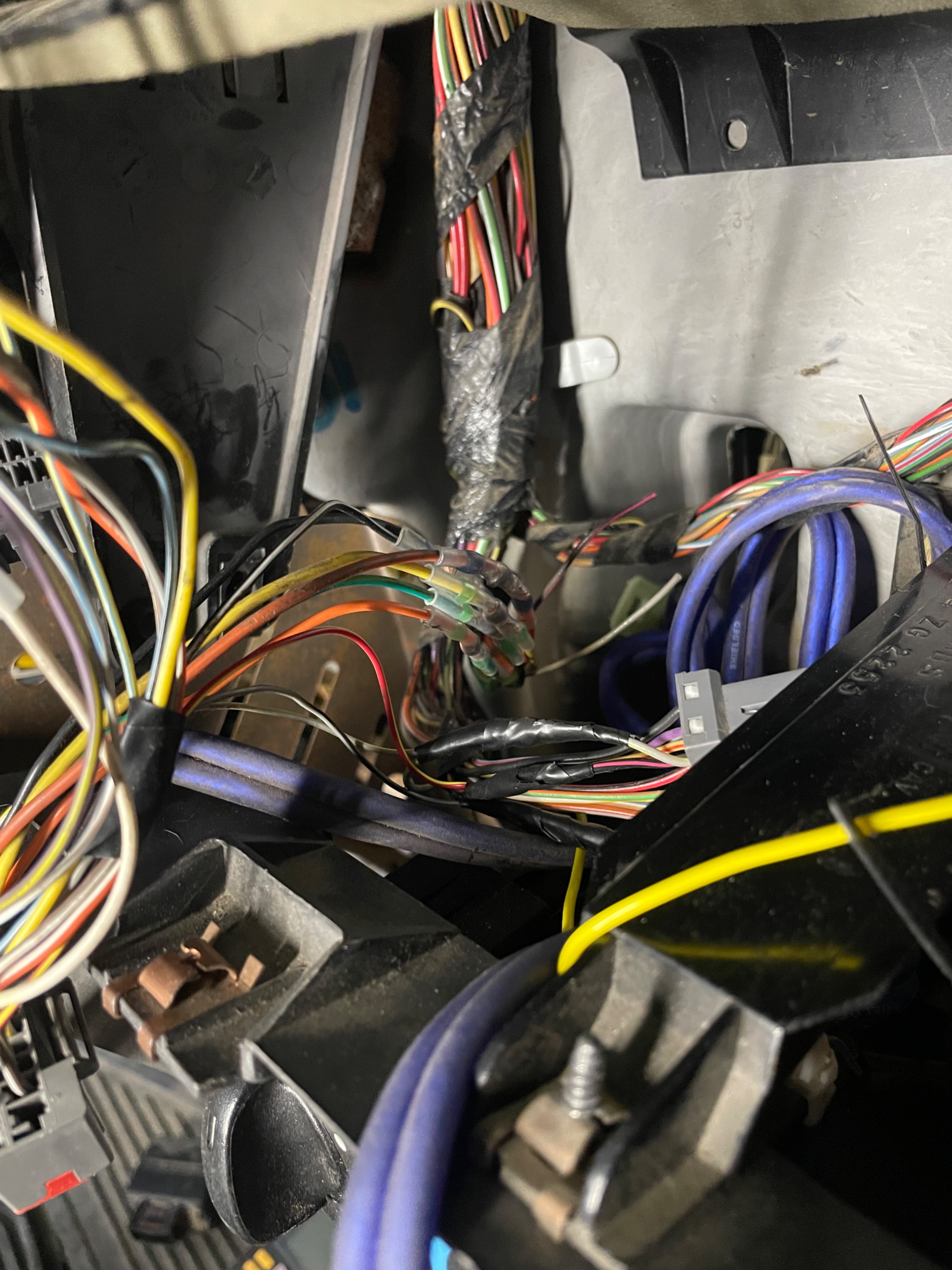

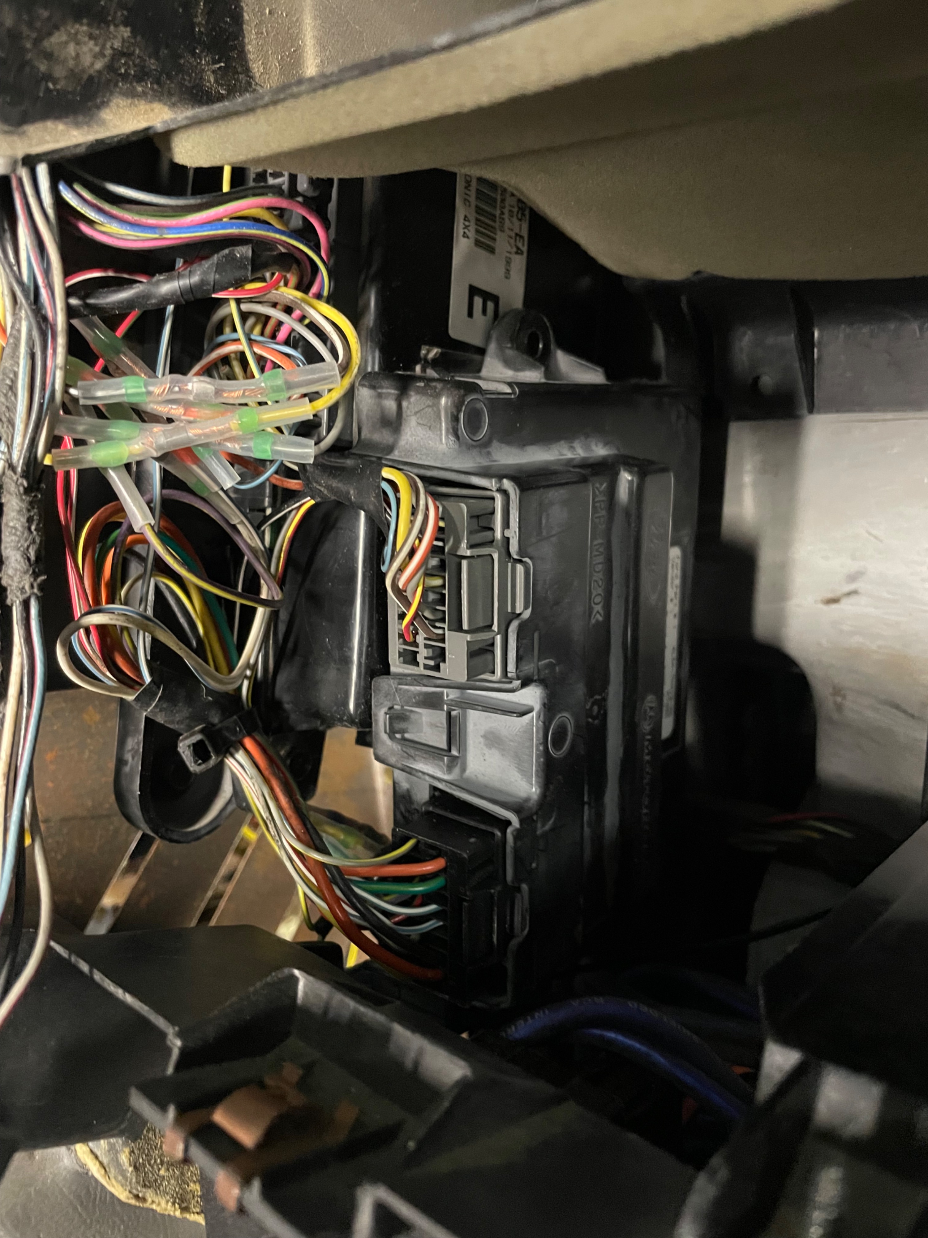

Time for 4wd

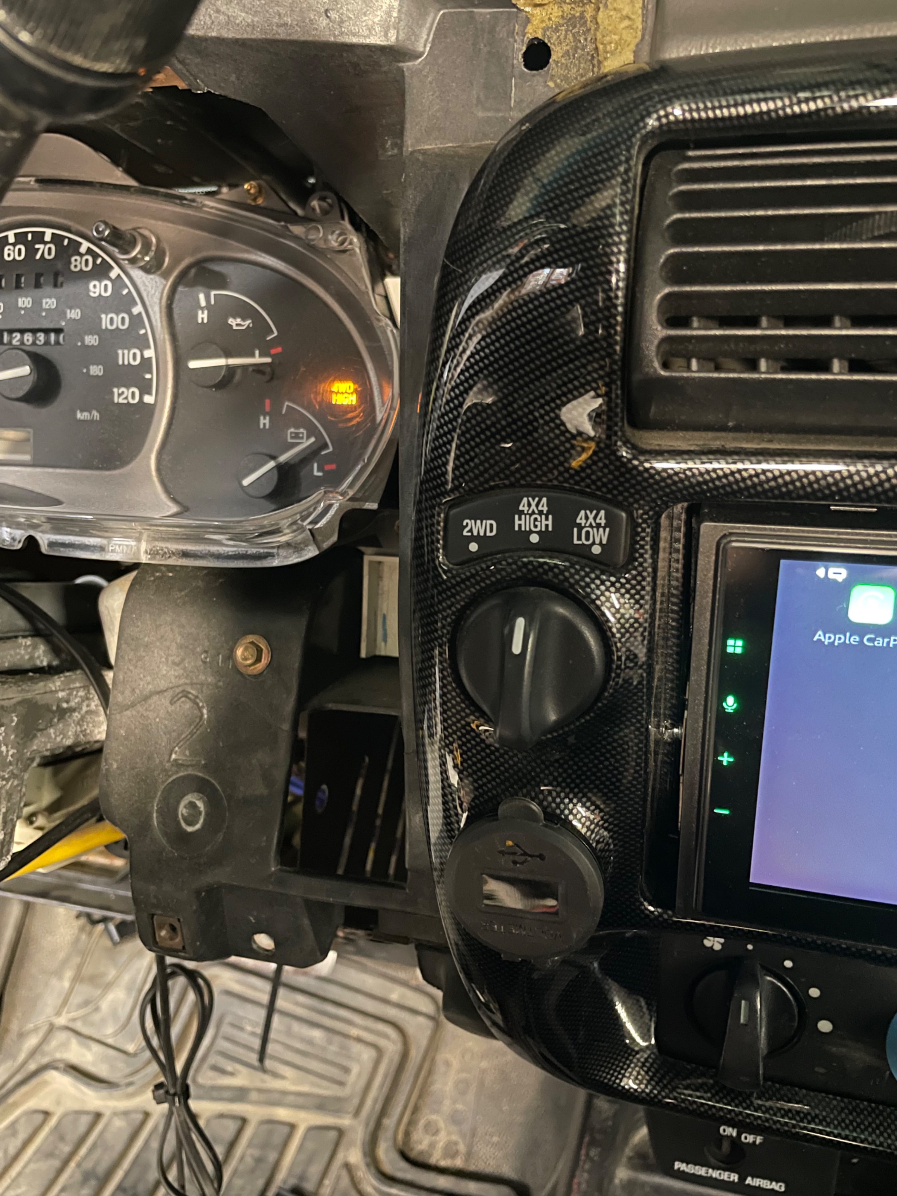

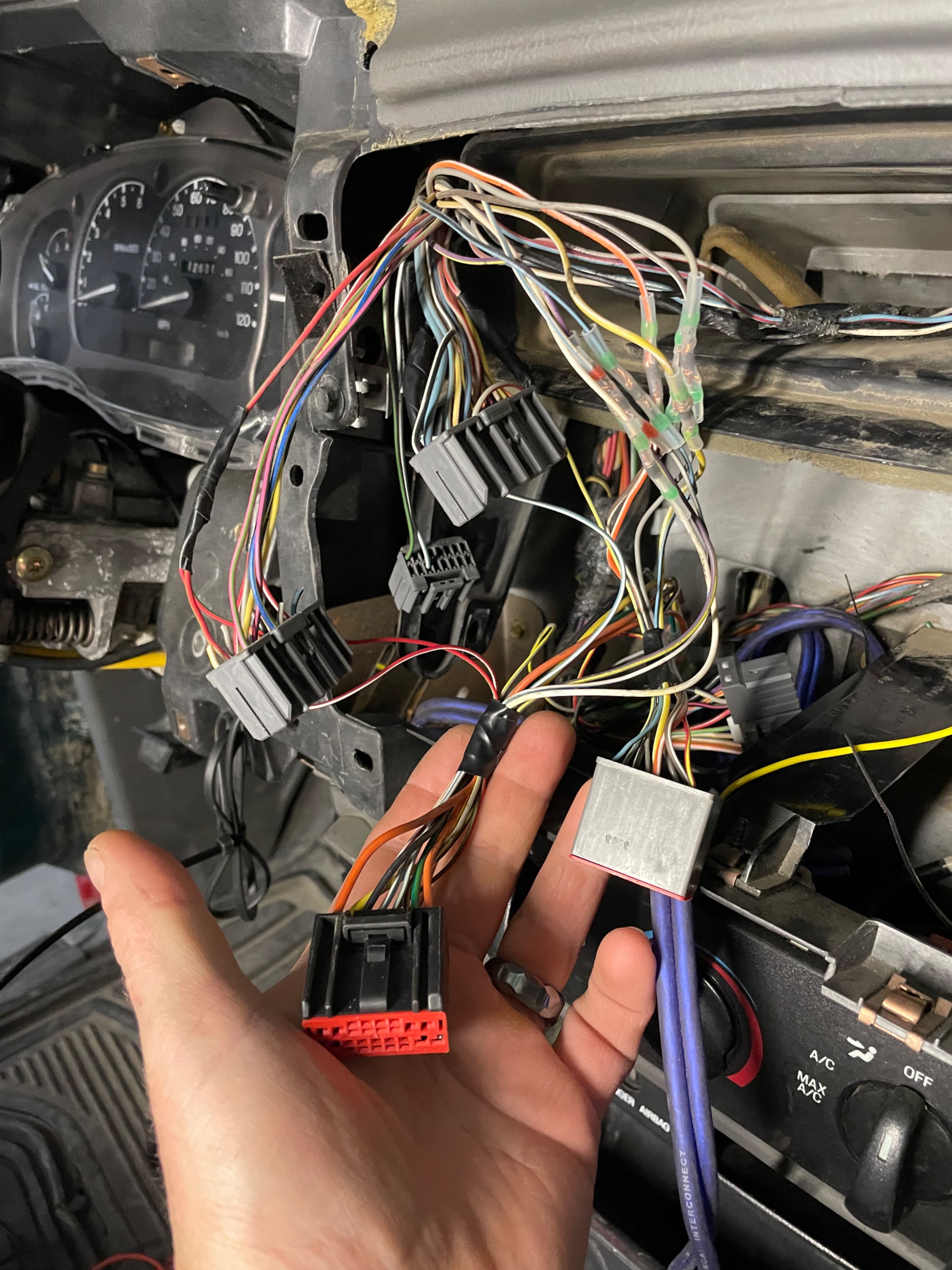

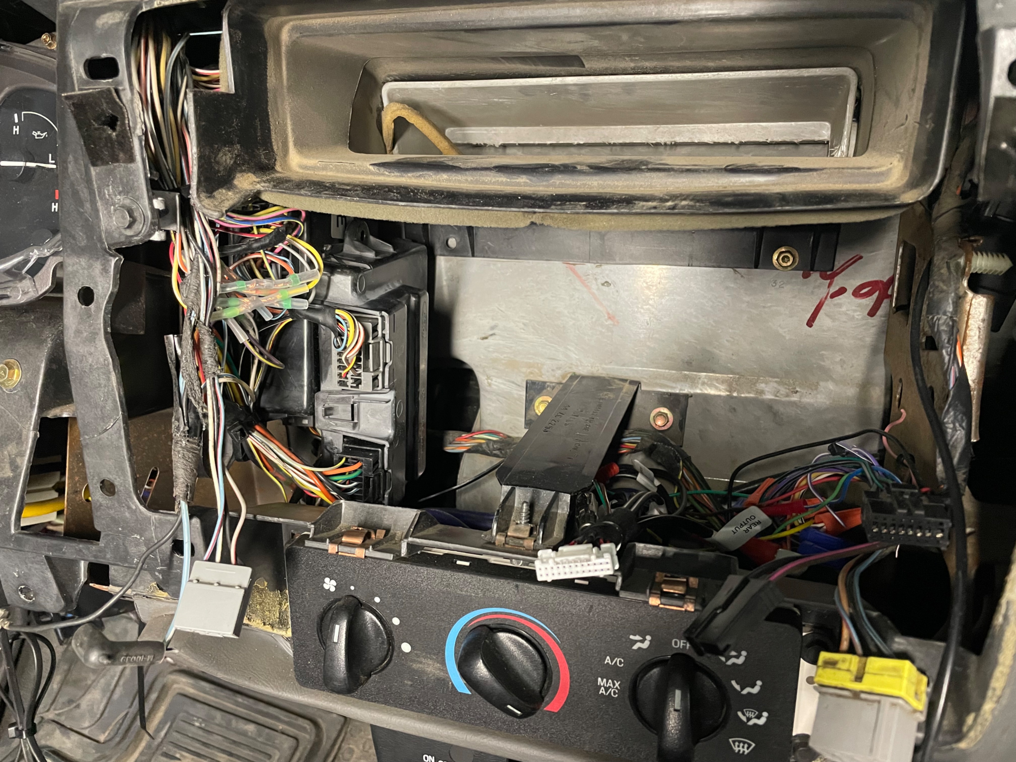

The old 98 gem module and 4wd control module no longer working. I know my shift motor is good (rebuilt on bench, reman dorman part I got off some ranger some time in the past, I have a box of these motors)
So I installed a 2005 ranger 4wd control module, the motorolla box. This was done by cutting all the ESOF wires at the original
Gem module and 4wd control
Box… and tapping into other wires (power ground, boo and vss signals) so the gem module remains operational For Other truck functions
Gem module and new moto box wired up and installed piggyback
Sure enough we now have a functioning ESOF system
You can see the dash light and dash switch now working the transfer case
Boom! High and low range 4wd

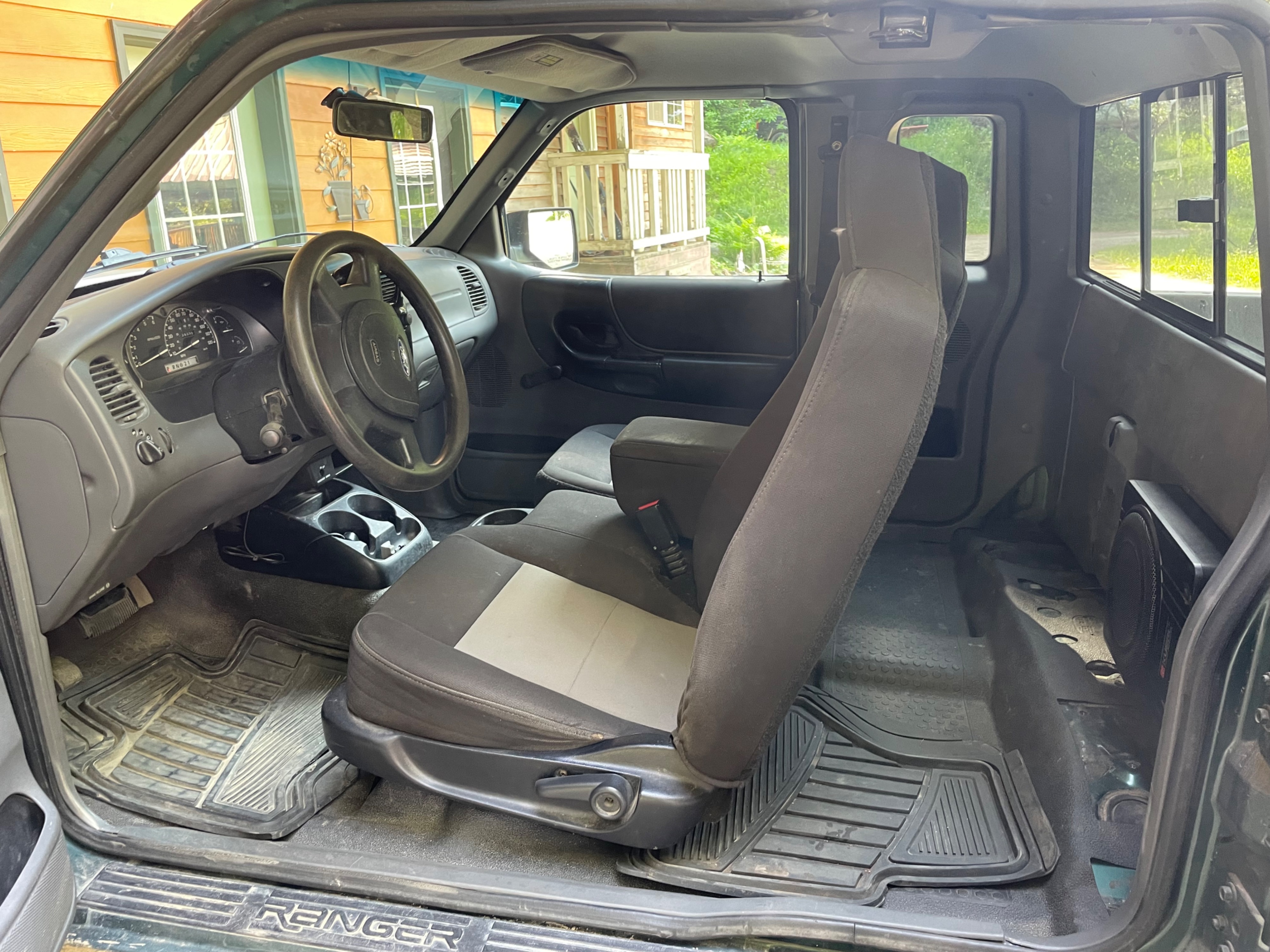

Time to install the rest of the interior

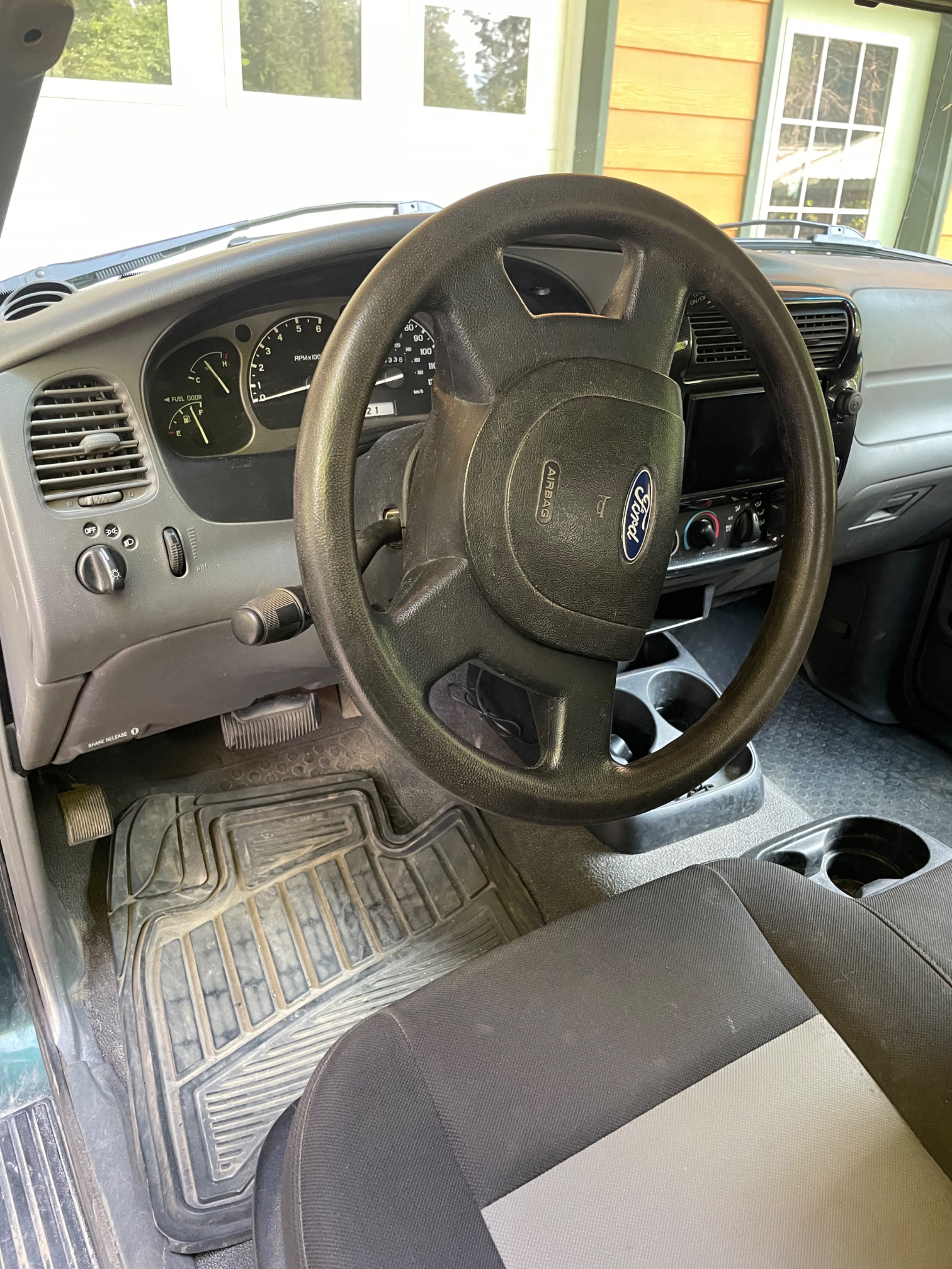

Instrument cluster fully functional got cleaned up, a silver bezel and some led backlights
Looks cool!

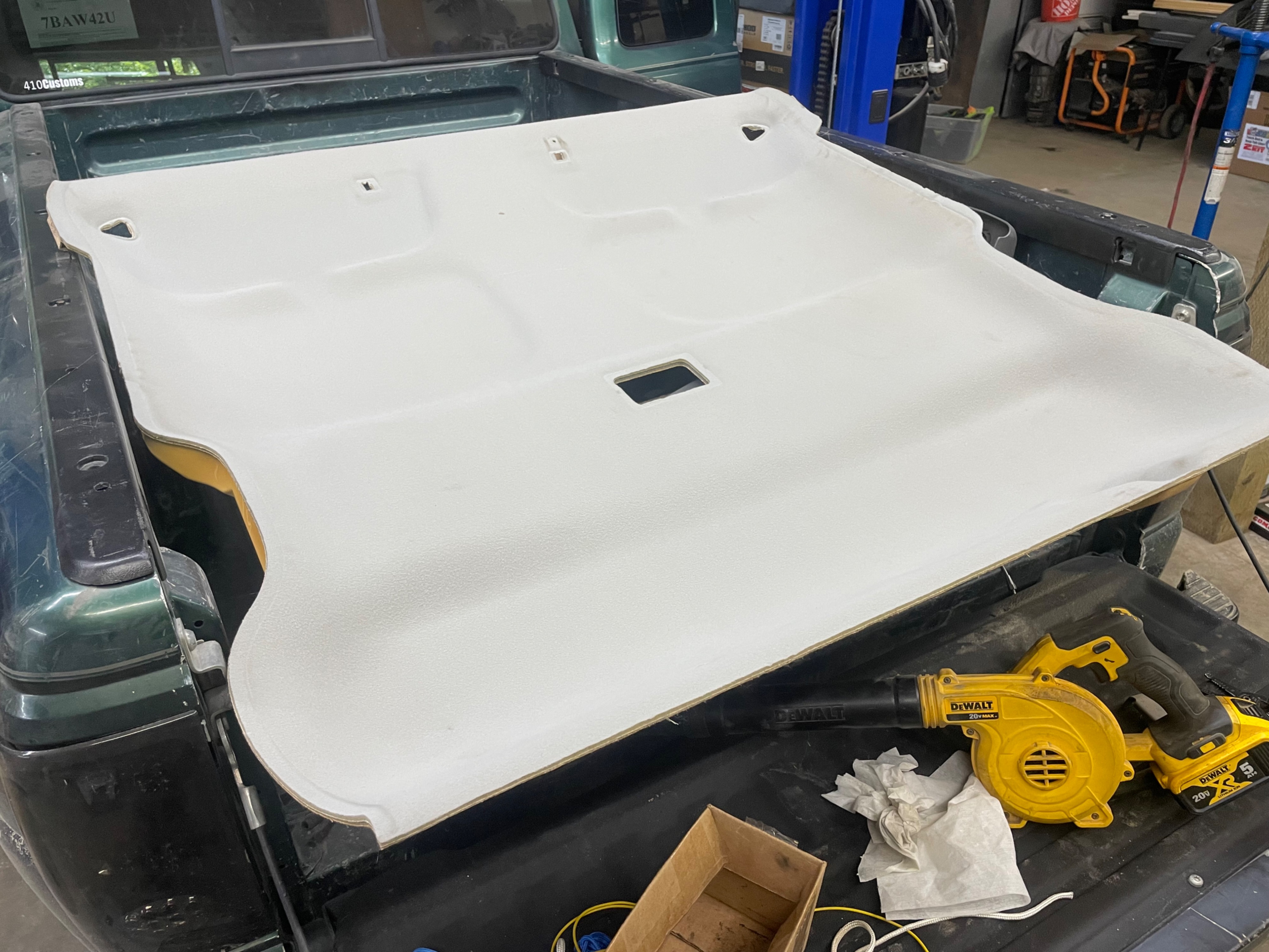

Headliner has been in storage this whole time. Not easy to store headliners! Must keep them away from cats (scratching post) and mice (bedding) and dirt and debris (flys around the shop)

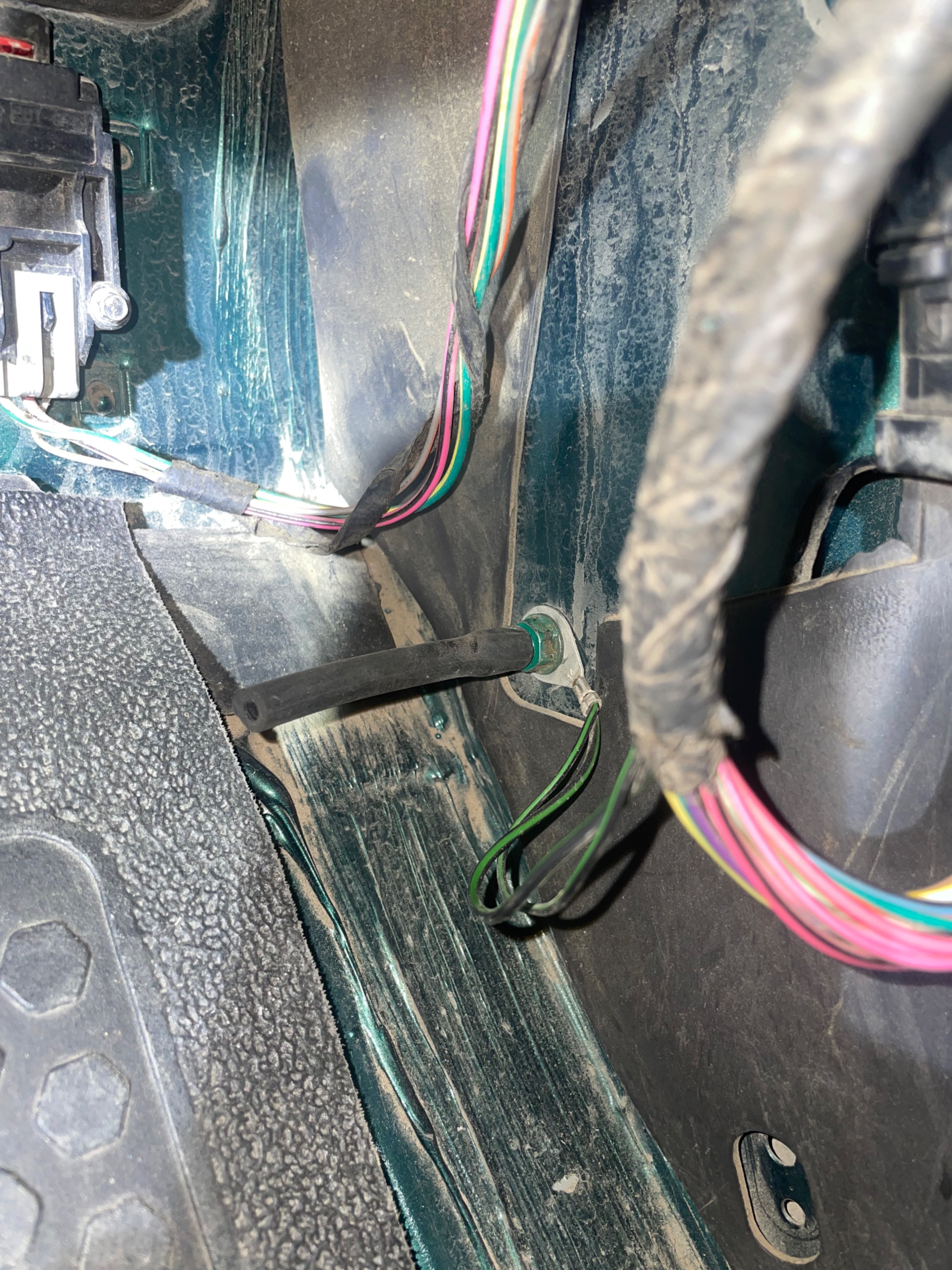

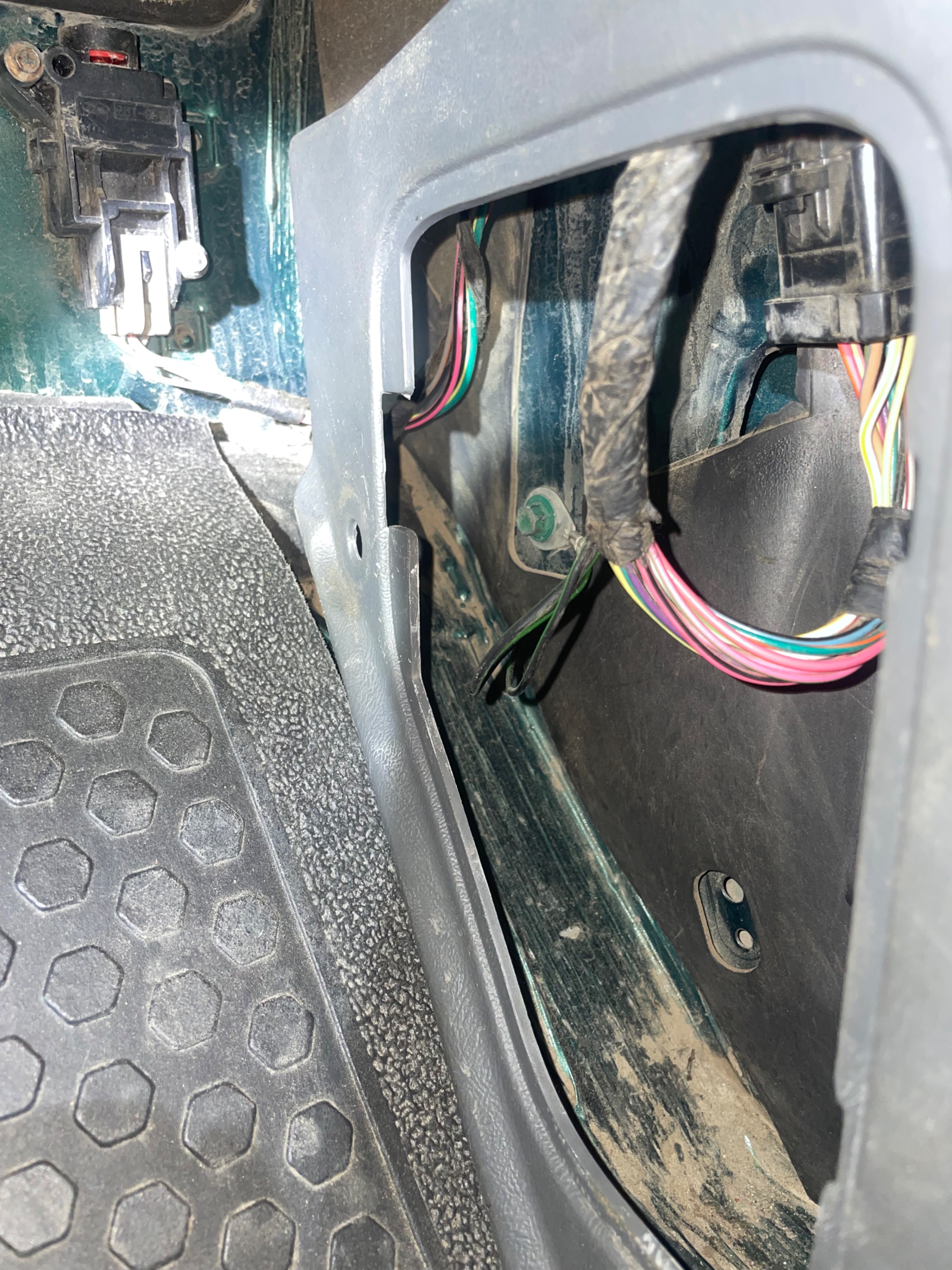

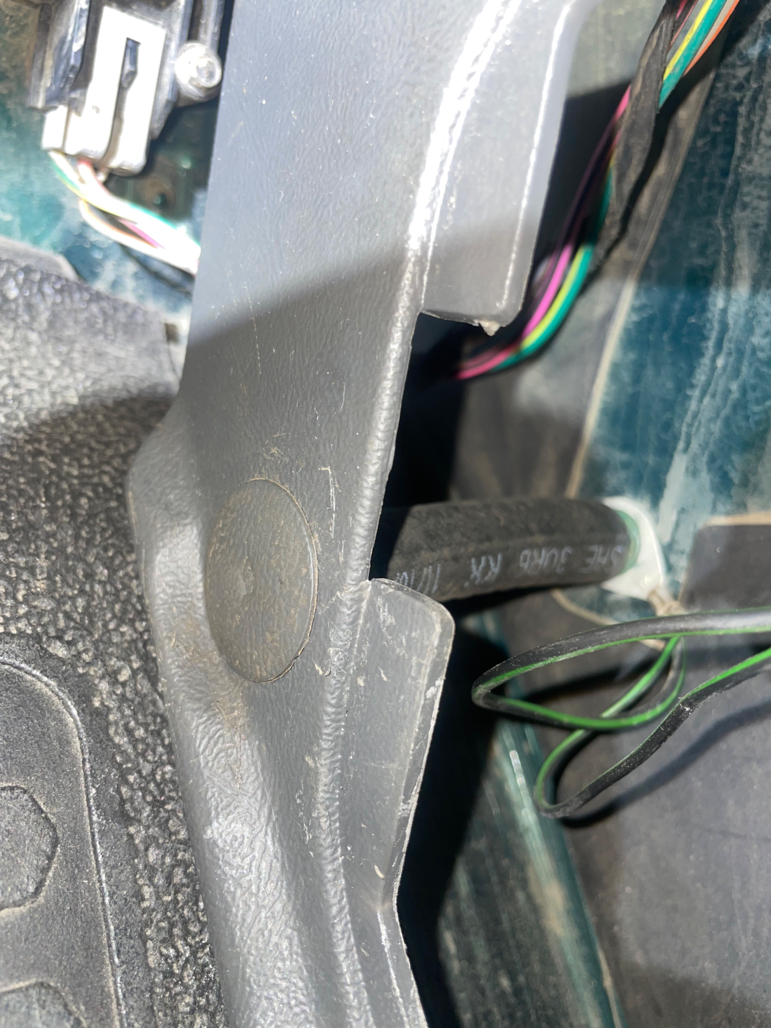

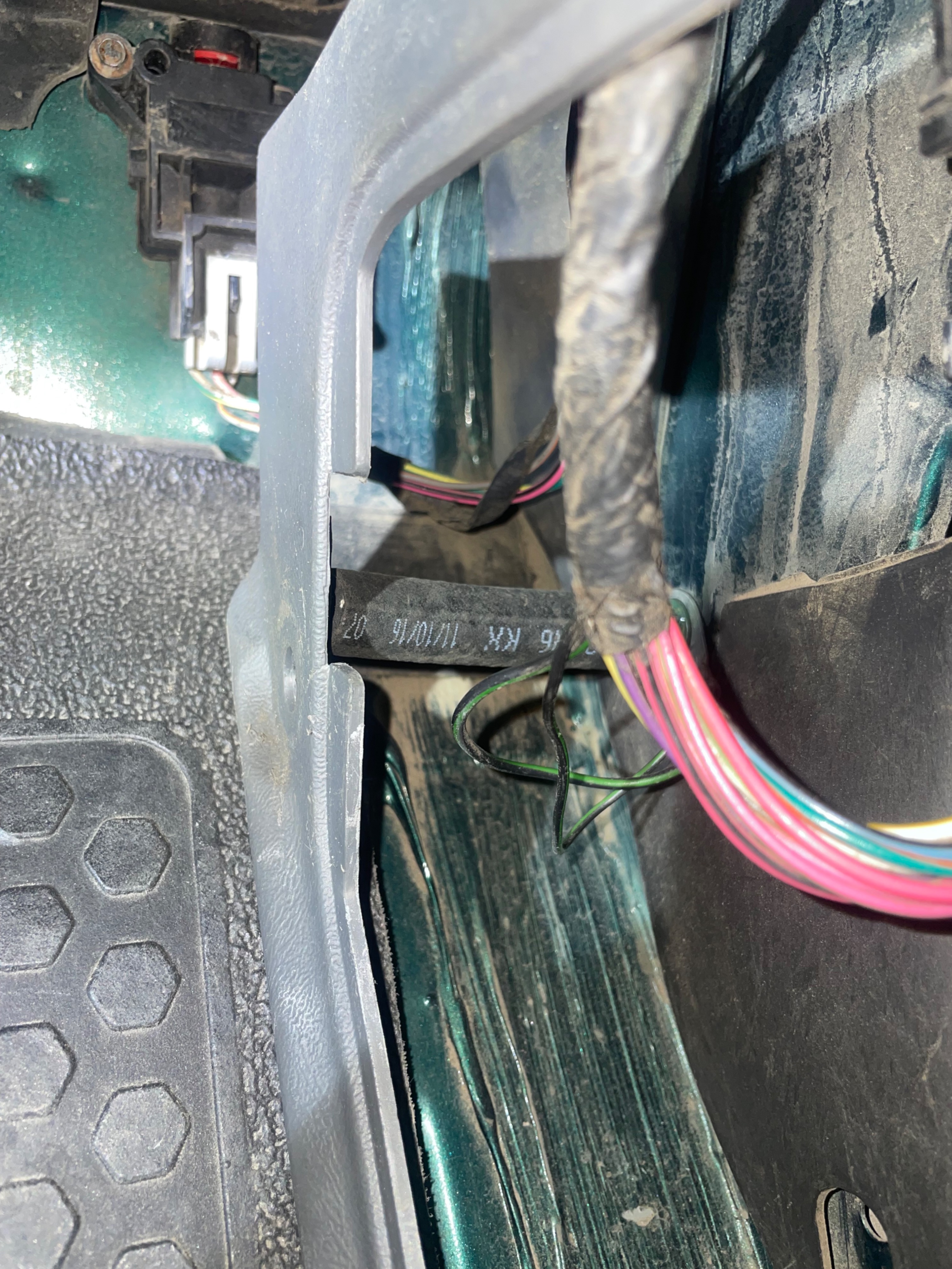

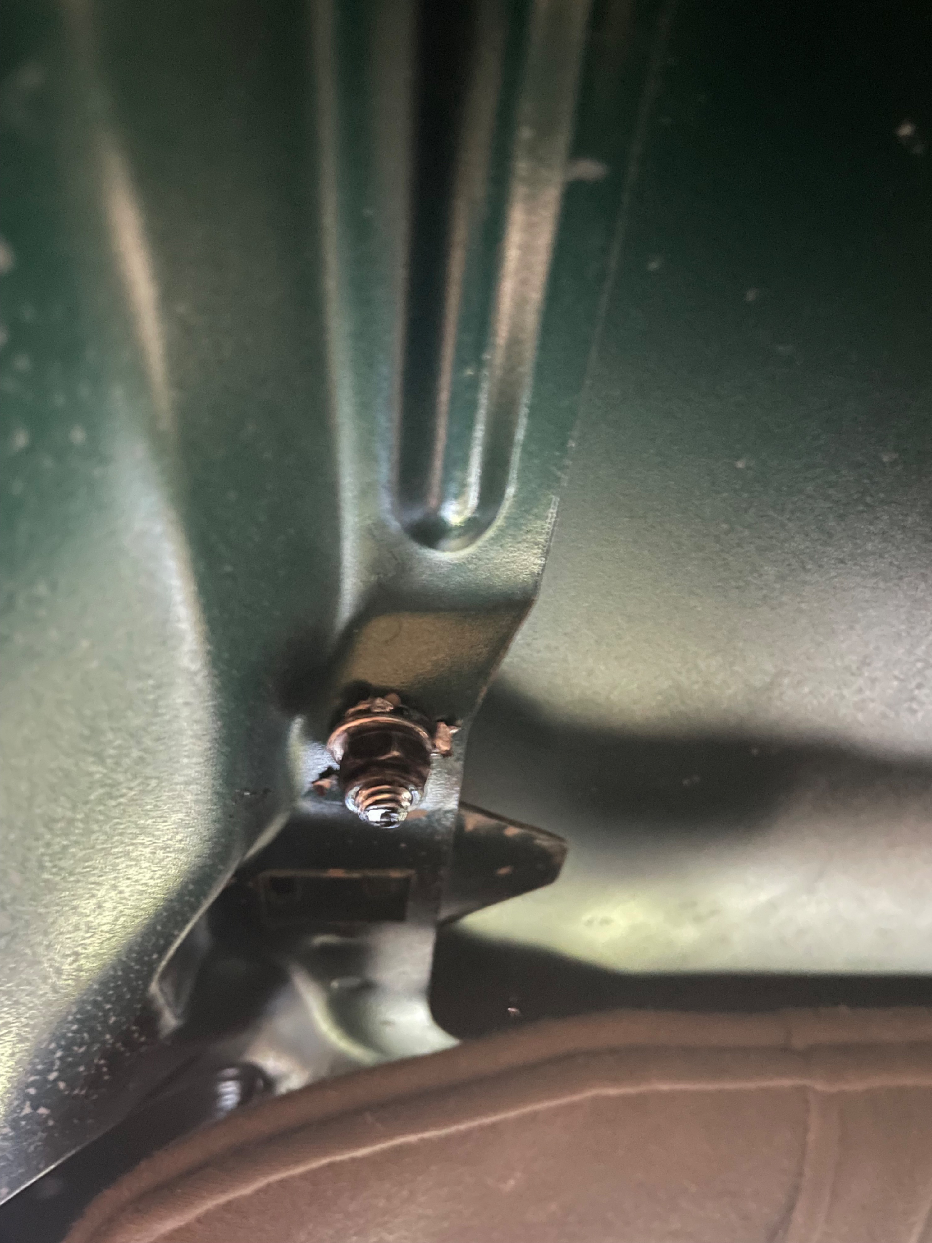

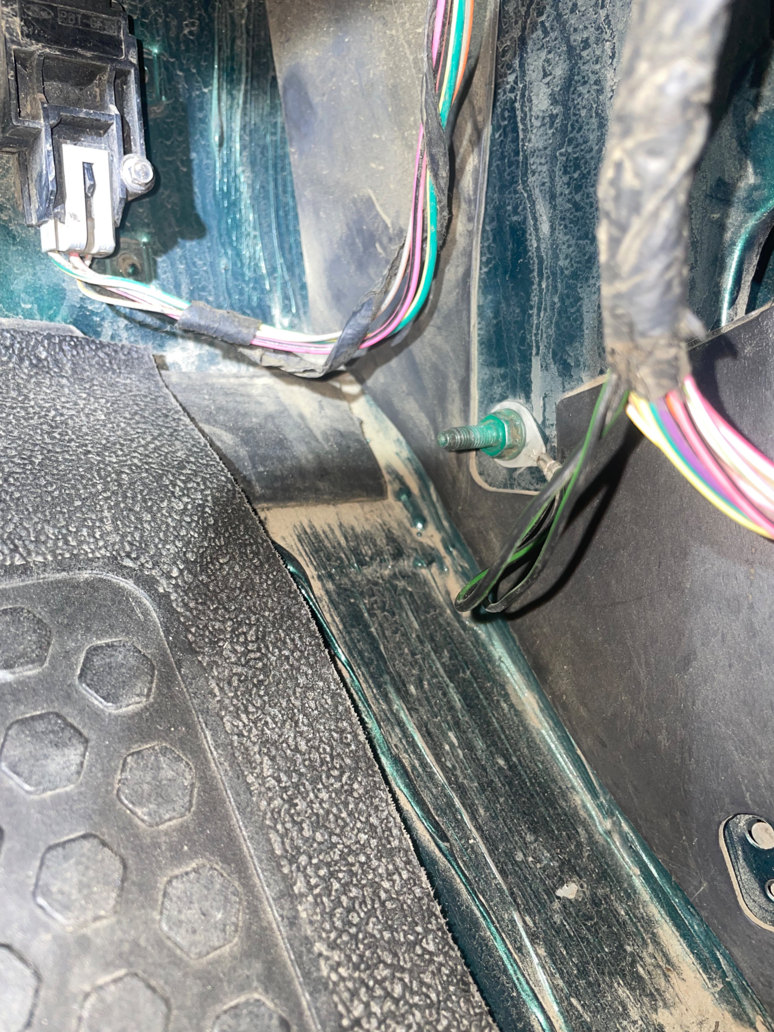

Next challenge is this passenger side
Kick panel. In 04+ trucks there is a fuse box underneath
So this kick panel has a 3” gap behind it with nothing to attach too
I got my brain turning and came up with a simple solution
I installed a double stud for the ground wire screw (green)
Then put a small piece of rubber hose on it followed by a slightly large piece, 3” long
Now the kick panel has a “standoff” to mount to …
Factory push pin used to secure it
Interior going in, each piece cleaned before install
2005 ranger wheel without cruise control installed. 04-05 airbags plug right into 98-03 trucks

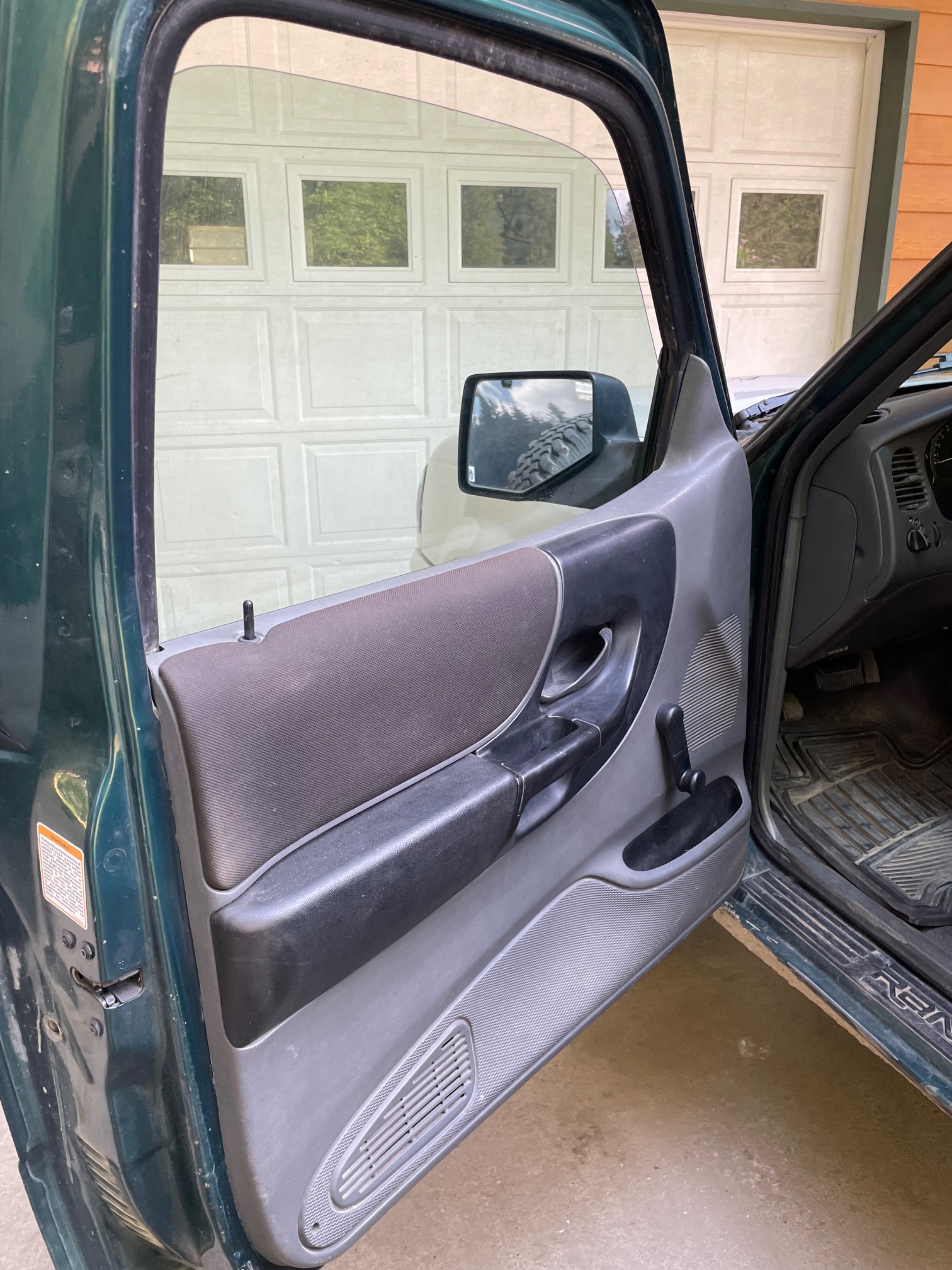

Door panels installed w window felts
Headliner and all trim installed

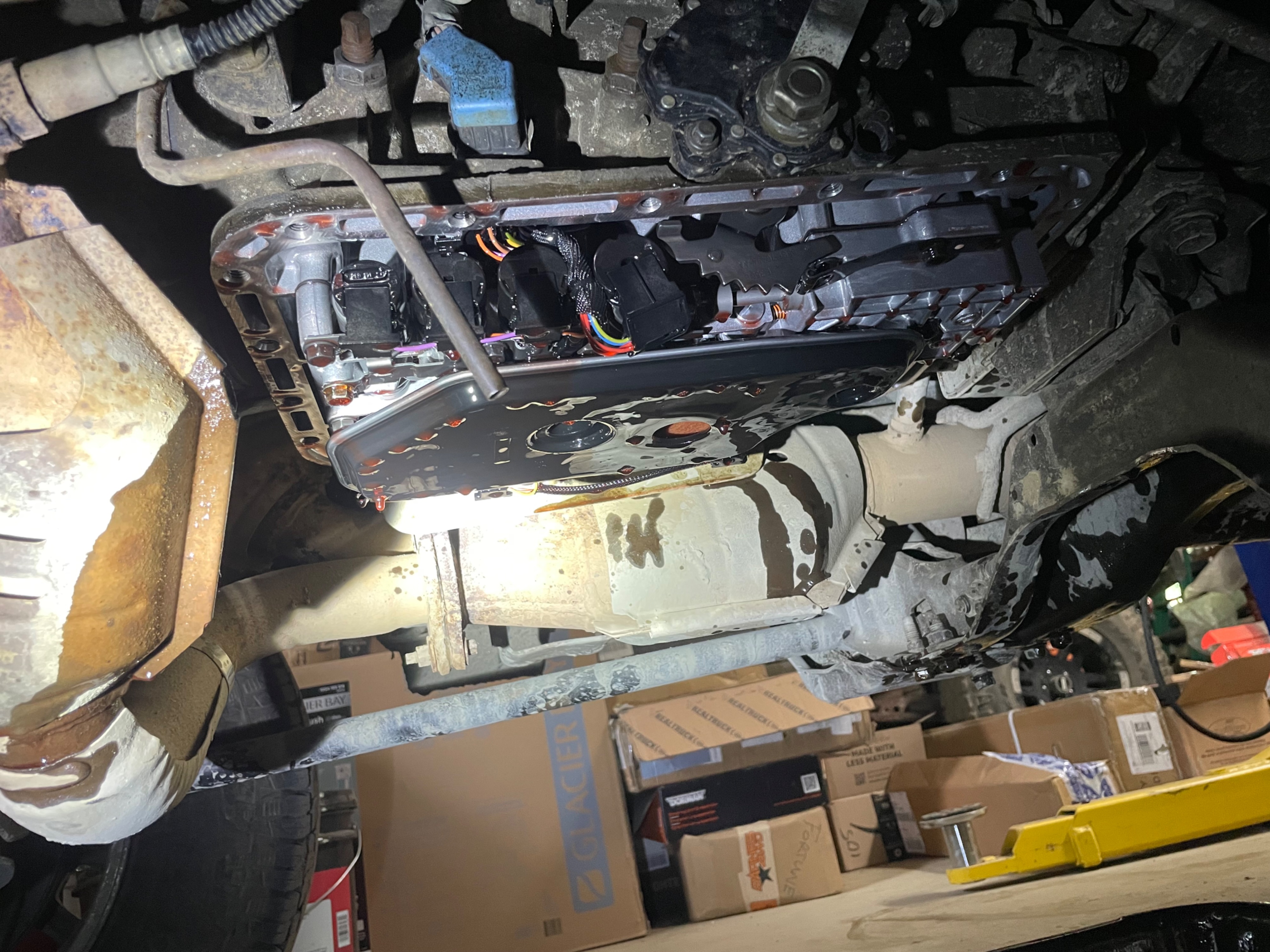

Let’s see if the vb bolts got loose or if the gaskets have any obvious leakage
Love the manual windows
So I’m a moron
Might want to revoke my license to wrench on things
I mean seriously
So this trans is from 04 with low miles, was a good trans before I messed with it. Now that I have it in this ranger and working it was having issues

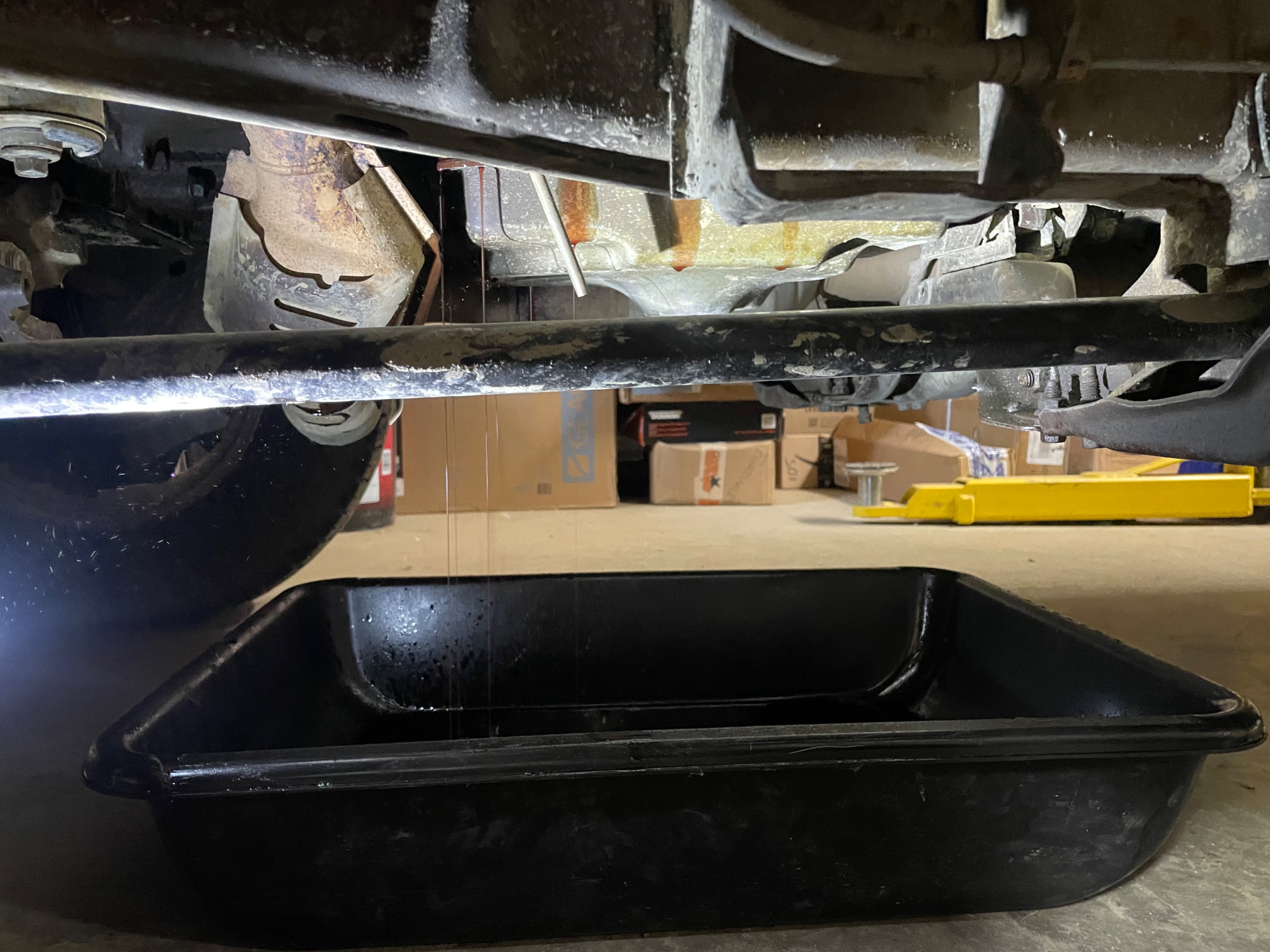

Dropping the pan
Love these $10 mortar mixing trays for drain pans

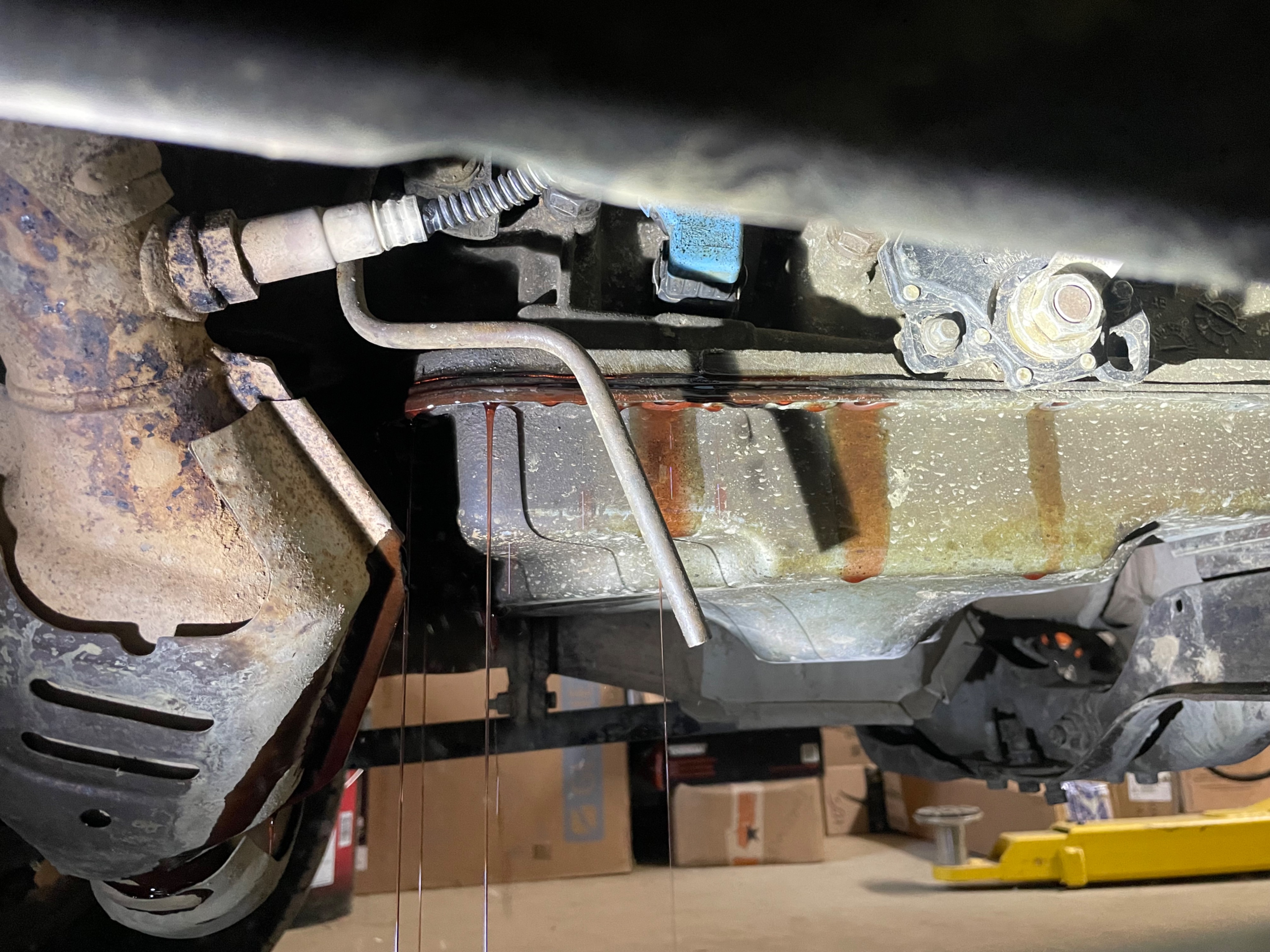

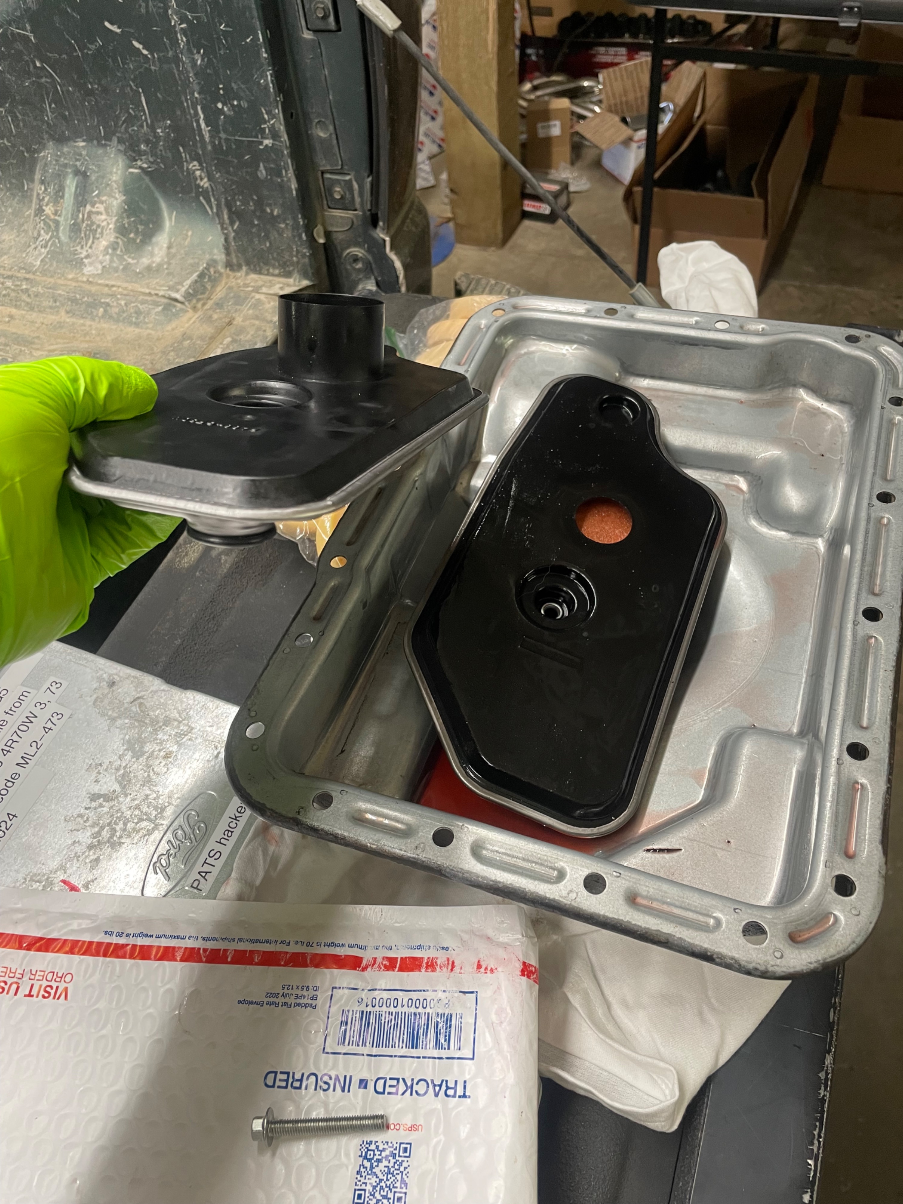

Sucker would shift perfectly for the most part until o got my foot into the throttle, like getting on highway… then after that very harsh shifts.. no codes, no flashing od light, very odd behavior! Usually 5r pretty easy to diagnose
What’s wrong with this picture?
Good news is easy fix
Bad news is I installed that filter and completely missed it… still in shock over this one
New Dorman pan w drain, new 4wd filter, new 6 quarts of Mercon v, and a bottle of lube guard … fixed. Moving on
Self rectal examination. Easy fix, happens to all of us.
