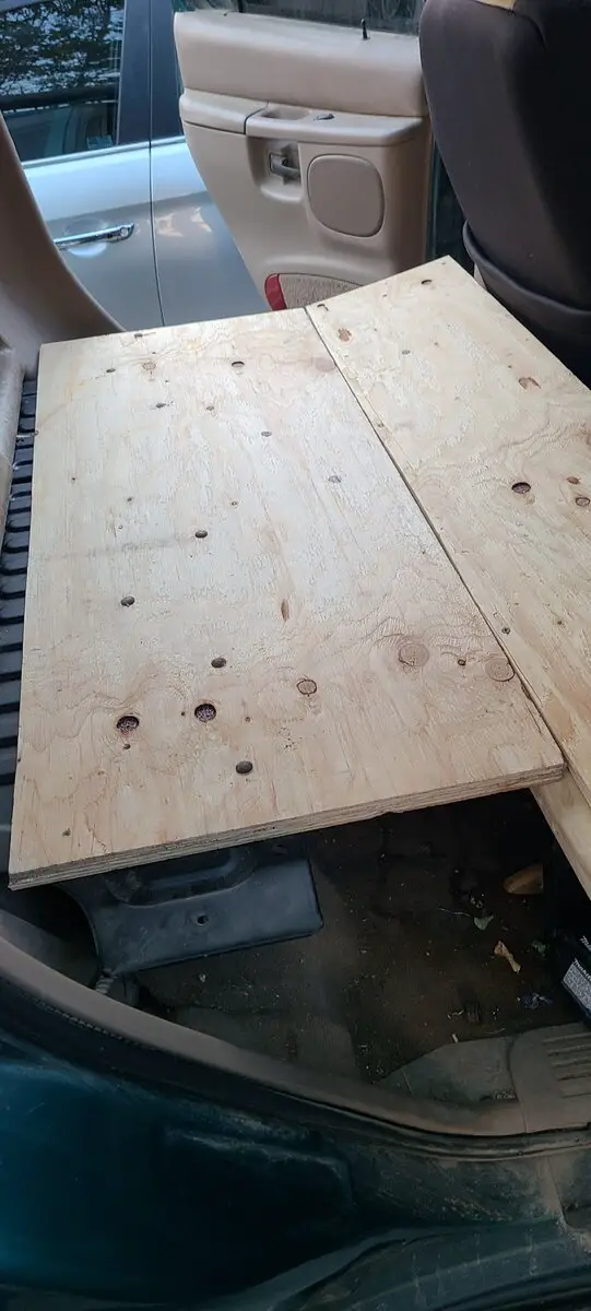

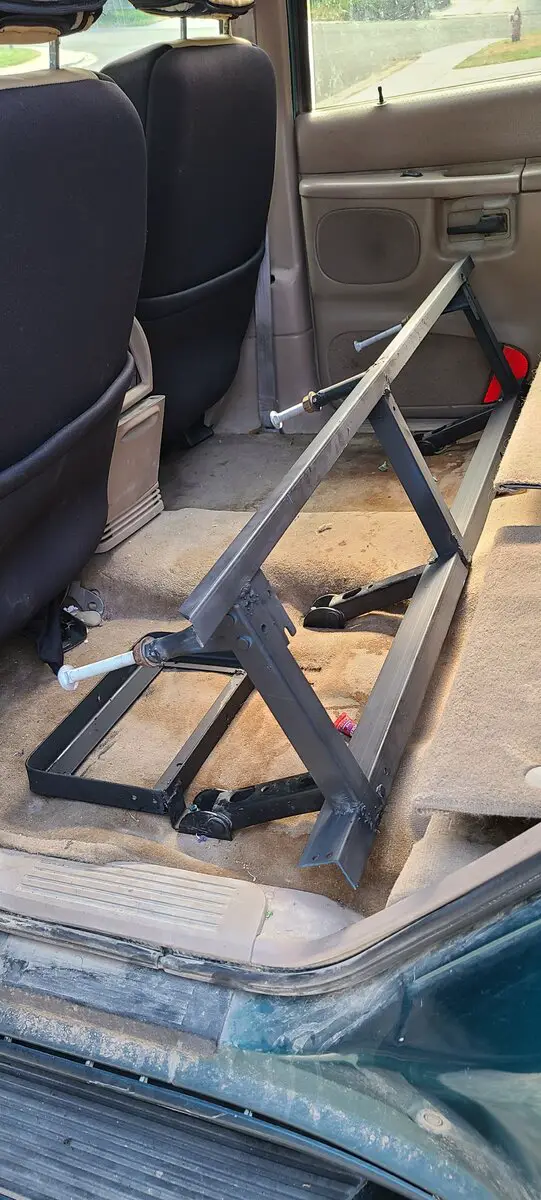

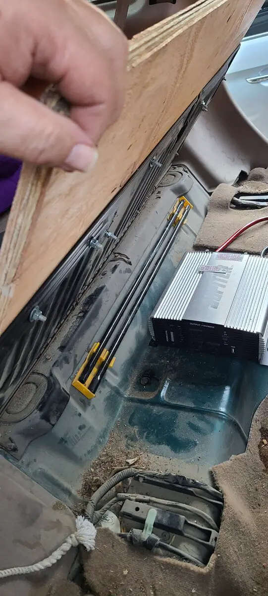

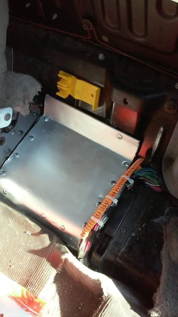

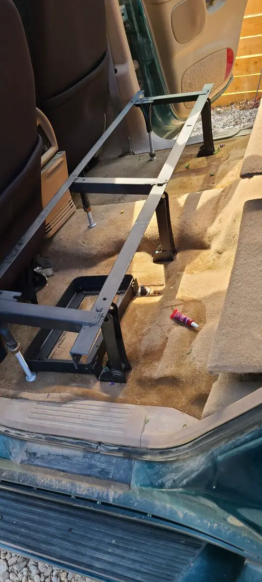

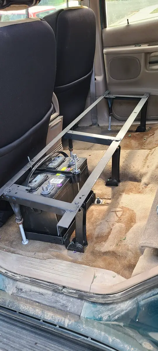

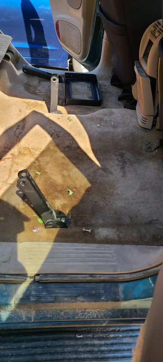

We've all seen the question.. "has anyone removed the back seat in a 2nd gen?" Then we get a bunch of pictures of where the seat used to be.. great. Now what?
What did you do with that space? Haul goats?
I needed the flat area to support my bed when camping and wanted the space below..
I now have the bed, another battery wired in, 2k amp inverter, spare cv's, axle tool, fire extinguisher, first aid kit...

Nice write up. I just set you up with a 3 month Elite Explorer membership for your effort.:chug:

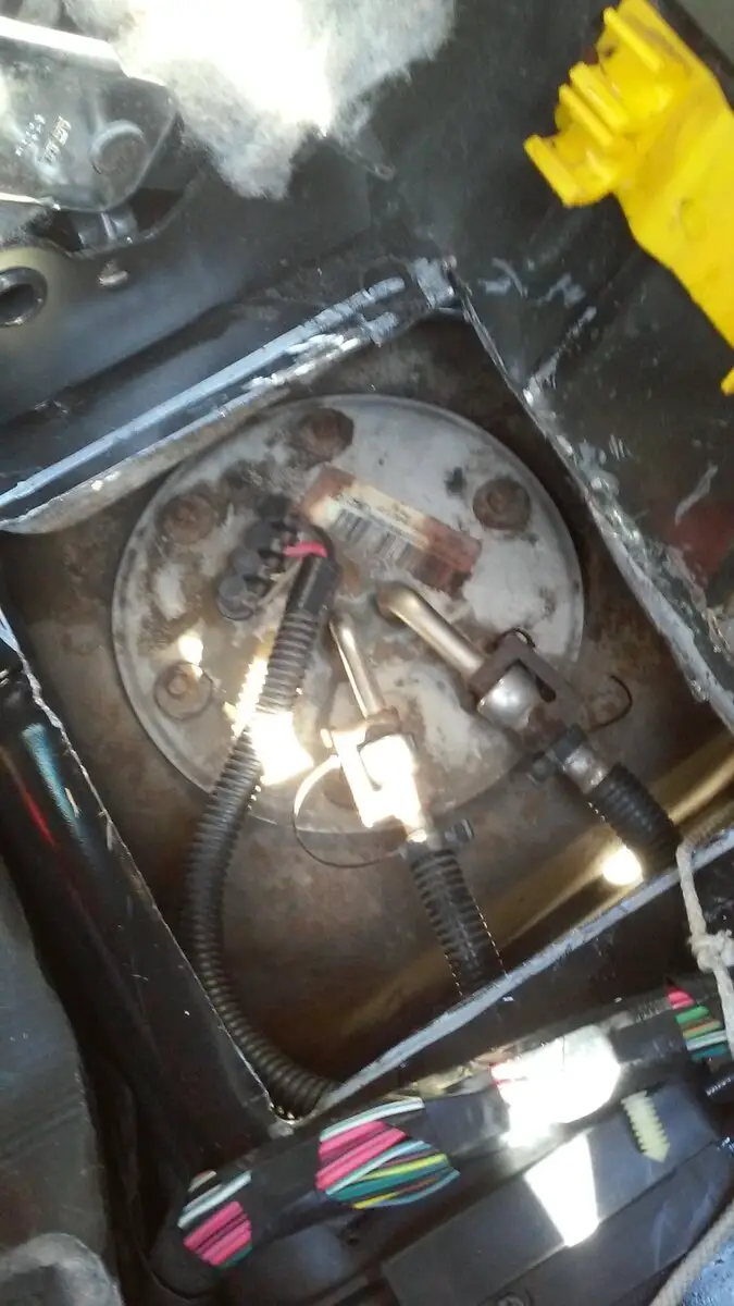

Now that you have the seat out of the way you need to make a fuel pump access....nudge that inverter over a bit...
ump access ... :oops:
Looks good, I dig the use of that space for getting out wheeling, camping, now overlanding................

Now back to your regularly scheduled thread. I dig the use of rear seat space for the extra battery, inverter, and there is quite a lot of storage there! I run a smaller inverter in my consul laptop or charger for other devices........... I recognize the use of the bed frame and have done so myself for projects and good use of the existing mounting points! Yes, I have been to a thrift store for a bed frame project. The slide-out in mine helped level the bed boards I placed up front as I laid them up over the original bed. I used a couple of ratchet tie downs to hold the front boards down with all the gear under them for safety.
Looking again, I like how you bolted to the existing hinged plates that were behind the seats. My boards drop-in and I removed those plates, your design is more cooler.

Love the frame that hinges - are these the original seat mounts modified? I haven't taken out the rear seat yet to see them. Hoping to get some camping in the Ex next year..
