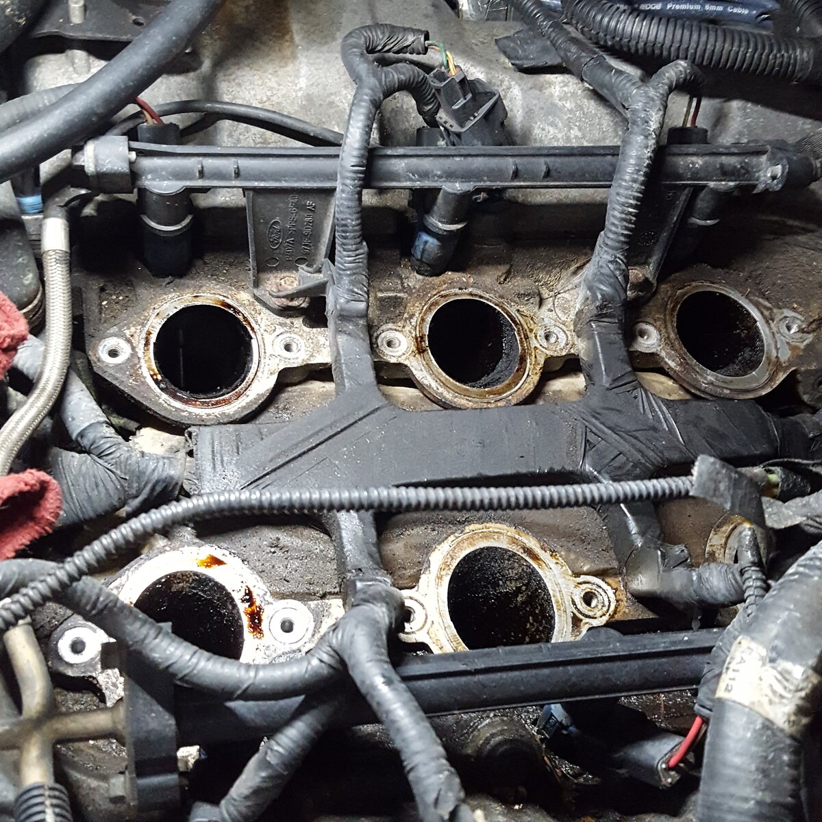

But, now I have ANOTHER problem...{surprised?}
I just got back from the shop that does my mechanical work. And I was supposed to have my PCV system fixed...
And THIS is what we found..
Where is the outflow from the SOHC engine? My TRUCK had its engine swapped, somewhere along the line.
Photo shows the plenum removed.
WHAT engine DO I have in my truck?
Any ideas?

Definitely a 4.0 SOHC. Somebody correct me if I am wrong, but I am fairly sure that is one without a fuel return system (EG 99-01)
On 98 SOHCs there is a small air tank (possibly an oil separator) that sits between the ports you see there, below the wiring harness. From there it goes to the PCV valve and then splits to 2 vacuum lines that go into the upper intake on the rear, pointing forward. Don't know if that is diffrent on the 99-01 engines.
The actual valve itself is a cylinder about 3/4" across and 2" long.
Your photo shows none of the PCV system. It is all out of frame. The oil seperator is likely in frame, but is buried so it's hard to say whether it is there or not..
Thank you for the photo. Did you notice the piece of foam material in the engine "valley"? Does the Oil sump placed under that? The harness above it seems to prevent its placement.
Any help with this situation would be greatly appreciated. Thank you again.

The oil pump and oil sump are on the bottom of the engine well below that.
I'm not sure about any foam. When I first pulled my intakes off there was a bit of a rat's nest in there, quite possibly literally. I just took and vacuumed out everything before working on it.
To get the harness out of the way you basically just start pulling connectors until it's loose enough to come free. In reality though you shouldn't need to take it off to see if it's there or not. Just poked around a bit and see if you feel it. It's pretty sizable it's not easy to miss.
You might want to just start your own new thread instead of continuing to sit on the bottom of this one. You'll actually get more people that can help you out that way.

Any idea WHY the foam is there in the 1st place? I believe I have a replacement engine in my truck.
The foam is to control engine sound / noise
