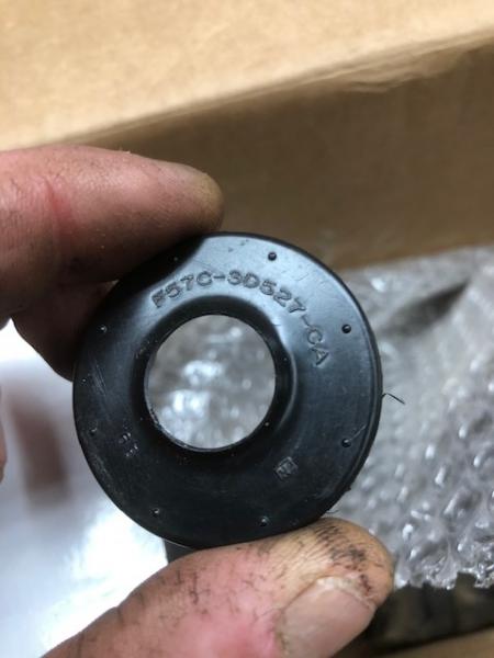

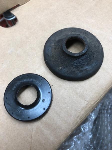

here is the dust seal in question in case anyone else needs to buy one, the part number is visible
Just got it in the mail today. Thanks again! That was exactly what I needed.
