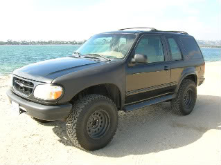

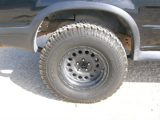

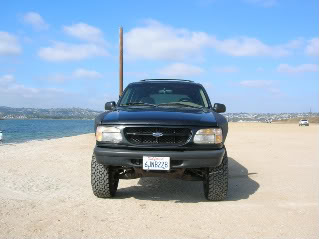

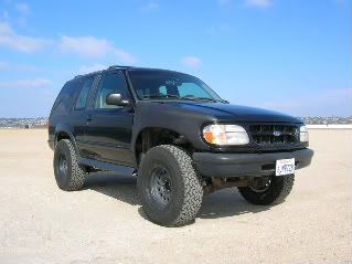

After getting my '98 Sport 4x4 a month ago and doing some research on this forum, I decided to break out the tools and start to make it my own. My plans were to fit some larger tires without lifting it too much. Eventually I'd like to turn it into a real prerunner. So far I've lifted the rear with F-150/4-door leaf packs, did a 1.5" TT up front, installed Fiberwerx fiberglass fenders, Bilsteins on the rear (soon to be up front), and some 285/75/16 BFG AT's on painted black alloys. I will be adding a prerunner front bumper and skid plate soon as well as a rear bumper with some sort of spare tire holder built into it.
