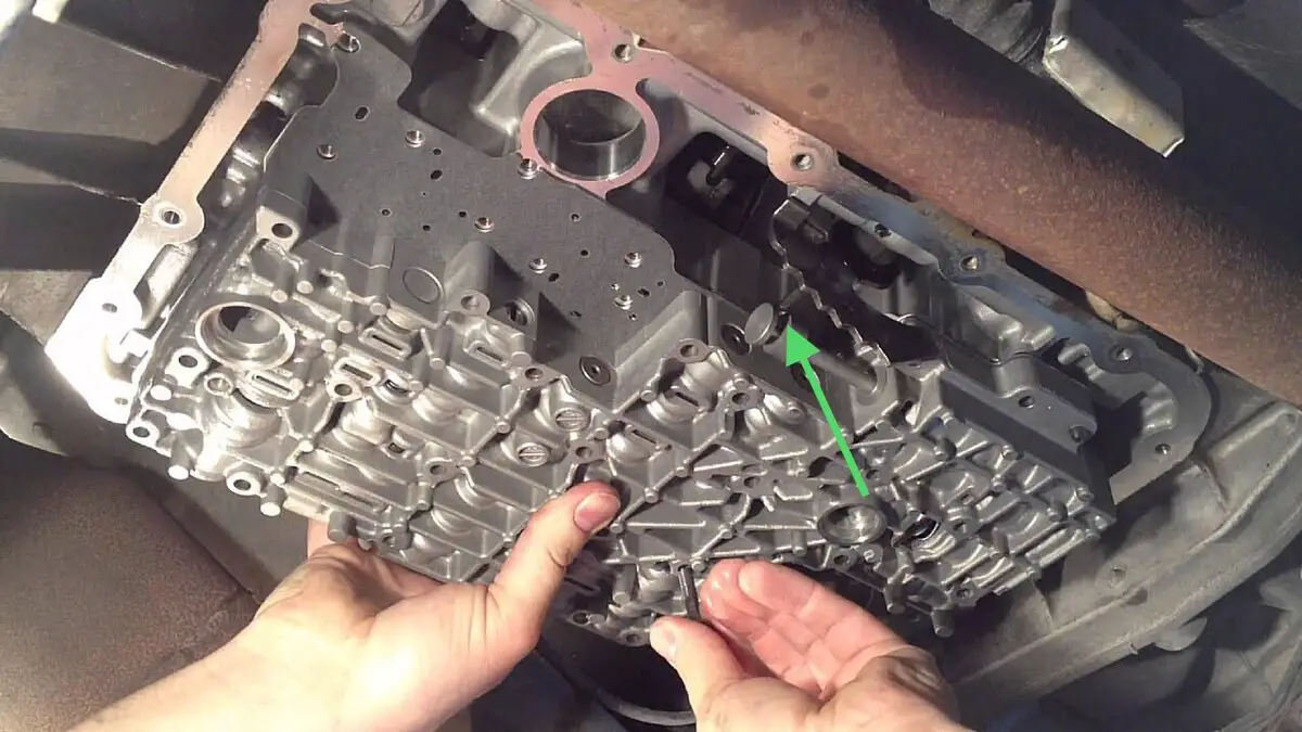

There is a disconnect between the exterior and interior valve selector. At least on my issue, when I reopened my rranny I found the interior rod to select which valve was opened was not connected to the ball joint that the exterior shift cable pulls on. I hope this helps.
thanks for info. did that solve your issue? is your transmission working normal now?
Yes, without the connection, it would never shift out of 1st gear. Nothing was pulling it into other gear positions. Once the connection was restored I could shift between all gears.
Can this repair to the shift lever from outer to inner be done with trans installed or need to be removed?
Transmission doesn’t need removed just VB drop. Sounds like the forward clutches are welded together.
