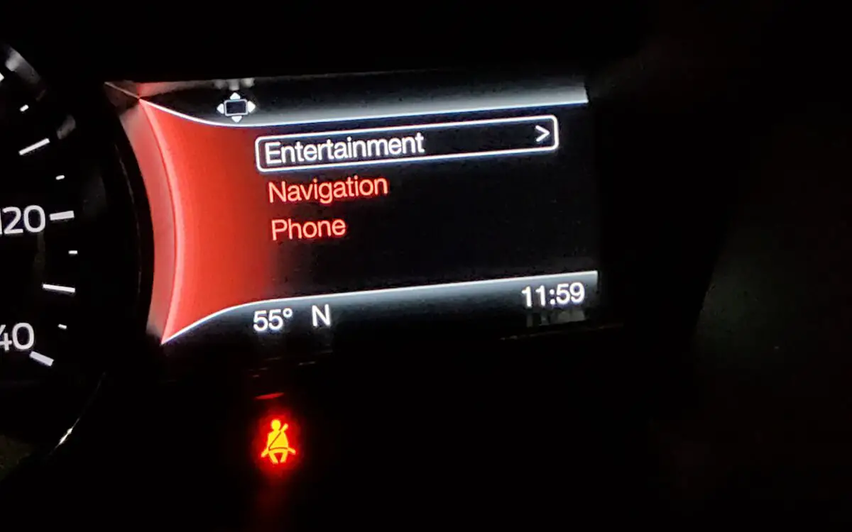

If you just want to disable low beams and keep the signature light on, simply disable DRL in IPC under "lighting".
I did get temp in the gauge display just can't figure how to disable low beams as drl & keep signature lights only.
If you're driving an American model, on the left side of your IPC there is a menu option under 'Lighting'. De-select Daytime Run Lights. This will keep signature lights on and low beams off when headlamps are set to auto during the daytime. Another way is to simply set your headlamps to off. Either way, you don't need Forscan.
if you're driving a Canadian model, there's a menu option for DRL that you need to enable in IPC first, then you should be able to disable it the same way as above.
