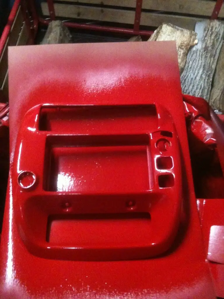

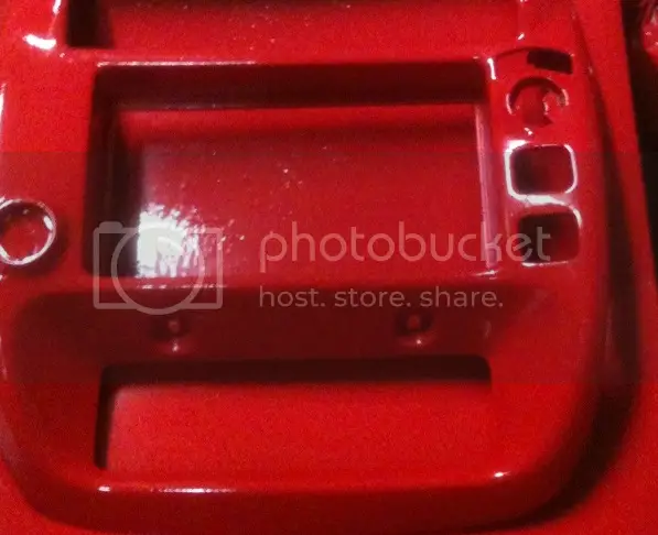

I got up a little late today but decided I still wanted to get something done on Red. I still had the black radio bezel that I switched out for a wood grain one and I had an idea forming in my head about what I wanted to do with it. With sandpaper in hand I attacked that awful rubber coating on the bezel. After nearly spraining something and getting nowhere fast, I remember reading on EF about using brake cleaner to remove the coating. And you know what? It works! It took me a couple of hours switching between a straight blade, sand paper and the brake cleaner to finally get most of it off. I then had my brother spray paint it for me. It'll take a little while to dry but I really like the results so far.

Dig the paint scheme. Dont remember reading about brake cleaner, nice tip!
I read it somewhere on here when I was researching painting the bezel. Thing is though it drys quick and you will need a full can or more. The key is getting the timing down between when it's fully penetrated the material and before it drys out. I did find that light surface cracks develop on the plastic using this method so a good primer could help fill those in.

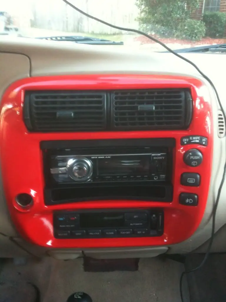

How red is it...Red enough where they can hear you coming red.
And it looks awesome in "Red" Bull. :D
