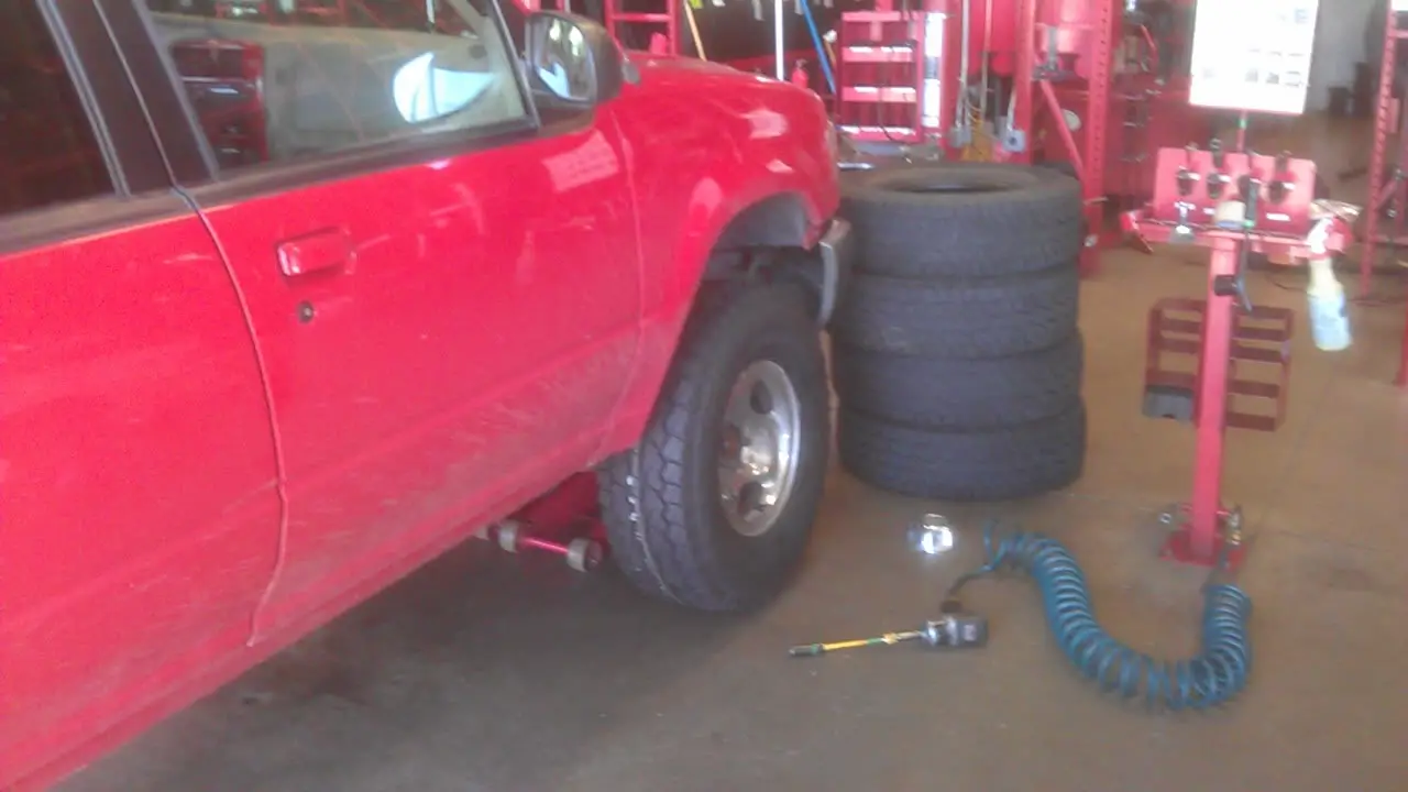

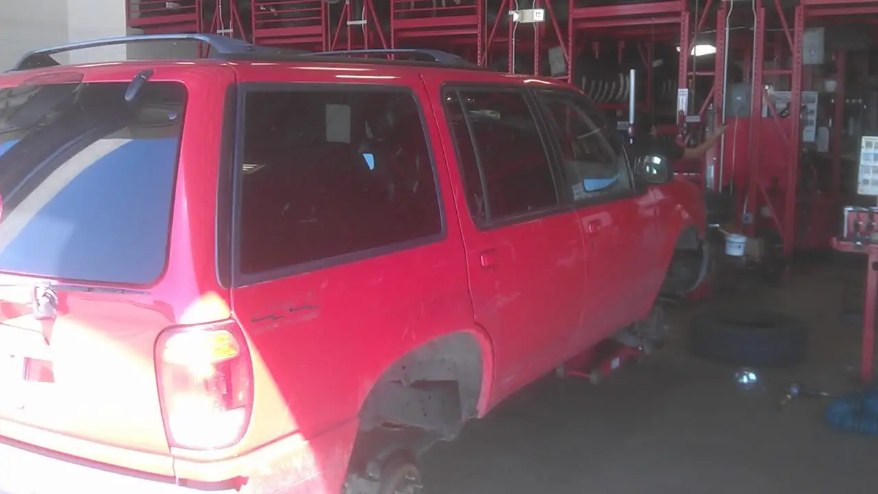

Anyways, this is the week I get the rest of the 33's and get them mounted. I am way excited about this!
And they are on!

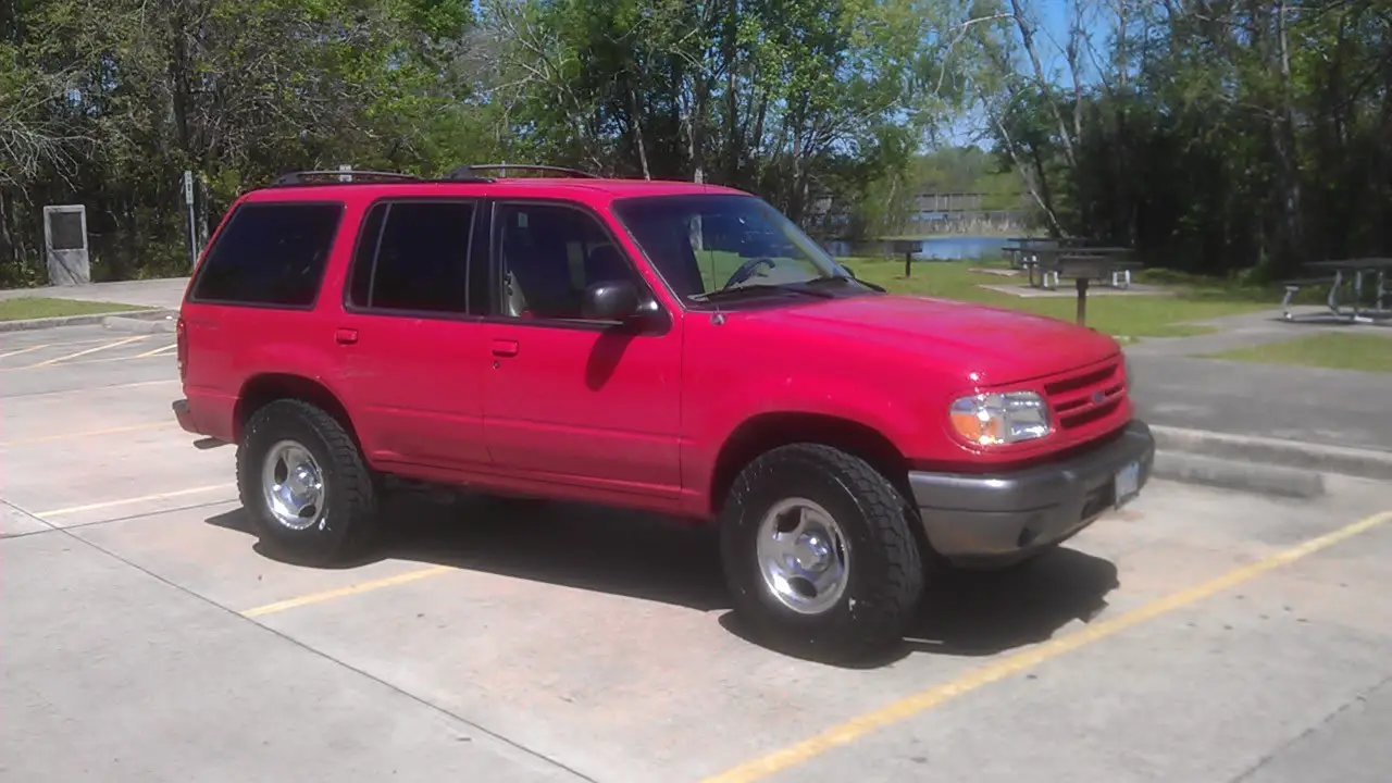

I had to do some minor bumper trimming, but all in all these are a great upgrade!
Looks nice.
Looks even Better!!
Thanks guys!

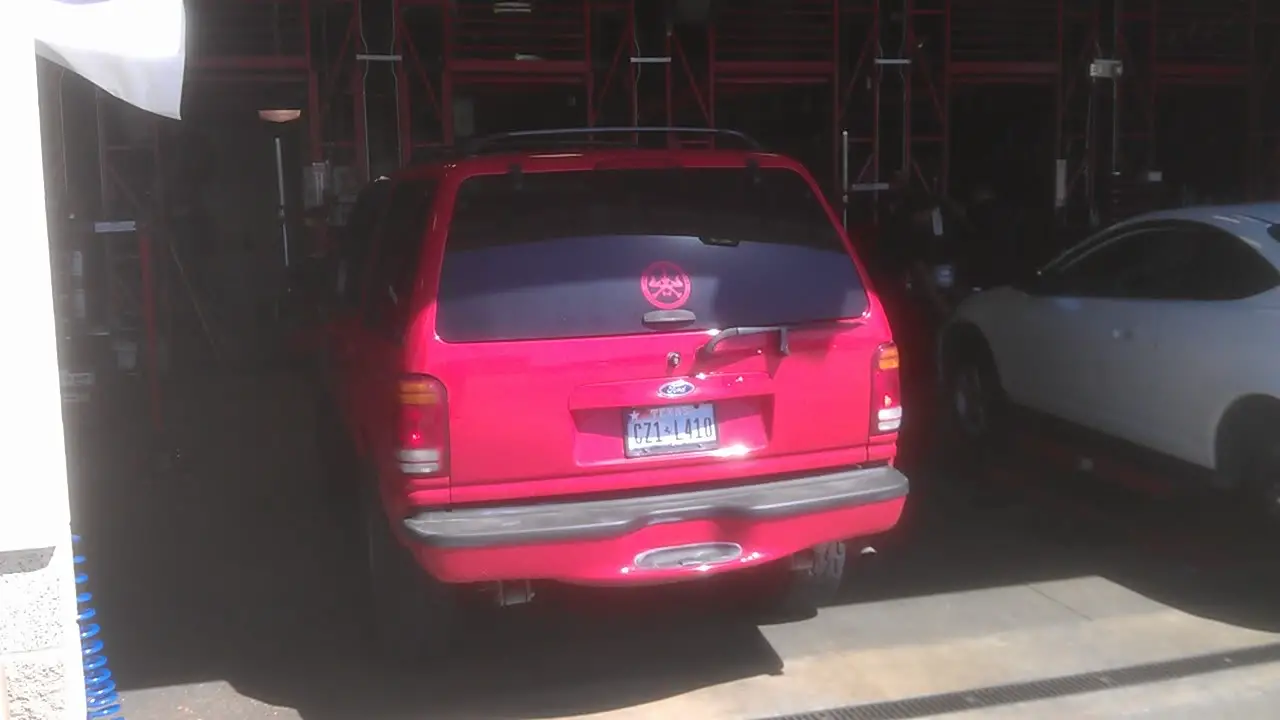

At Discount Tire I got many compliments on Red. The sales guy was asking what lift I had on it and what I was going to do with it and so forth. He said it was a "gnarly" rig and "one of a kind". I just nodded my head and laid down the specs. The pit boss was unsure about the tire fitment and to some extent so was I. So, I watched and waited outside the garage for a full hour while they worked on Red and once they got the first tire on the front I knew everything was going to be alright. :D

After driving on the new tires for a while I have noticed something that is not unexpected: my gas mileage has tanked (pardon the pun). Unfortunately, until Russell reprograms my computer for the new tires, I'm stuck guessing how bad it is, but I am pretty sure I'm getting about 12-13mpg in town. Part of the problem is my gearing, the other half is my lead foot :rolleyes:. I am now actively in search for an explorer with 4.10's to take so I can try and bring my gas mileage back up a bit. It is my daily driver after all. :)
We'll get it working bud! If yea can, do the chalk test to figure out the tire rev per mile to get the most accurate speedometer calibration
