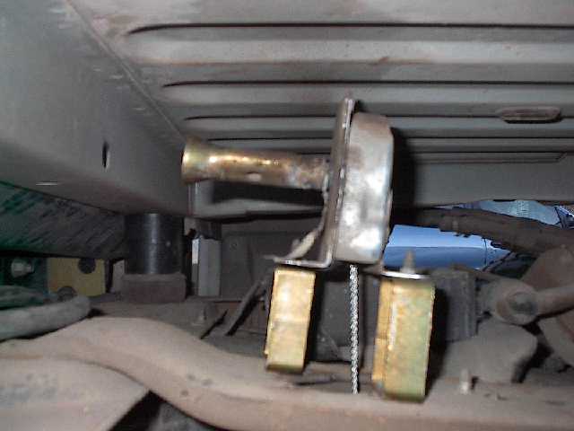

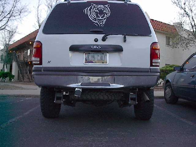

I recently installed the 3" Performance Accessories Body lift, kit #883. And as many other have found the spare tire winch is now unaccessible and must fine other ways of carrying a spare tire. I was about to throw away the extra parts from the kit, when it I realized that I could could use the overload support brackets from the body lift kit to raise the spare tire winch up 3", thus making it usable.
Here's what I did, grab two of the four left over support brackets from the kit. Drill a 3/8 inche hole through the center of the top and bottom of the brackets. Unbolt the winch from the vehicle and use the factory bolts to attach the two brackets to the bottom of the winch and reposition back on the vehicle. Use two 3/8x1 inche bolts with washers and nuts to attach the new brackets to the vehicle. Your done!!!
As with most lifts the goal is to fit larger tires, so this is only a tempory fix for use with tires 31s or smaller. I'll have to figure somthing else out when I get my 33s.
