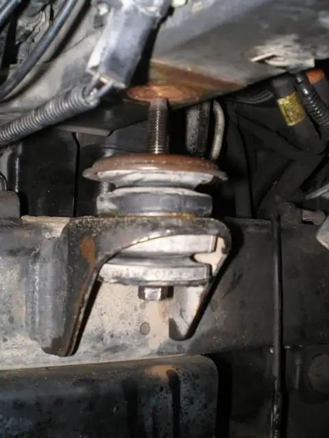

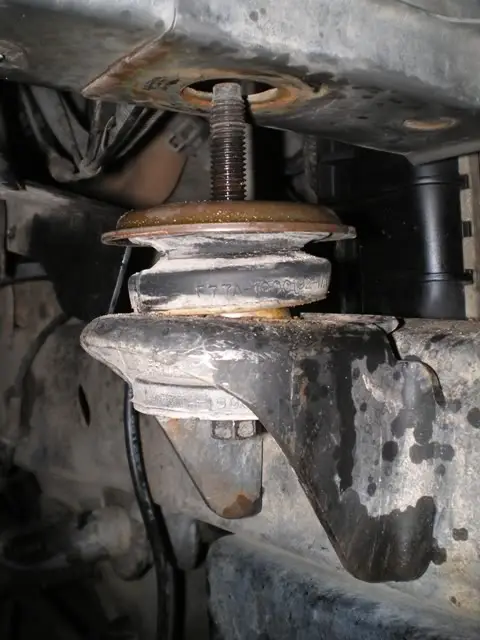

Hello everyone, bringing back a dead thread to see if I can't get some answers. I'm halfway done with this project as we speak and I've hit a couple roadblocks. I have 8 of 10 pucks in, just need to get the front two core mounts and I'll be ready to start torquing all 10 down.
The front two core mounts are assembled such that, from bottom-to-top, there is a bushing, frame, another bushing, and a washer that covers the top bushing, all stacked on the stock bolt. Here is a picture of the passenger side mount...
and the driver's side...
Obviously, the bolts have been removed from their body nuts found in the engine bay, but for whatever reason, the factory bolts (15mm) won't unscrew from the large washer that covers the top bushing. I tried using a strap type oil filter wrench, which actually held and gripped really well, but had no luck getting it to budge despite torquing both the strap wrench and the ratchet in opposite directions. If I could find a better way to vice the washer I could most likely put a lot more force into it however. Both bolts are soaking in PB Blaster right now. Only other solutions we've considered are angle grinding and/or taking a sawsall to it, which I'm not opposed to, but in the end I really need those bushings and the washer. Worst case scenario, how awful would it be to torque down the 8 that are in and take the vehicle somewhere where it could be more easily done like a shop?

Try and lower the body down, put a plate or something in between the body and the bolt and put pressure on the bottom of the bolt and then hold the washer and see what it does...
I can't lower the body again without taking out the 8 pucks that are already in. I'm gonna try taking an angle grinder to the hex nut part of the bolt tonight and hammering it out from the bottom.
Is it spinning on the existing mount? If so try grabbing the existing mount bushing with a pair of vice grips or something and try to use a impact gun on it.
Negative, it only appears to be locked on the washer that covers the top bushing. I tried gripping the top bushing with the strap wrench as well and the washer spun with the bolt
In the event that I end up destroying one or both bushings, what can I use in their place that I could easily find at the local Home Depot or Autozone? I can only work on this project at night after work and being anxious about this is starting to take up a lot of my time during the day.
Nevermind all... The bolts have been removed with an excessive amount of force. I'll post pictures later for people considering doing this project now, 7 years after it was originally done by the OP, but the bolts were rusted beyond recognition in the middle. Not sure if soaking the PB blaster helped, but we ended up vicing the top of the washer and the roof of the top bushing together, then putting a 4 foot pipe over a breaker bar and "rowing" a few times to get the ball rolling, then we let an impact wrench on it for a solid minute or so.

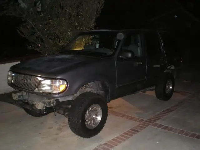

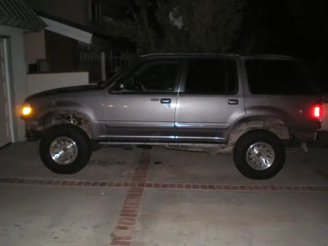

Just did this project again a second time on the new Ex. Much, much, much smoother/faster the second time around. I HIGHLY recommend buying, renting, or borrowing a powerful impact wrench to punish the factory mounts with (preferably compressed air; I used electric which worked great but steer clear of the cordless kind). For anyone considering doing this, I also highly advise keeping your sideskirts on until after the lift to see if you like the look, especially if you're going with the 3". Taking them off and then installing the lift leaves an ugly scar and exposes more of the post-lift undercarriage "gut". Not sure if that concerns anyone else, but I'll toss in a couple picture to show the difference...
1st Ex RIP
2nd Ex

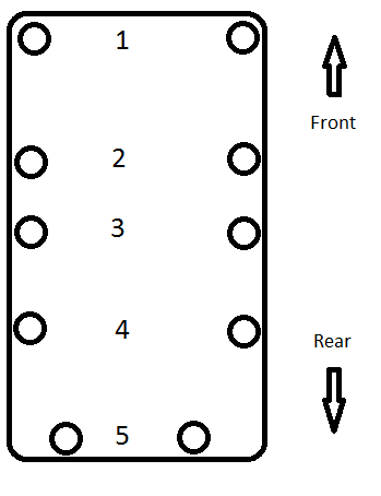

-When referring to different body mounts I use the following classification...
o 1 is located in the engine bay. You’ll need to hold these mounts in place from above to loosen them from below
o Remove interior plastic moldings. Carpet will need to be pushed out of the way for access to the remaining body mounts.
o 2 is located below the carpet where the front passenger’s/driver’s feet would rest.
o 3 is located below the front passenger/driver bucket seats
o 4 is located behind the bench seat after folding the bench over and lifting up the hinged flaps
o 5 is located towards the back of the cargo area closer to the middle of the vehicle from the corners
The 792 kit comes with 6 180mm bolts, 2 200mm bolts, and 2 220mm bolts. With that said, Passenger/Driver "3" needs a much smaller length bolt than the rest of the bunch. You can use the bolts that come with the kit (180mm's) for only the front mounts ("1") and for "5". Other than that every bolt is entirely too long and you'll need to buy your own. The thread pattern is an M12-1.75, and I recommend picking up a couple 100mm's, a couple 120mm's, and a couple 140mm's. Unless I'm mistaken "4" can use the 140's, "2" uses the 120's (or you can re-use the factory carriage bolts from "5"), and you'll want the 100's for "3". Bear in mind that I'm only recommending 100mm's for 3 because I have a 120mm in it right now and it's still just barely too long by a few hairs; if the 100 is too short I'd still rather not use every thread in the mount and actually have pressure on the body than have a bolt that's too long and not really doing anything because it bottomed out.
