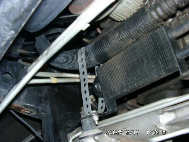

On the Sport Trac's the other thing to watch out for is that after the body lift the A/C line that goes underneath the front of the engine comes really close to the harmonic balancer.
Here's what I did to keep my A/C line from being eaten by the harmonic balancer after the body lift.
