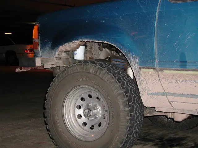

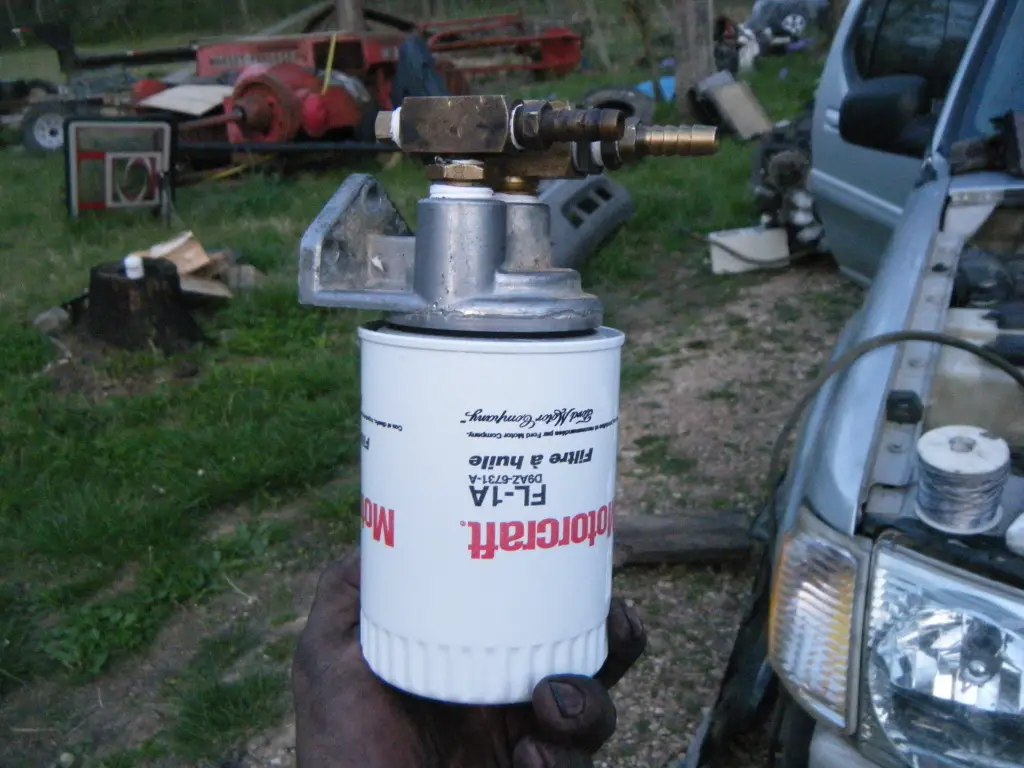

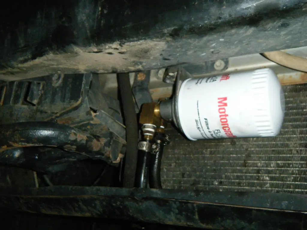

Yep, bought a hydraulic filter head that takes a common oil filter. Mounted it next to the coolant overflow reservoir. Used rubber lines from barbed fittings then copper tubing to the cooler. I have two stacked plate style transmission coolers, in series. I didn't think it would matter if you put the filter before or after the cooler(s) but I guess it would flow easier through the filter when hot... up to you.
