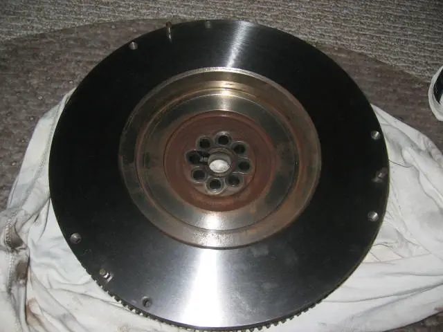

Does this need to be resurfaced? I don't feel any ridges, the only thing i can feel is the change in texture as i move my finger over the contact part onto the part thats not touching anything...

i would get that resurfaced
What makes you say that? How can I tell? What kind of shops will do it, probably only a tranny shop or can just about any shop?
any good shop will. Ay time you change a clutch its always a good idea to get it done. It wont cost much and it could save that new clutch from burning up quick. Do you have an impact? Those 8 bolts will be a PITA if you dont
You should resurface! It rids any burned spots and makes a clean mating surface. Just like turning rotors to maximise stopping power, resurface a flyweel everytime you replace a clutch. It should be close to $20.00 at a machine shop. It will let you know if you flywheel is within tolerances as well. What if you have hairline cracks from overheating throughout your flywheel and it decinegrated while driving! Just a worst case scenario!
nah all i have is a 18" breaker bar... im going to have to look for a 6 point starred socket then to for those unusual heads...
Have that resurfaced, there is NO excuse, it only costs about $20, and will create a new surface for the clutch disc to set with.

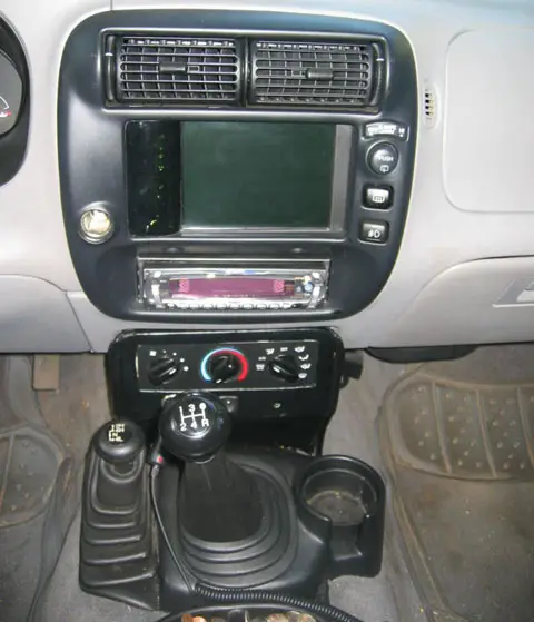

Sure would like to see pictures of your dash and console arrangement, seen the A/C control knobs have been relocated, would just like to see why and what the rest of the dash looks like.

SVO said:
Sure would like to see pictures of your dash and console arrangement, seen the A/C control knobs have been relocated, would just like to see why and what the rest of the dash looks like. Thanx. Jeff - :navajo:
haha, that was a whole other project... i used a really small motherboard and built my own center console to house the whole computer, dvd, 20gb hdd, RF remote receiver... then replaced the factory cdplayer location with a 6.5inch LCD, then put an aftermarket cd player where the heating controls were and removed the ashtray and bottom panel and built the panel you see here to hold the heat controls, 12v outlet, power switch and power LED. I run crux linux on it all for customizability and speed.
theres a ton more pictures here: http://65.96.84.214/old/explorer.html
heres some older pictures but the console is still the same.. http://65.96.84.214/old/pictures/04-03-2003/images.html

the freshly resurfaced flywheel, now i see why everyone said to get this done, it looks like brand new afterwards:

Excellant work as always Nick... I'm betting you're glad you resurface the flywheel; it looks clean enought to eat off of.
