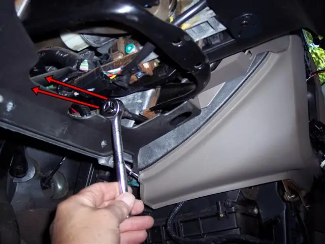

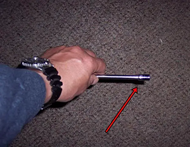

Nicely done. :D:thumbsup: Glad I could help out. I would recommend putting the top screw back in. I don't know if it will have any adverse effects or not. Here is how I got the top screw in, this is from the write-up:
7.i. Install top screw – 8MM socket & 6” extension required
7.j. Tape screw to socket
7.k. Start threading screw
7.l. Pull extension out
7.m. Reach up and remove socket - Arrows indicate where to reach up to remove socket from screw
7.n. Remove tape and replace socket
7.o. Tighten top screw – DO NOT OVER TIGHTEN
Good luck.
