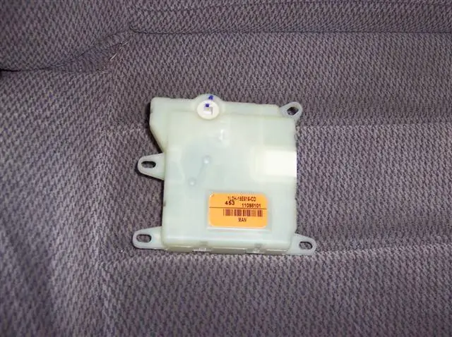

This is my how to for replacing the blend door actuator on the 3rd Gen Ex. The Blend Door Actuator controls the hot/cold temperature in the vehicle, not where the air is blowing from or fresh air/recirculated air. While researching this issue I found several discussions, but no definitive how to. I used this post as a guide: 3rd gen Explorer Blend Door Actuator Replacement. Even with this excellent post by ColdnFrosty, I was “flying blind”. That has lead us to this write up.
I purchased the Blend Door Actuator from my Ford Dealer. Cost was $70.00.
I recommend purchasing it at the dealer as others have had problems with the ones purchased at auto parts stores.
VIN is required to ensure you get the proper part.

1. Blend Door Actuator

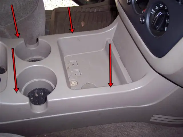

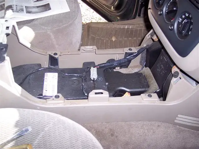

1. Remove Center Console Upper Half
1.a. Remove rubber mat
1.b. Remove screw under mat – 7MM socket required
1.c. Pry from rear and pull out console upper half
1.d. Disconnect front power point connector & extra power source connector (Cigarette Lighter?)
1.e. View with upper half removed

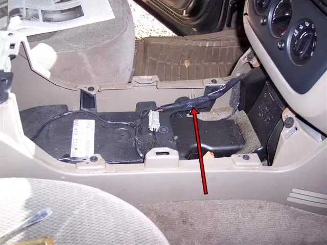

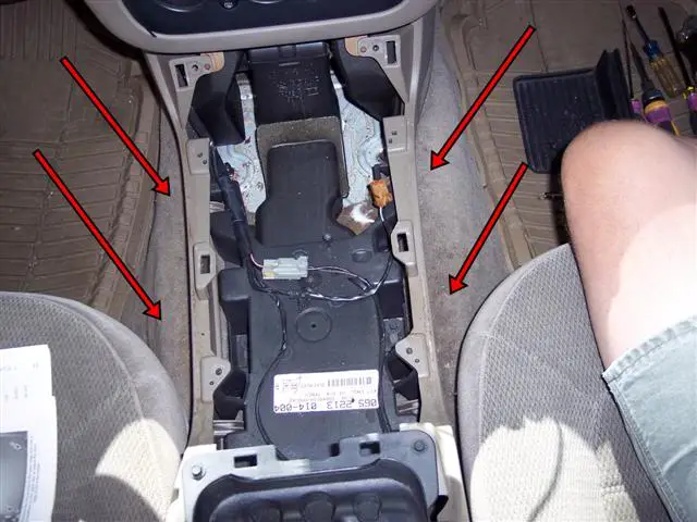

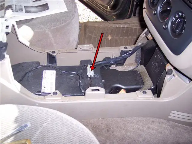

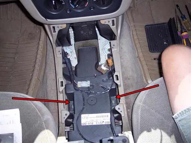

2. Remove Center Console Lower Half

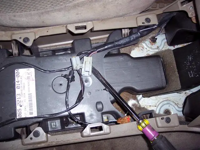

2.a. Disconnect rear power point connector
2.b. Pop off rear power point connector with screwdriver – be careful not to damage connector
2.c. Pop off harness with screwdriver – be careful not to damage any wires
2.d. Remove 2 front screws – 8MM socket required
2.e. Remove 2 duct screws – 8MM socket required
2.f. 4 top screws remain in place

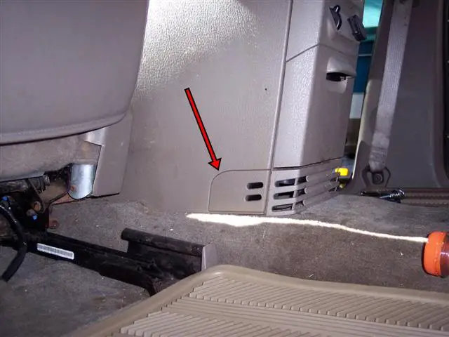

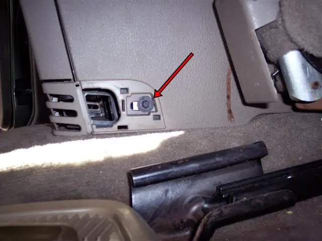

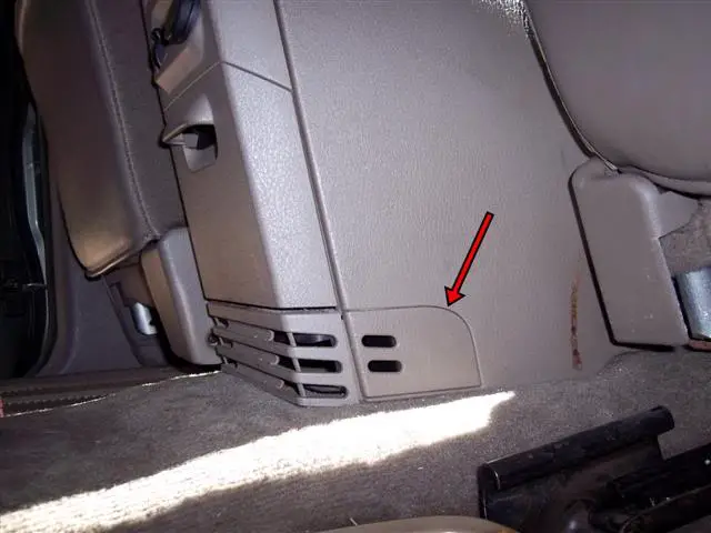

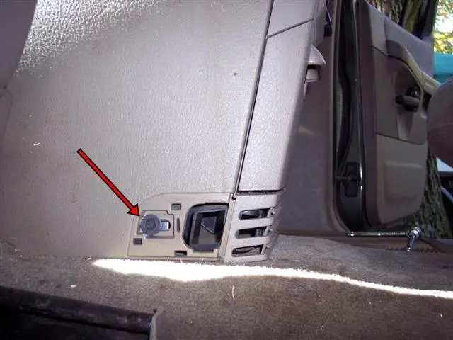

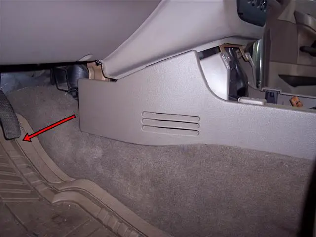

2.g. Remove passenger side rear screw cover – butter knife or putty knife required
2.h. Remove passenger side rear screw – 8MM socket required
2.i. Remove driver side rear screw cover – butter knife or putty knife required
2.l. Remove driver side rear screw – 8MM socket required
2.j. Pull passenger side front of console away from center and toward door to disengage velcro
2.k. Pull driver side front of console away from center and toward door to disengage velcro
2.l. Lift console lower half up and out of vehicle

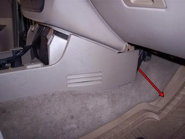

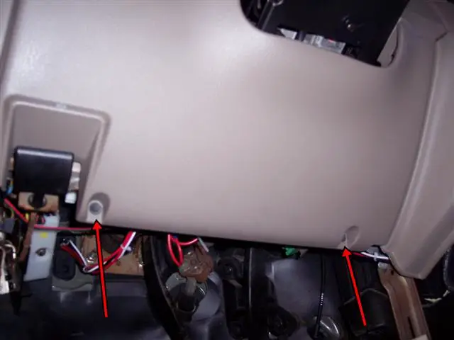

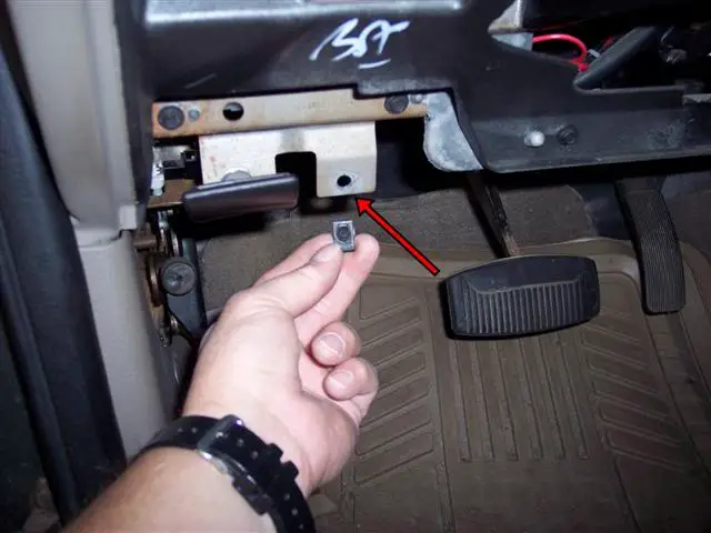

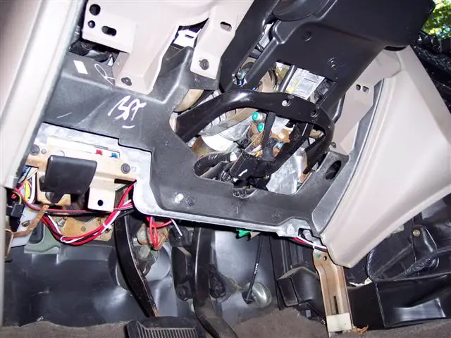

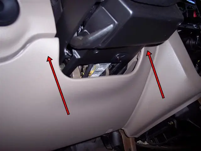

3. Remove Lower Dash Panel
3.a. Remove 2 bottom screws – 7MM socket required
3.b. Pull from top
3.c. Clip may come off - No worries it can be put back when panel is reinstalled
3.d. View with panel removed

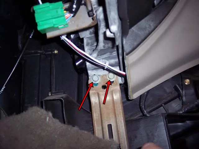

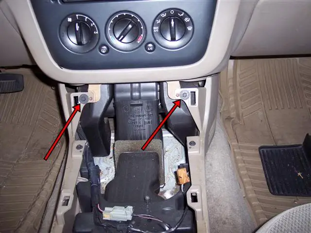

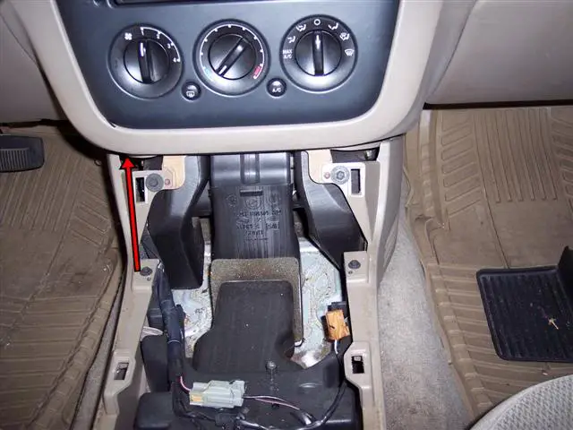

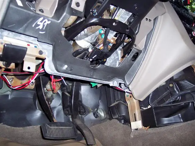

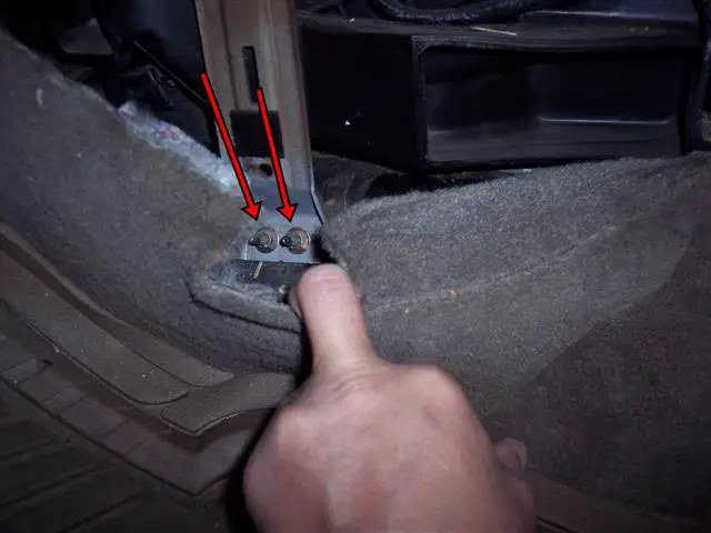

4. Remove Dashboard Brace

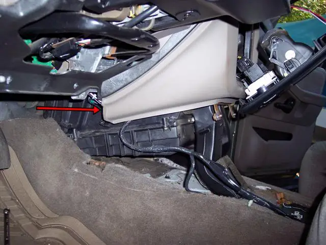

4.a. View of dashboard brace
4.a. Remove top screws – 10MM socket required

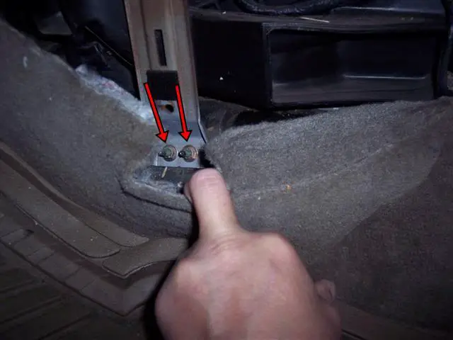

4.b. Remove bottom nuts – 10MM deep socket required - Pull carpet back to reveal bottom nuts
4.c. View with brace removed

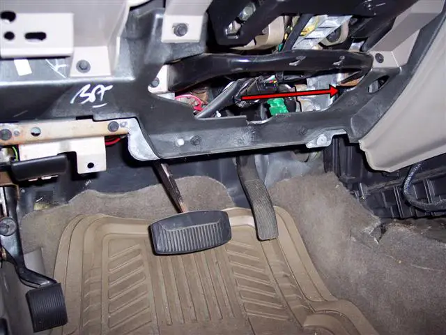

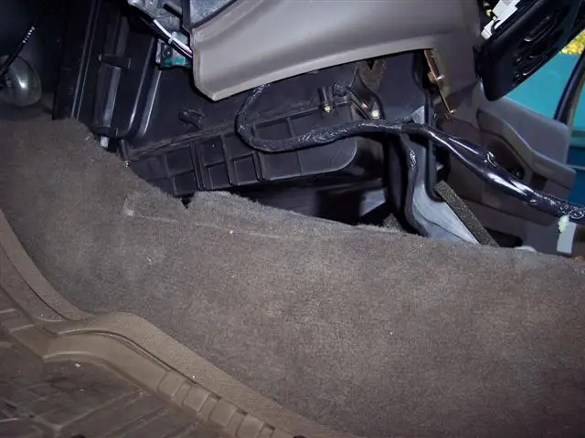

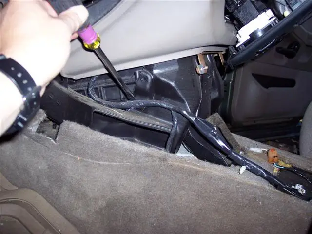

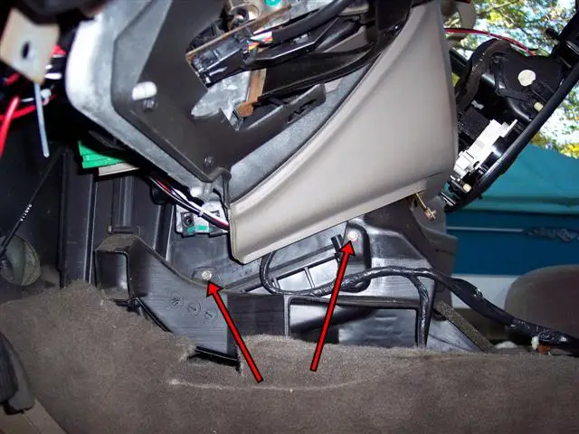

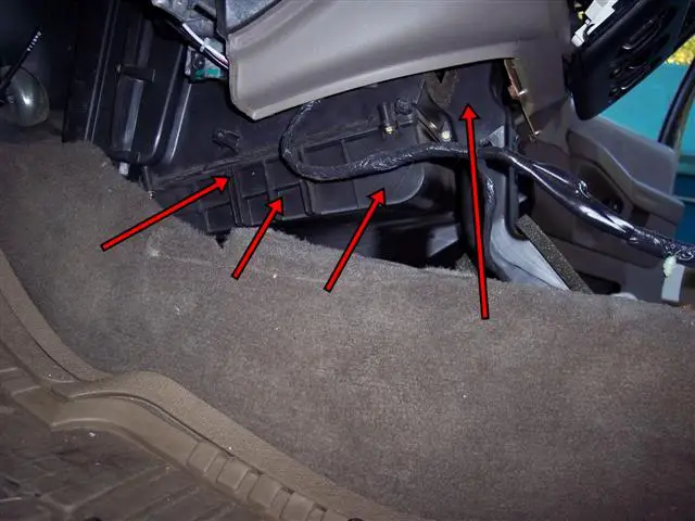

5. Remove Lower Heater Duct

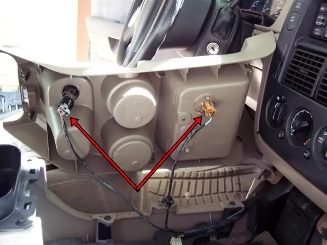

5.a. Pop off harness with screwdriver – be careful not to damage any wires
5.b. Remove 2 screws – 8MM socket required
5.c. Wiggle duct out – it seems like it won’t come out but it will – pull front of it down

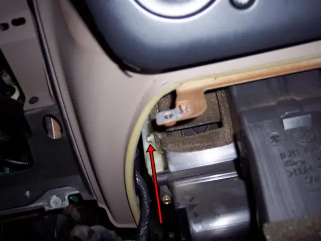

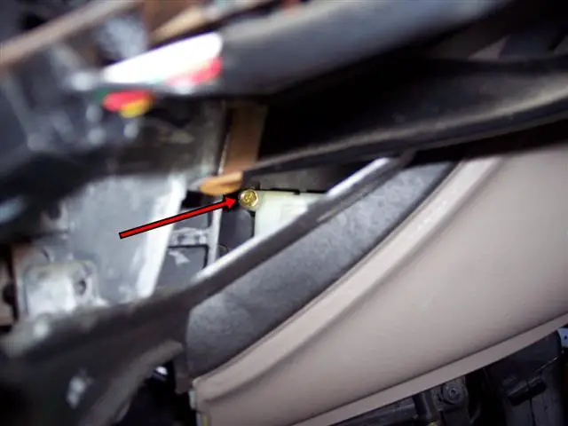

6.a. Locate top screw - Arrow indicates area to look for top screw
6.b. View of top screw

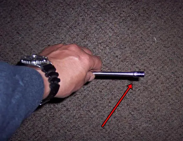

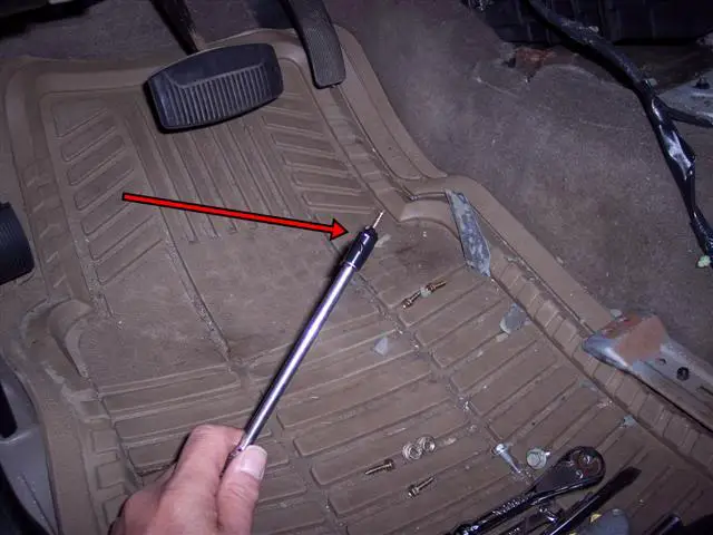

6.c. Remove top screw – 8MM socket & 6” extension required - Picture shows how to access top screw

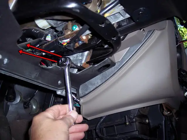

6.d. Locate bottom rear screw - Arrow indicates area to look for bottom rear screw
6.e. View of rear screw
6.f. Remove rear screw – 8MM box-end wrench required - Ratcheting box-end wrench will be easier but not required

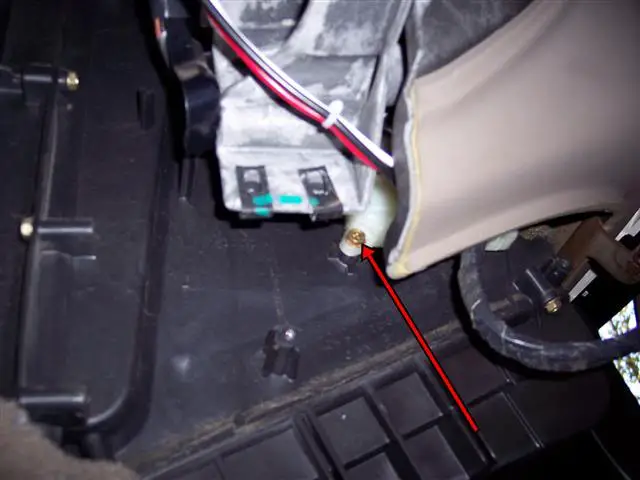

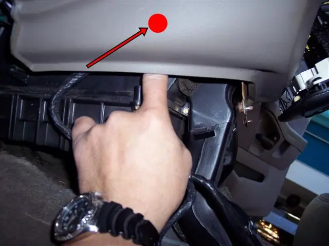

6.g.1. Locate bottom front screw - Arrow indicates area to look for bottom front screw
6.g.2. Locate bottom front screw - Red dot indicates approximate area of bottom front screw
6.h. View of bottom front screw

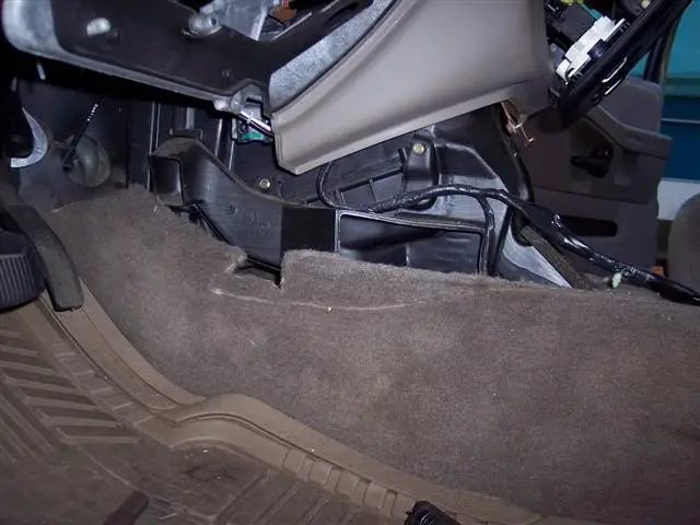

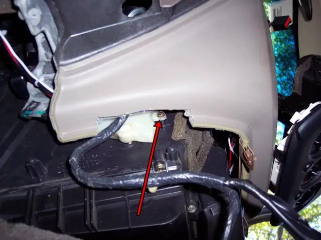

The following steps involve cutting the dash. Some have removed the old actuator and replaced the new one without cutting the dash. I recommend trying without cutting the dash and only cut the dash if the actuator cannot be removed and replaced with the dash intact.

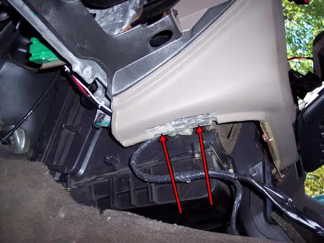

6.i. Cut dash – Utility knife required – WARNING ATTEMPT AT YOUR OWN RISK - Arrows indicate area of dash to be cut
6.j. View of cut dash with foam removed - Cut vinyl then remove foam with utility knife
6.k. Remove back plastic - Cut remaining plastic with utility knife - Red arrows indicate area to be cut - White arrow indicates bottom of Blend Door Actuator
6.l. View of cut dash to reveal bottom front screw
6.m. Remove bottom front screw – 8MM box-end wrench required - Ratcheting box-end wrench will be easier but not required

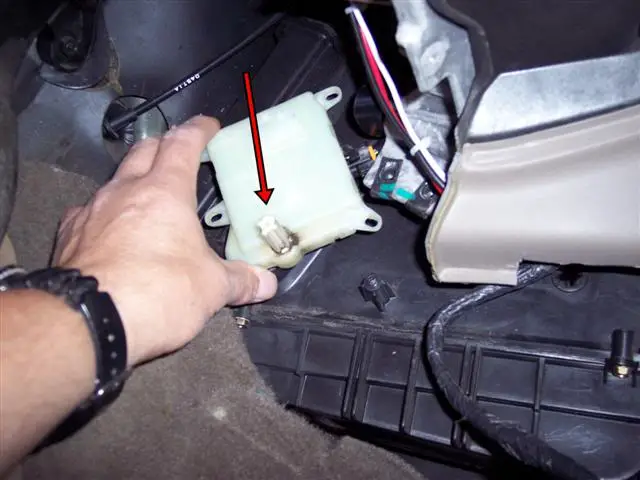

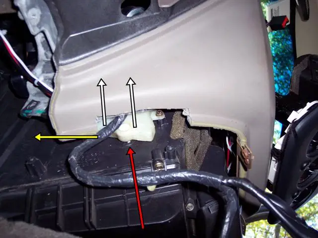

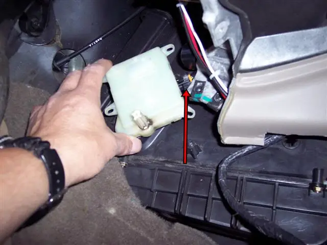

6.n. Wiggle out the blend door actuator - Red arrow indicates shaft - White arrows indicate direction to pull first: away from heater box - Yellow arrow indicates direction to wiggle Blend Door Actuator out

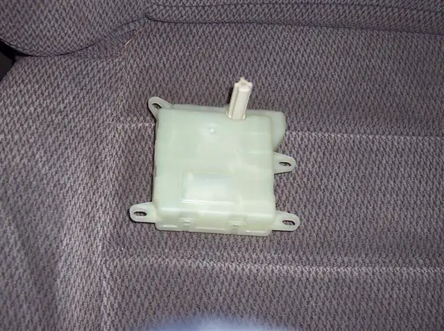

6.o. Turn actuator so shaft it facing upward

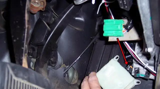

6.p. Disconnect blend door actuator - Arrow indicates tab to be press to release connector
7. Install New Blend Door Actuator
7.a. Connect actuator

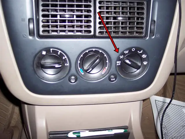

7.b. Turn ignition key to run position

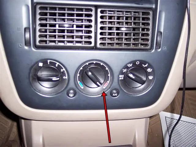

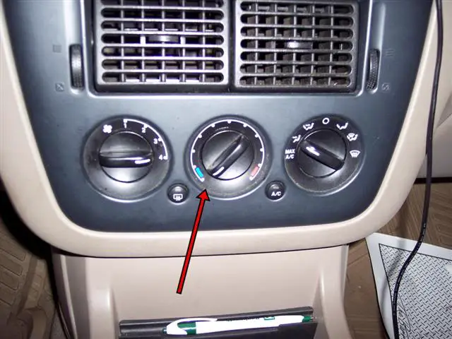

7.c. Rotate temp selector from cold to hot to verify operation of actuator – shaft should be moving
7.d. Rotate temp from hot to cold setting – shaft should be moving – leave temp set to cold
7.e. Wait for shaft to stop moving! Then turn ignition key to off and remove key - LEAVE TEMP SET TO COLD
7.f. Wiggle actuator into position – this takes some patience – be careful not to damage shaft - Shaft is keyed and will only go in one way - DO NOT FORCE SHAFT - Red arrows indicate direction to wiggle in Blend Door Actuator - White arrow indicates where shaft is inserted

8.a. Start vehicle and let it reach normal operating temp
8.b. Set selector to vent (engine must be running since this operates on vacuum)
8.c. Temp setting should be on cold
8.d. Turn fan on
8.e. Test temp of airflow – it should be cold
8.f. Rotate temp setting all the way to hot
8.g. Test temp of airflow – it should be hot
