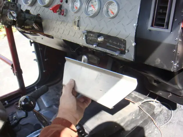

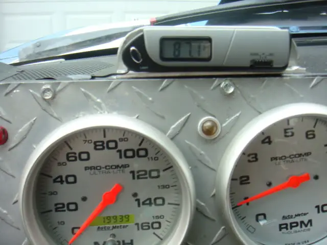

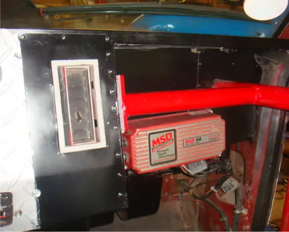

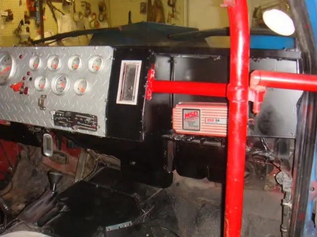

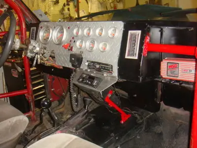

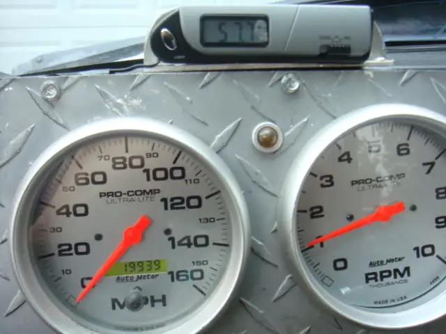

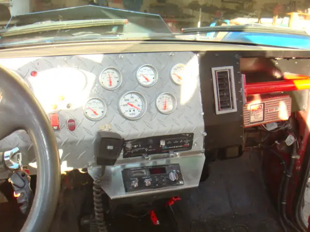

So this is not any major mod by any standards, but while doing the dash I inadvertently cut the wire to my Clock/Outside/Inside temp gauge.
Hey it was only $10, but I used it all the time ha ha.
So a trip to Walmart and picked up another one.
Mounted it on the same 3/16" aluminum plate, but this time mounted it on top of dash for easier viewing and hitting the light button mounted on the side.
Notice it says 57.7 F outside.
And a toasty 87.7 inside. This truck just gets so warm. The only complaint I had was the little spot on the bottom left of windshield that had a hard time defrosting when it was really cold coupled by a wet snow.
But the miniature Hood scoop should solve that problem.
Just in case your wondering why the Tach is reading 1100 RPMs, it's because you're right, the truck is idling.

Something good came out of all that redoing of the dash.
There was always a slight vibration or bounce in the Vac gauge.
Which I thought was due to the more aggresive cam grind that I installed.
While truck was ideling and the dash was partialy out, I noticed the vacuum needle stopped vibrating and was rock solid. Hmmm. Well I moved the dash and it started vibrating again, another hmmm.
So I reached in and found the vacuum line and started to feel along the line to see if I could find a small leak, the whole time watching the gauge.
Nothing untill I grasped the nut that tightens the line to the back of the gauge....Bingo! Just tighten the nut a quarter turn and rock steady.
So I thought a little vid of the Vac gauge and some others may be interesting
But the main thing is the steadiness of the Vac gauge and tach.
Which is a good indication of what's going on inside the engine.
I may have skimped on a few things during this build, but not the gauges.
The Speedo alone was around $400.
Would like to point out that I just came from driving 15 miles and just parked in front of my garage, so all temps are standard operating temps.
Oil press. around 50+. Could have gotten a higher pressure oil pump when I built this engine, but do not like pumping too much oil up to the rockers, rather keep it low in the sump.
The oil temp which is not in the vid is a little higher then Water, which is standard.
Water Temp. around 170 which is average for this engine with a 180 T-stat.
A cool 140 temp tranny fluid measured at the tranny.

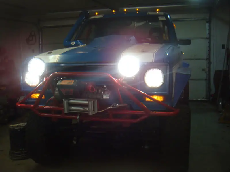

13 Volts with the lights and heater motor running. The heater motor draws the most volts of anything in the truck including the Hella 1000 headlights.

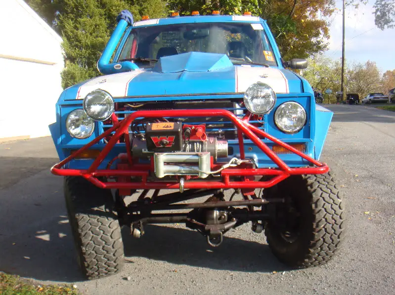

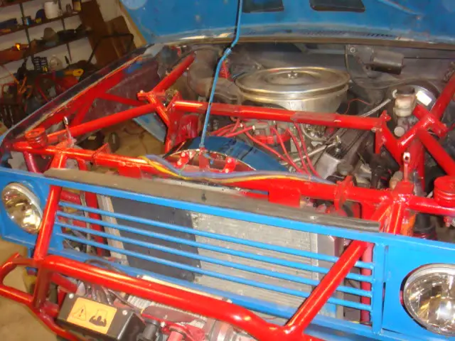

The way that I did the bottom engine brace by removing it and installing the tubed engine crossover really shows off the Dana 44 front with the links.
Have plenty of trail shots but none on the highway.
Plus I personally would like to see what it looks like also LOL.
Just need to find someone to stand there and film it while looking silly haha.
