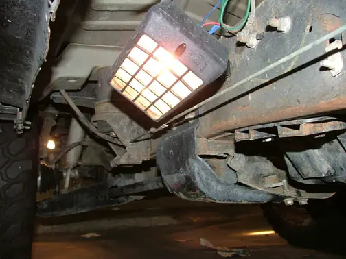

Ok I went out and took some pics.
Mine are monted on the frame. The wires arn't pretty but it works. :rolleyes:
Driver.
I used the body ground as a gound for the lights. This way only 1 wire goes into the cab, and piggybacks in to a wire going to the rear rock light.
Passenger.
The wires from this light goes over to the drivers one over the the trans.
Hope this helps :rolleyes:
awesome thanks, did you just drill all the way through both sides of the frame?
i was thinking of mounting mine (much smaller, but same bulb) on that little ridge thingy on the bottom of the body (second pic right above the light, and then just drill another hole in that ridge and attach the ground to it. That seems like it would be alot easier to drill than the frame.

Drilled no holes! Hole was already in the frame from the factory ;)
how the crap did you get a nut inside your frame rail to the other end of the bolts...
and sorry, i HATE to ask you for another pic, but when you get a chance can i see a picture of where you grounded your lights? if you dont want to, thats cool i can figure something out
I thought you mite ask, so I already had a picture ready.
In the circle you can see a factory ground wire (silver cable) going up to the body. I just tagged on to that bolt.
as far as the nut on the bolt, just stick your hand up there. It's all about feeling
ah, ok...that makes it easier. Thanks a ton, i will try this out in the morning and if i run into trouble, you will be hearing from me ;)
