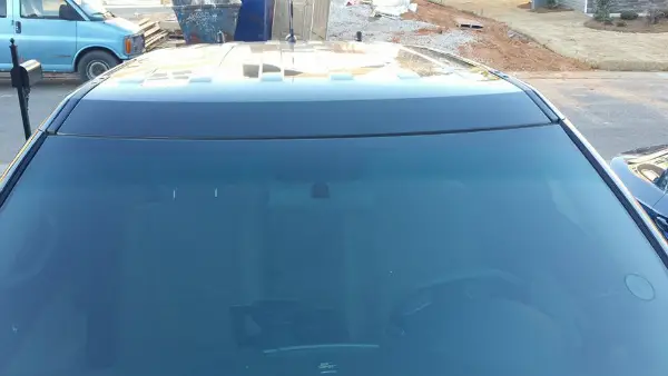

If you foresee having problems using the Velcro because of it's questionable adhesion to the body, you could try removing the adhesive portion off the back of the Velcro... say with Goo Gone, for example. Then use 3M auto tape to secure the Velcro to the body. Since most of us have had good experiences with 3M auto double-sided tape, maybe this could work, without relying on the Velcro's own adhesive.
I'm going to try it this way. 3M auto tape is a very good product, but is too expensive for 32ft (8 ft x 4 left/right/top/bottom), and will also be too thick (want to keep the soft rail as close to the body as possible- and the velcro already adds thickness). So instead, I'm trying to find the best glue to permanently adhere one side of the velcro to the body (or rather to the rubber-like substance that's between the original rails and the body paint). The other side of the velcro will be permanently glued to the soft rail.
The only thing then is ensuring the 2 sides of the velcro don't come apart under driving conditions. Not sure how this can be accomplished- still playing with the idea of drilling 2 bolts through the rail (one in front and one in back). Also, I'd like to tie the original front rail piece in with the soft rail somehow if possible.
I'll be taking on the this project in a couple days, so right now all I need is to figure out what glue would be best. I has to be very strong, work well with velcro (vinyl?) to a rubber / metal surface, easily spreadable, and dry fairly quickly (within a few hours ideally). Anyone have any recommendations? Here's a few I've been looking at (I've never worked with any of these):
