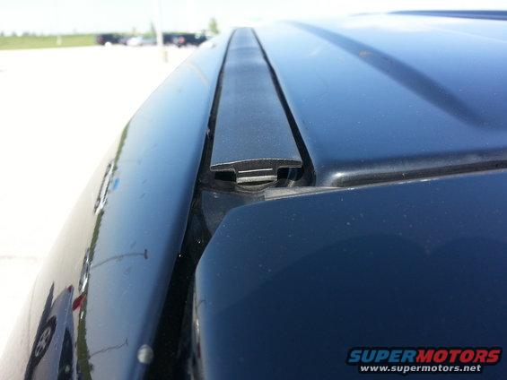

Finally did this. Ordered all the parts prior....in reality, all you need are the gutter moldings from the windshield and some hardware.

The metal washer is not much lager then the button head, looks pretty good, and I have had no water penetration.

As my Explorer is tri-coat white, I do not want to run black moulding down the gutter.
I will be painting all the lower plastic and will paint the roof mouldings too.
Maybe this winter if I'm not so busy, I want to make an actual filler strip front to rear in sheet metal (box tube that will fill the gutter flush) and paint body color. One piece that can bolt down.
As a side note, when removing the rails, do not try to separate the moulding from the pedestal. Take it off as a unit, remove the rubber gasket, the you turn the moulding 90 degrees to remove it. Trying to pry them apart on the vehicle, will result in a broken clip.
