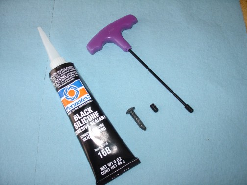

the rack on my 99 ltd started peeling so until I repaint it, I pulled it. it was easy, 10 philips head scews no drama, went to home depot and bought some set scews put some rtv on them and filled the holes, the oem screw stuck up. I might paint the inserts, but prolly won't bother. weird though, my 99 eb had torx screws instead of philips head. I left it on, it does not have the spoiler like the ltd so it won't look right.

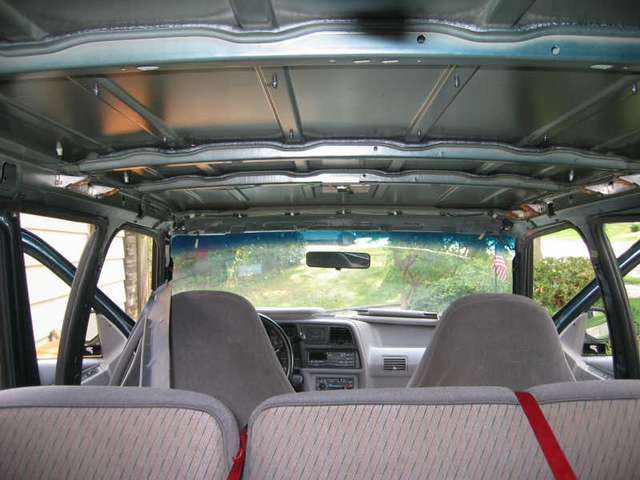

Ask and you shall recieve. In the pic below you can easily see the fasteners used to secure the rails and center ribs. If you're going to do it right you'll need to remove the headliner, remove the side rails and drill out the rivots holding the ribs in place. You'll will then need to weld patches for all the holes, smooth with body filler etc etc.. (this would be MONMIX's area of expertise)

replace the screws with headless ones , set screws, then they don't stick up. I'm going to paint the inserts next.

they are black, come 2 to a package, i got the 6mm x12mm but any length will work, cant paint tonight, to humid. nice part is if you screw it up you can still just stick the rack back on.

I already put them in with RTV, but just imagine your stock screw with the head cut off and a hex hole in the top of the shaft. they are in the drawers at home depot, just ask for the set screws, thier black and metric, 6mm and you cen get lengths of 3mm to 12mm I think. Mine are 6mm x 12mm. DO NOT GET THE SAE SIZE. they are the wrong pitch and wont go in.` thier silver not black. i have a pic of them installed if anyone needs one,
I went to Home Depot this morning and got the set screws, removed the existing screws and installed the set screws; looks much better.

hah you even have the same crappy harbor freight T handle I have. I might fill the rest of the holes in with clear silicon so water does not pool.
