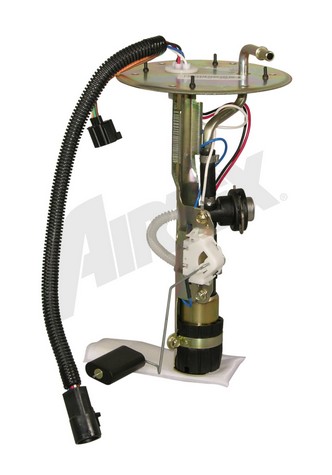

I just read another post & they described the black & silver valve on the fuel pump assembly a fuel damper or resonator. I removed my fuel pump assembly & found that it was leaking past the connections between the pump & the fuel pressure regulator in the tank. It was only building up to about 42 lbs pressure. After replacing the hoses & new clamps it would make 55 lbs. I thought I had my problem solved, but it appears that I should be pumping 65 psi. I used my air compressor to blow back into the tank & it seems like I can build up to about 75 psi before it bypasses the fuel pressure regulator. Is it possible to purchase the pump only as it appear that the fuel pressure regulator is fine? Thanks. Will my pressure increae if I run it off the truck system? I just tested it with an old 12 v battery sitting on the floor. Maybe my pressure will bew at the required 65 psi with the charging system putting out the full volts.
Calvin
The fuel damper is mounted on the fuel rail...
Not in the tank...The black and silver unit in the tank is the fuel pressure regulator which vents back into the tank...Look at the picture below for the black and silver unit on the tank mounted pump assembly...55 psi is on the low side of the requirements of the fuel pressure for the engine to run properly...If you run a pump without a regulator[as I have done], I can't tell you what the pressure will be... It will be sufficient to run the engine as I have plumbed in a seperate pump into the fuel line to move the truck from a remote area to my driveway so I can work on it...
As far as a pump is concerned, I replaced the Ford pump long ago with a Walbro unit...When I replaced the tank thanks to excessive rust the pump in the tank has lasted quite a while...I did have to replace the pump once after 3 months but that was a fluke problem with the pump and got it replaced and it has worked perfectly ever since...
