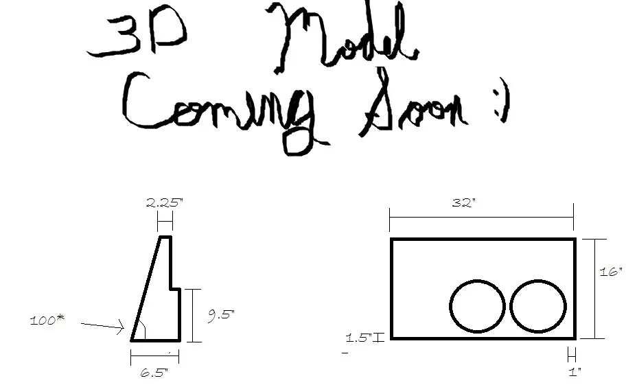

HUGE BUMP!!!!!!!!!!!!!
3D Model will come when I finish moving out of my dorm and after finals! Install pics maybe sunday? Or whenever I can get it installed

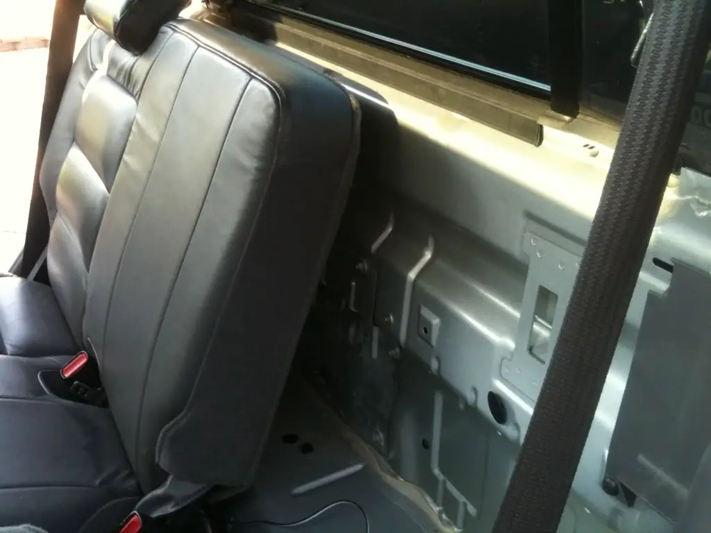

Ok well I washed my truck today (1st time since jan.) and found enough time to pop my box in finally!
Here is the rear with the proper panels stripped out. Basically the cargo lid panel, the thick black plastic hinge mount for those useless door things, and the carpet that's back there.

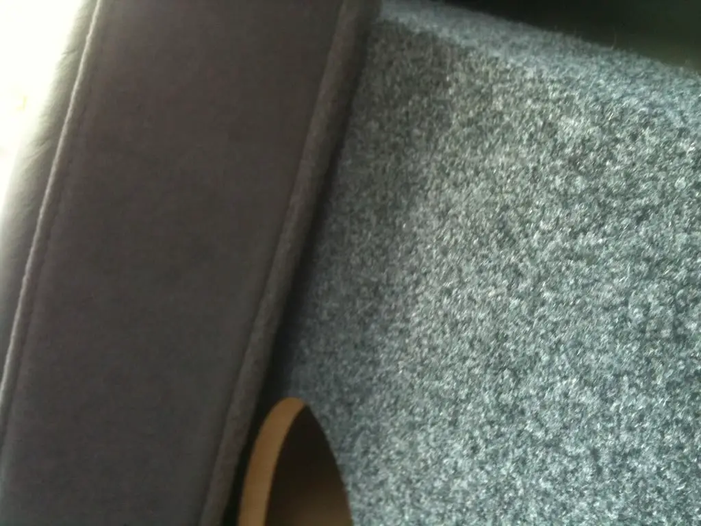

Here is the box in there...
It's a really really really tight fit. I'm planning on going and trimming a little more off the remaining paneling just to be safe but I'm almost sure it won't help... The seats snap back just fine, but there is a little bit of preload when u fold them open.
I'm hoping that these shallow mount subs will fit now... Not much room in there. I really hope I don't need to take a router to those and make a recessed collar or something to get them to fit...
