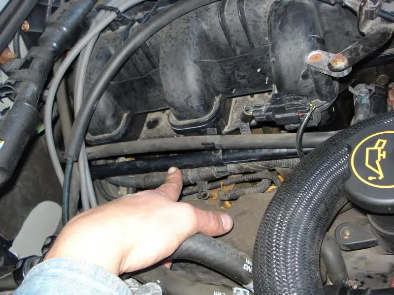

this first pic is from my brothers 2001 Explorer Sport 4.0 SOHC Using the vaccuum line for the IAC Valve:

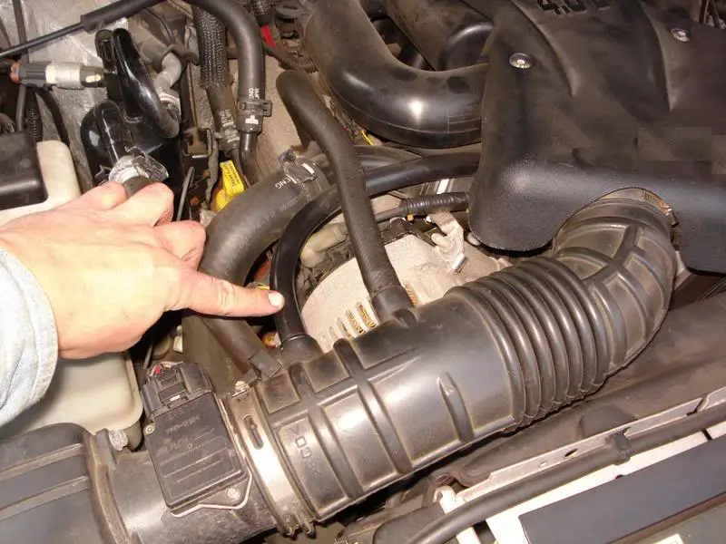

these pics are from my 2002 ford ranger 4.0 SOHC.
1)first find the PCV Valve
here is where the PCV valve is

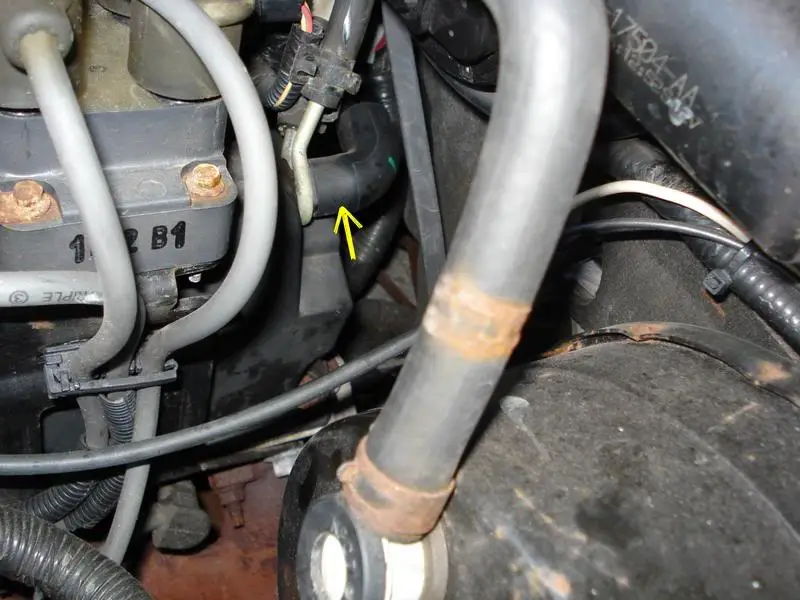

2) follow this hard plastic vaccuum hose from the PCV valve to the inlet right under the Throttle body

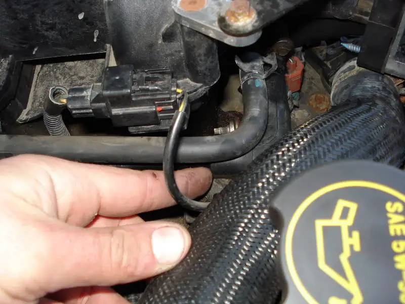

3) use this 90* rubber eblow and rotate it upward so you can insert a funnel.
