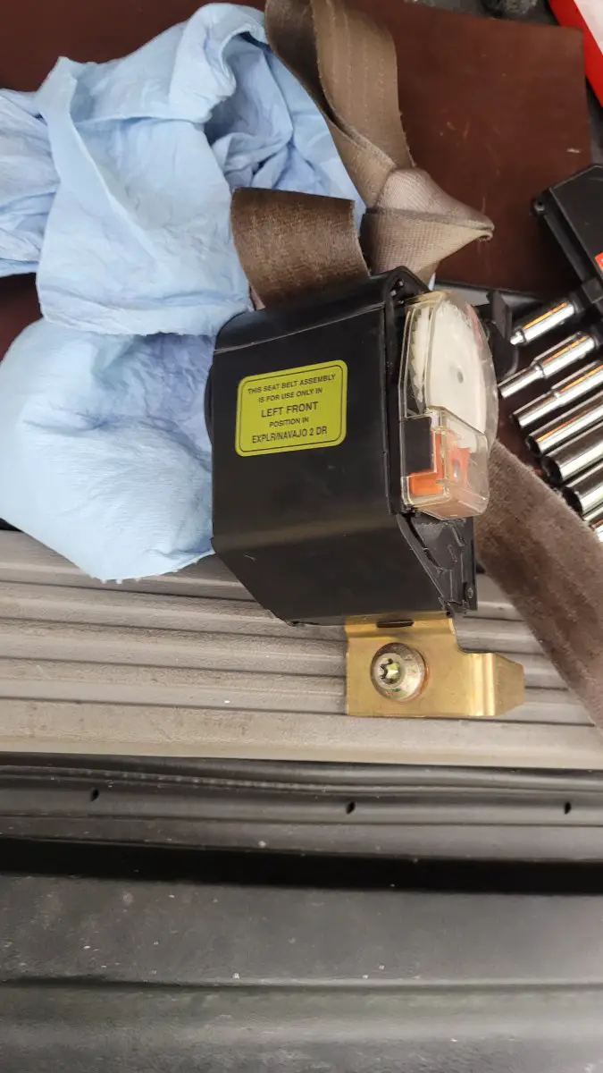

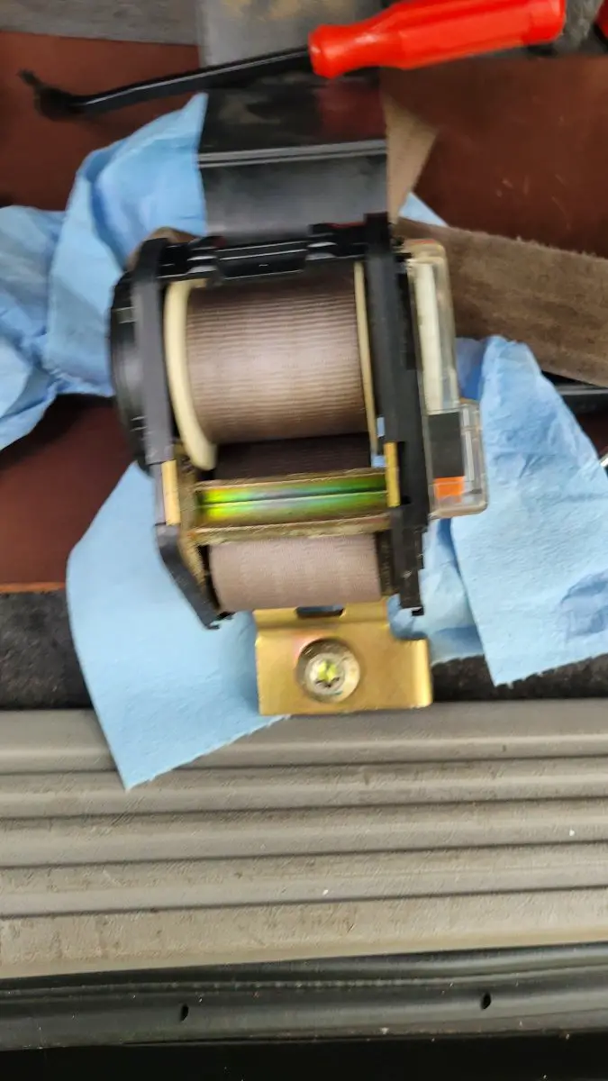

He all. I went ahead and swapped my belt out for the one I got from the 01 Ranger. I took some pics of the stock seat belt in case someone down the road comes across my same issue. I'll probably send the stock one off the group on eBay to get repaired. Thanks to everyone that replied to this thread, the info was very helpful.
Now seeing it looks like it's plastic holding that spring, I could probably drill a little hole and put some lube in to help mine in winter. I guess I could do that with metal as well, just didn't ever prioritize doing it.
