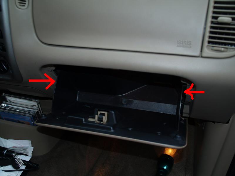

1. To start simply open and empty out the glove box. Once empty push in on the sides of the glove box, as shown in the photo, and drop it down.

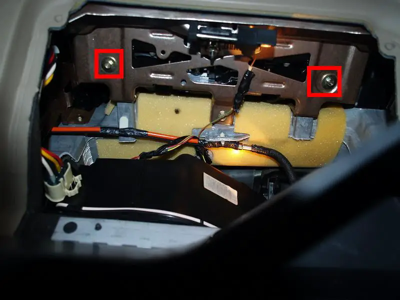

2. This image shows up into the dash from the floor and displays the 2 screws holding in the passengers air-bag. Removing these 2 screws allows you to remove the air-bag.

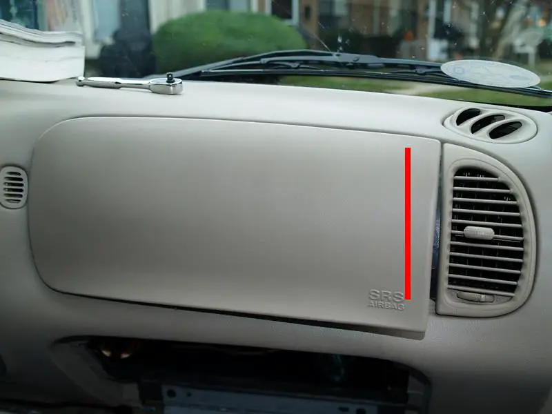

3. I found that the airbag wanted to pull out from the right side first as shown in the image with the red line. Once this side pulled free the whole unit pulled straight out.

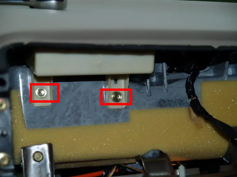

4. Here are the 2 screws securing the RAP (Remote Anti-theft Personality module)! This is of course what we are looking for. The 5-digit code is located on the top. Remove the 2 screws and pull the module out.

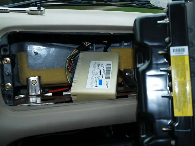

5. The module will pull out and swing towards the passenger door due to the wires.

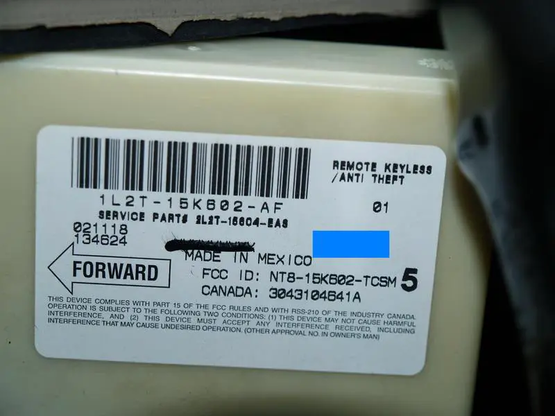

6. Finally you'll notice the 5-digit code! Write it down, take a picture, tell your wife/husband and then help everyone else out by telling them where you found it!
Note: For security reasons I've hidden my code however it was located in Thick Black Bold Text where you see the blue block in this image.
