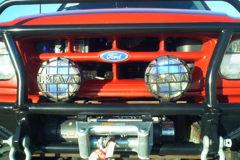

Well today was about 75 degrees outside and she started heating up again with the new t-stat, fan clutch, and cap. What else could it be? Do I have too much stuff blocking my air flow?
The problem is your radiator. I don't care how many times you have flushed it, it is plugged. Remove it and take it to a radiator shop and have them clean it or just replace it.
