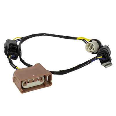

Yes, you may just install new lights. There is a decommissioning kit for vehicles equipped with the headlight lighting options which a Ford dealer may be able to order for you. It's a small pigtail that plugs-in to the strobe/turn wiring harness and has a regular bulb socket to replace the Whelen strobe/turn bulb & controller assembly. I removed the Whelens in my PIU, saving them in case I want to use the strobe functionality in the future, and used those to install cheap aftermarket LED turn/DRL bulbs.
The part numbers are 2U5A-13411-GB for the socket, and 33471-0301-11125 is the part number for the Molex MX150 connector on the harness end of the pigtail, there's no actual Ford part number.
