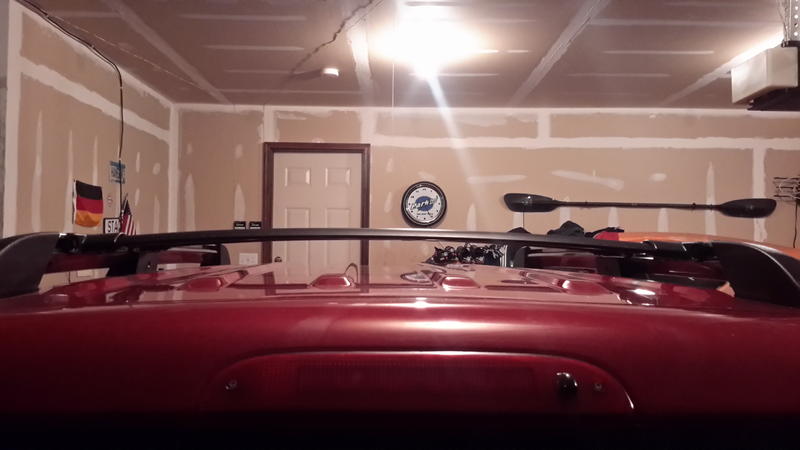

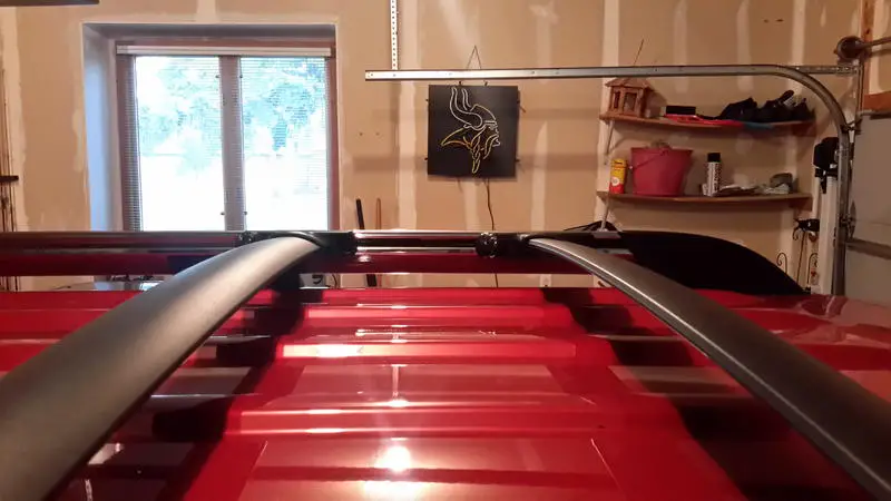

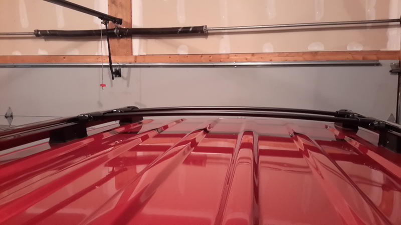

If you look at your first picture (which shows your cross bars from the side of the truck), you will notice that they are slanted down towards the right side. This is not looking at the bar from side to side but front to back. It is not level, but slanted down - towards the back of the truck. When you attach a kayak rack to that bar it is tilted towards the back. Since it is not level it doesn't hold the kayak as well.
On my previous '04 Explorer, from front to back on the bar itself, it was level.
I may end up going with the aftermarket approach, but it is going to cost me around $250 to do what the factory cross bars should have done themselves.
I am not sure if the cross bars from the earlier years of this generation fit on the 2010.
Let me know if anyone has any idea on the reason for this design.
I have the exact same rack on my 2010 Eddie Bauer. I have Thule J style brackets and it holds the kayaks just fine. Almost all factory installed rack crossbars have a slight aerodynamic angle of attack for reduced wind noise and vibration.
If you decide to sell your stock crossbars lmk as I don't have them and would like some. ;)
