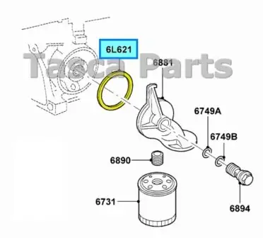

The past 2 oil changes I've been noticing oil around the area from, what officially called, the Oil Filter Adapter. Now I'm getting drips of oil on the floor - time to fix!
To clarify in layman's terms, it's where you install the oil filter ;-)
I've GOOGLE'd the problem, and read a number of threads that have to deal with this engine in Aerostars, Rangers and Ex's. There's a pretty good thread at the following link that answers a lot of my questions regarding the (3) O-Rings that need to be replaced - so I've got that part of the repair answered.
Link: 95 4.0 oil leak - Ford Truck Enthusiasts Forums
Towards the end of the thread listed ABOVE, specifically on Page 2 - a thread poster named "Somerowl" (from his Forum Pic has a Gen 2 Explorer Sport) stated that he needed to remove the passenger side exhaust manifold due to clearance issues of removing the Oil Filter Adapter Bolt.
Apparently the reason is due to there only being approximately 1/3" clearance between the Oil Filter Adapter Bolt Head and the Exhaust Manifold. I'm imagining that is not enough clearance to fully unscrew the Oil Filter Adapter bolt necessary to remove the Adapter / Mount. I'm also imagining this tight clearance is why, over 19 years, the two O-Rings that are on the Oil Filter Adapter Bolt "cook" and shrink causing the leak. Simple radiant heat transfer...
Anyways, I guess my question in all this is - is his experience of the Exhaust Manifold being removed to get the Oil Filter Adapter Bolt out / removed the case???
I know that 99.9% this is more than likely the case, but figured I'd confirm it anyway. Holding out hope ;-)
The Passenger Side is the "tight side" of the engine due to all the the A/C Evaporator and Accumulator Equipment. The job looks like a combination of "bottom" and "through the wheel well" work. A lot of mess due to the removal off all the old accumulated oil and dirt.
Thanks in advance -
P.S. Ordered Adapter Bolt O-Ring, Adapter Mount O-Ring & Exhaust Manifold Gasket(s) through Rock Auto, and for the GREEN color E9TZ-6749-A O-Ring through a Ford Dealership on Ebay for approximately $3.75 Delivered. That GREEN O-Ring is VERY HARD to get reasonably priced - and no aftermarket source as far as I can see...
