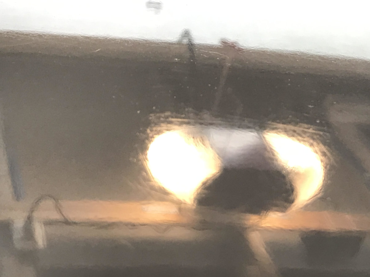

I wouldn't wet-sand the clear-coat on a brand new production vehicle! There's not enough material to work with there. On custom paint jobs they put down at least 3 coats of clear (sometimes more) just to be able to perfect the finish by sanding and buffing away the orange peel.

Thanks! also, I got some 2k clear for later in the summer to respray, as it was pretty thin...
Mask well (the vehicle and everything in the same space as the vehicle) as that **** floats and ends up EVERYWHERE
