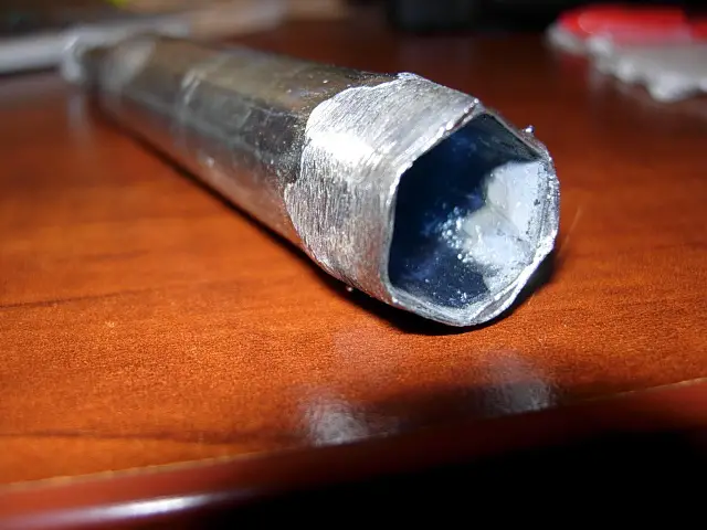

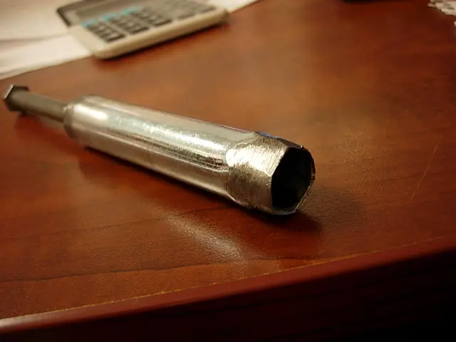

I finally got that sucker!!!!!!!! :thumbsup: The modified cheapo, homelite spark plug wrench was the ticket.......took me 5 minutes to get it out. Didn't even really realize I had it till I pulled it up & out. Didn't see anything on the plug so I taped a small piece of tubing to my shop vac and sucked out for 5 minutes or so.......I think I heard some "stuff" go through the hose! Creepy........but the truck runs GREAT!!!!!!!
Anyway, just got the 2 hard ones left which I figure I will leave for the weekend and some daylight!!
Thanks to all!!!!!!!!!!!!!!!!!
Here is a picture of the beast that beat the plug!!!
This is now an official pass around tool should anyone have a need for it. Just ask and I will send it assuming you will send it back when you are done.....or send it to the next person that needs it.
I know this is probably silly but it cost me $7 plus 30 minutes to modify it and it would be cheaper and easier to ship it than buy/make it again for someone else.
