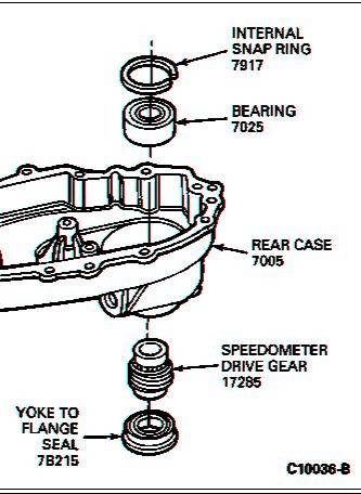

Okay so I finally pulled the drive shaft off today and used speedo hole to push the drive gear out the back of the t-case but the drive gear seems fine the nylon is not worn down at all. I found out the drive gear is magnetically driven. the inside of the gear is smooth (no notches that are supposed to mesh with other notches). So now I am really confused and disappointed that I have not found my problem. Is it possible that I just need to replace the magnet in the t-case?

Where did you find out the gear is magnetically driven? I don't believe that is true. I think vss started on the 1995 Ex.
I think it is magnetically driven because it is smooth on the inside as is the shaft it goes on. Also the shaft the gear slides on is magnetic my tools stick to it. I don't see how else it would work since the gear just slides on nothing holds it in place on the shaft. It just spins freely. You are right BW1354 sorry typo.

The part that has a built in magnet is a different type of sensor. It uses the Hall Effect to provide a variable signal from the collapsing & expanding magnetic field just like ABS & ignition distributor sensors.
Look inside the transfer case to see if it has a plastic worm gear or a steel ring gear. It should have a worm gear like the photo in post # 5. The smooth sensor is usually at the top of a diffferential, and not in a transfer case. Maybe your transfer case has the wrong sensor?
It looks exactly the same as the picture in post #5 . It has a steel ring gear with nylon on the outside. I thought the worm gear was the gear that clipped onto the end of the vss that meshes in with the steel/nylon drive gear.

Yeah I have read about that. So the gear on the vss is just the driven gear and the drive gear is also called the worm gear?
