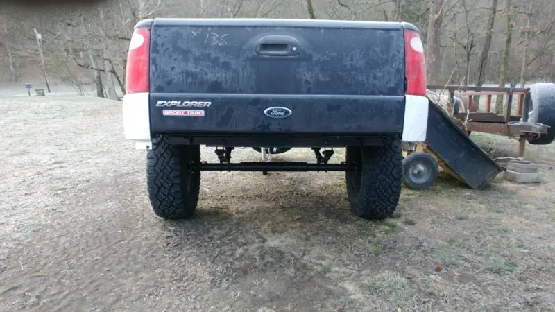

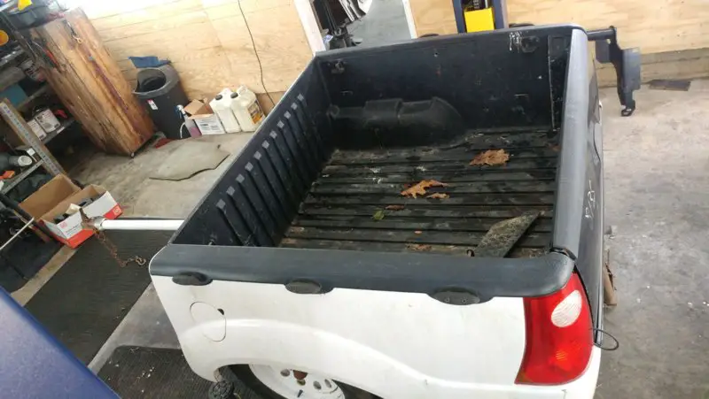

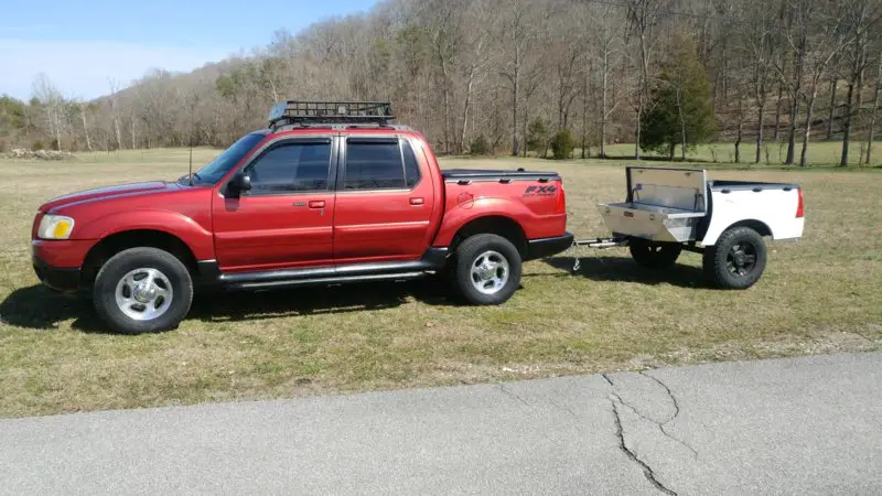

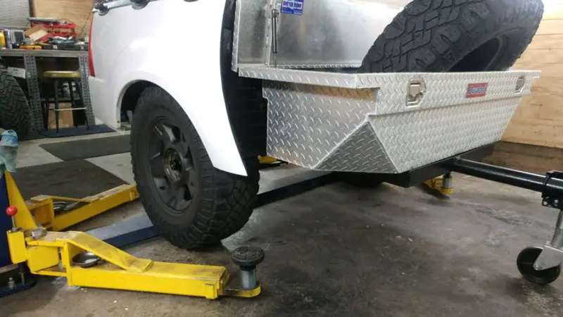

I have been working on a winter project. Back story is I ended up with a complete ST bed a few years ago. Almost sold part of it to Koda a few years back for his ST. I had several different ideas for it but finally decided to build a trailer. I found a old trailer on CL, friend gave me a tool box, traded for an axle and bought some new items. I had some ST wheels and got 3 Good Year 265/75/16's off CL. Don't have much in it as I am sure it is not worth much, but it has been a fun project. Not fully done yet but getting close. Still want to paint it, add a spare tire underneath and a few other things. The first picture is before assembly with the little axle and tires. Second picture is with bigger axle and tires. Third is after I flipped the axle to get more clearance for the tires. Then behind the ST, with my smaller street tires. I will update as changes happen, now that the grass is growing it will get less time.

Sorry for the long delay, I finally got around to painting the bed. I used truck bed spray coating and the ACE semi gloss paint over it. Got the spare tire mounted, lights working, a little rear bumper and a few other things. I have actually pulled it down the road and it does well except it's a little bouncy because it's empty. Any ideas anyone has for more features please share them.
"I have actually pulled it down the road and it does well except it's a little bouncy because it's empty. "
Have you considered installing some shock absorbers? I don't see any in the pics from the rear.
I have not but that might help. I will see how it does with some weight in it.
You'll probably need to put considerable weight in the toolbox or some other counterweight in the front for the best ride. The ST bed dictates most of the weight will be over or behind the axle. I didn't pick up on that when you posted the 1st pics.
