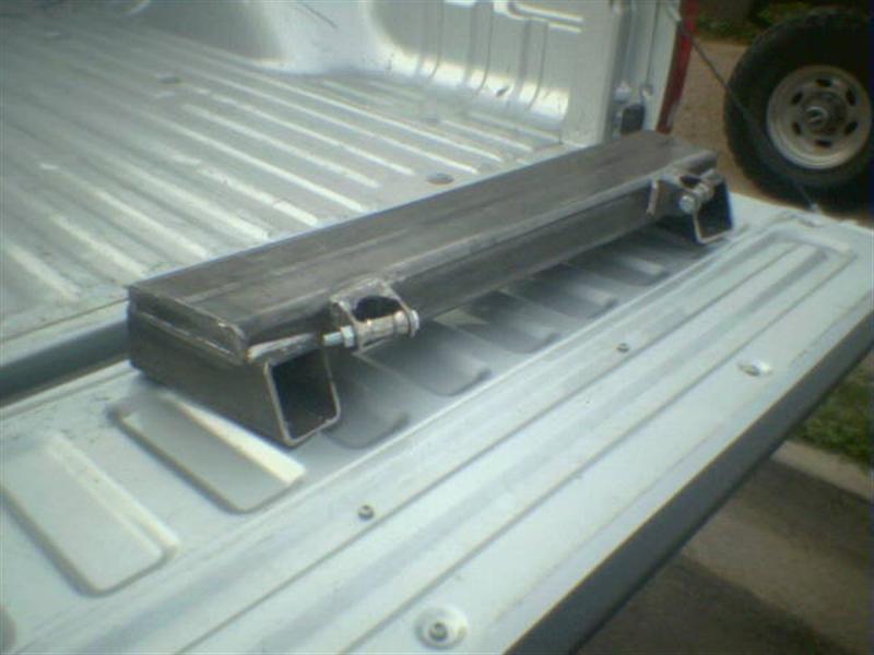

If you are going to run coil overs I suggest a 3 or 4 link setup on the front axle. I extened the stock radius arms on mine about 12" with a piece of solid stainless tubing plug welded and then used heims and a custom crossmember. Here are some pics. I am considering redoing my SAS on my other explorer and would add a 4-link very similar to Jefe. Search his name if you want to know the textbook way of doing a coilover SAS.
Here's some pics of my junk to tide you over in the meantime.
Dan
