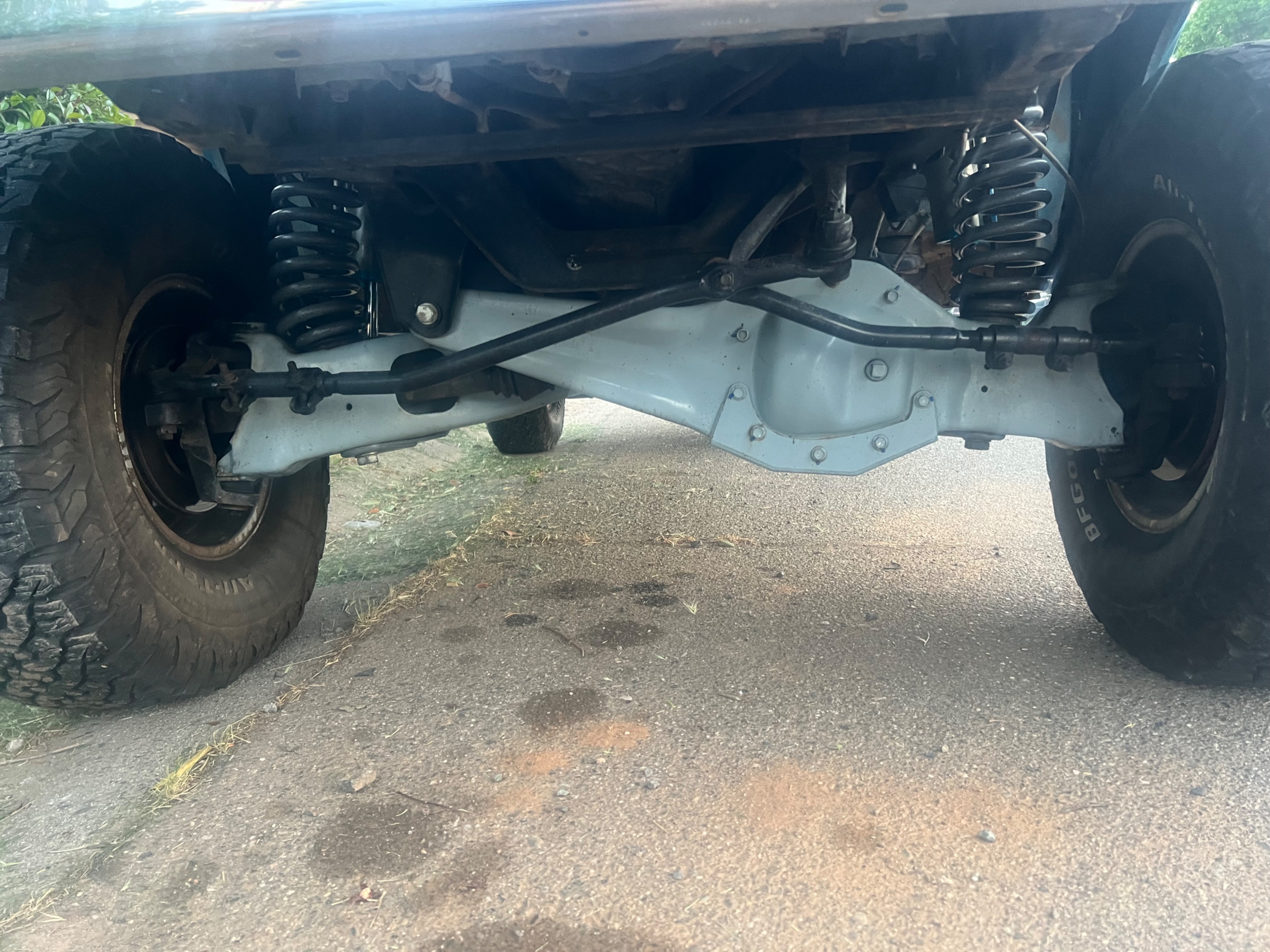

I just swapped out my 4” skyjacker springs for some 4” tuff country springs because I didn’t know if the skyjacker ones were sagging, I got this bow now in them think it will even out or what’s off it looks like the top coil is set correctly it has C&T beams so not much should of changed springs were about a inch taller next to the skyjacker so I’m thinking mine were sagging but now there’s a bow
It drives straight still going down the road I can see there’s a little camber but not sure if I should drive it to work and see if it settles or what
New springs need to settle
Tuff country not nearly the quality of skyjacker
Skyjacker coils do tend to run a little soft whereas superlift and tuff country are stiffer
Give them 100-200 miles and then plan to adjust your camber w shims
I run the “infinitely adjustable” camber shims from 0 degrees to 2.75 degree correction
I replaced my skyjacker coils after 15 years and I gained 1” of lift up front
