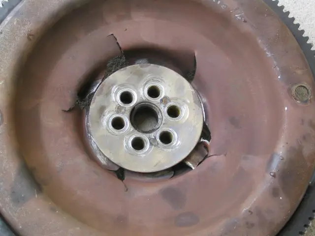

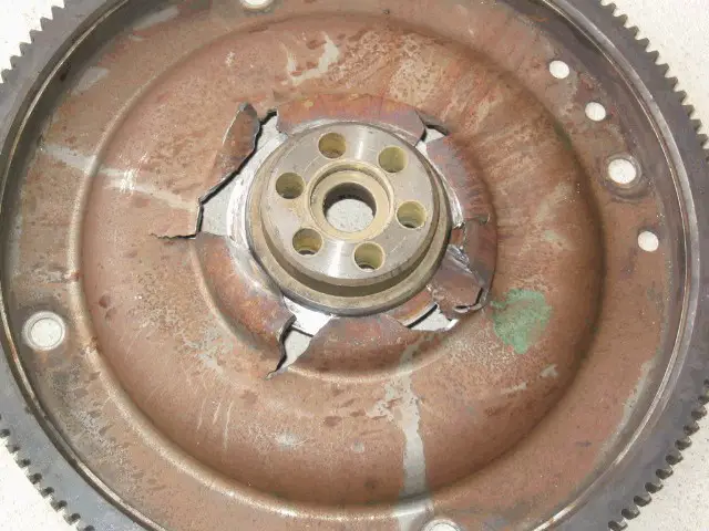

Also be sure to check your flexplate for cracks around the hub, the older trucks are prone to failure there can seem like a starter issue but it’s much worse

That’s the flexplate
They crack around the middle where it attaches to the engine
So with a flashlight look up in there really good while starter is out
You can find examples of cracked flexplate by searching
