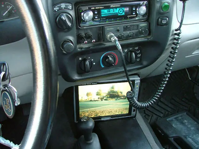

Got the screen in and mounted. Used some sheet metal to make it look nice. Here is how it turned out.
Screen shows Stic-cam on the bumper;)
hey looks pretty good, what kinda camera is it? how does it look at night? is it green like night vision? i heard some look like its daytime out on the camera when its really dark, i bet turns out to be very useful, hows the computer part coming along?
SWEET! You just solved my question of where to relocate my CB!:)
Damn you work quick!!! Looking good.
